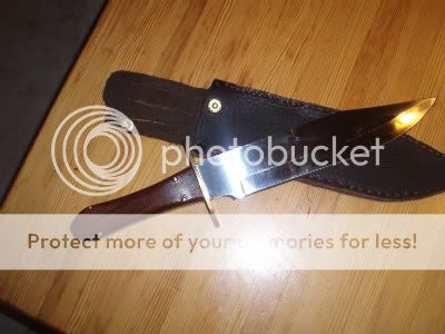

My name is Markus. I have recently found this forum. I am an outdoorsman but have lately started to making knives, first ones with bought blades, adding handles and making a sheat, but I have know gotten som stainless, acid restistant steel from a company that makes containers of some kind for the industri. It was labelled 1.xxxx I don´t remember the numbers. What do you think of that steel, is it useable. Should it be hardened? I don´t know very much about making blades, so any hints is appriciated. I also got a piece of steel that the company called blacksteel, not stainless, anyone can guess if that is any good for making knives?
When I have been reading in this forum I have seen that you guys don´t like knives from China. I know as little about knife industry as about knife making, can anyone tell me whats wrong with chinise knives?

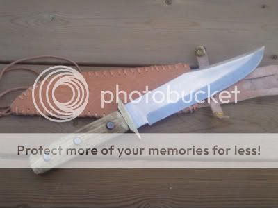

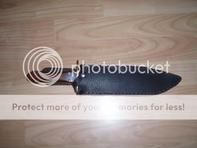

Here´s two that I made. The sheat on the first one is really ugly I think, I tried to decorate it by carving some patterns with an screwdriver. But the leather on the other one is really good looking, it´s fat treated leather, really thick and durable and good for a big knife sheat.
Those look nice. :thumbup:
First, welcome to the forums.
As far as the steel goes, you'll have to be more specific. Each steel has different characteristics and requires differences in heat treating. For that, we need to know the numbers. Keep in mind you can make a knife out of anything. So if you are unable to locate the number, that doesn't mean you don't end up with a decent knife, but without proper heat treatment, the edge will not be as sharp as it could be, nor will it hold an edge very long. So having an idea of what steel you got would be good. Maybe some other members can help you more on that.
