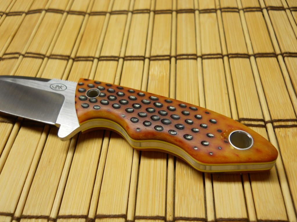

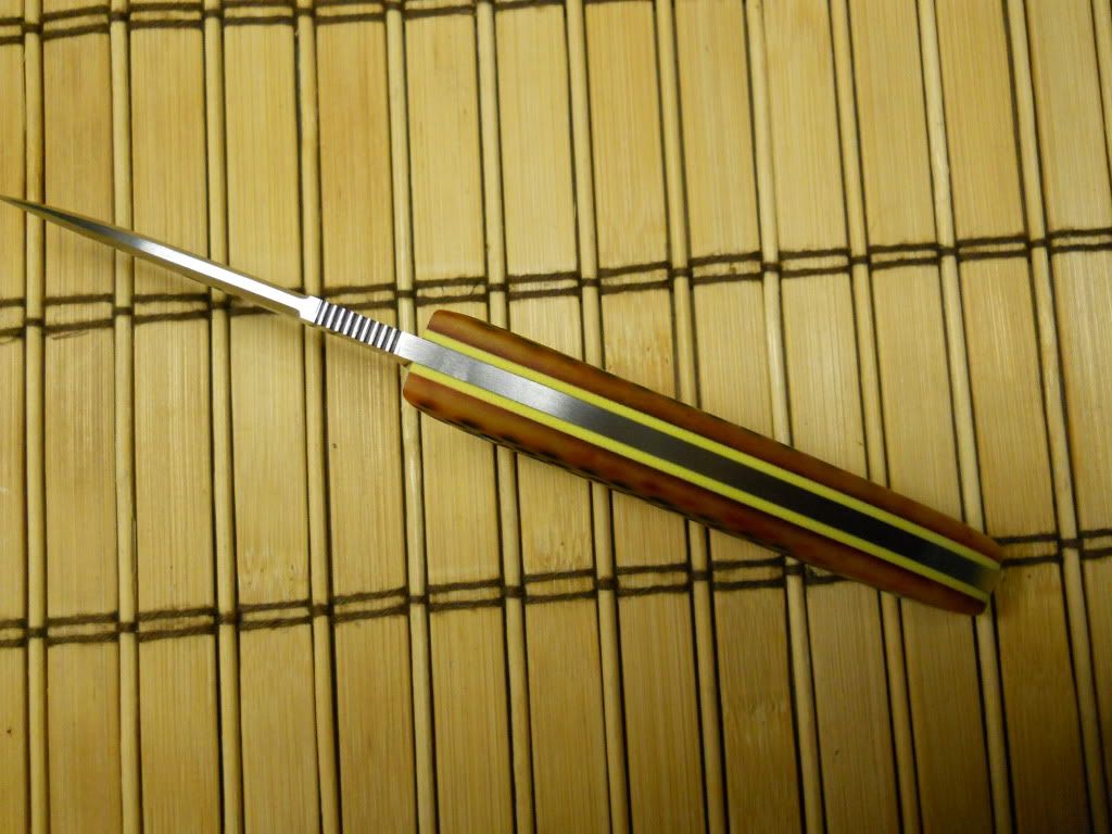

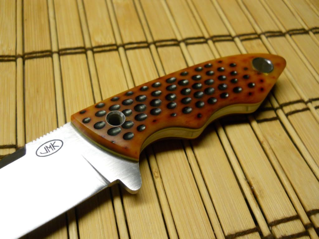

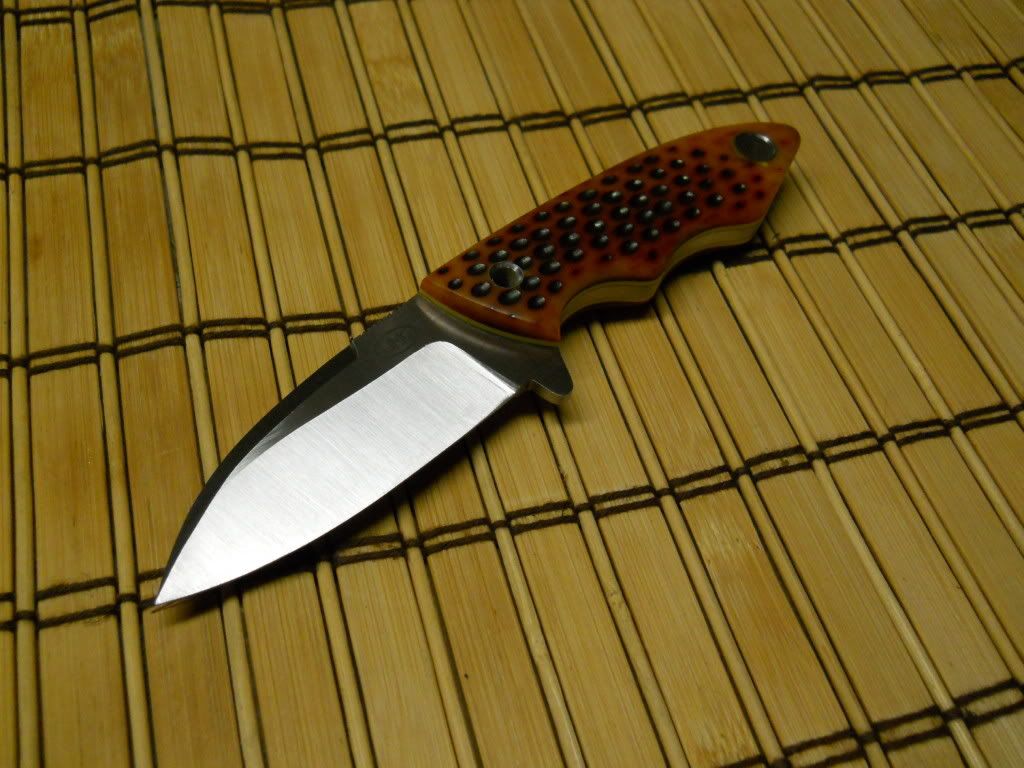

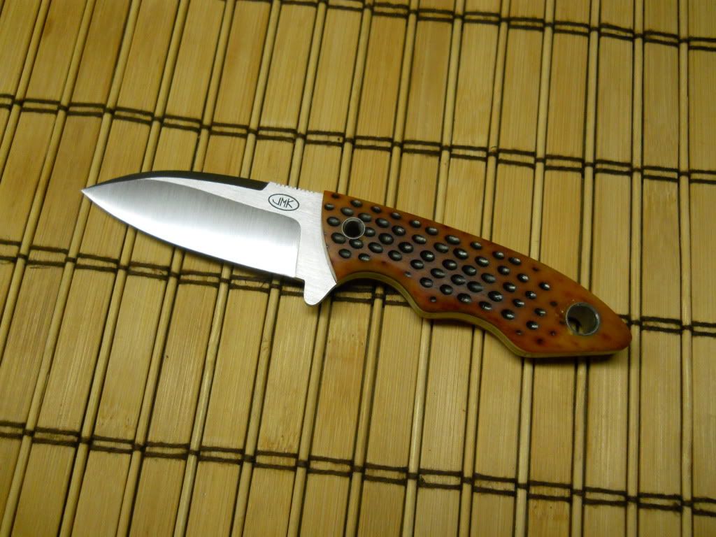

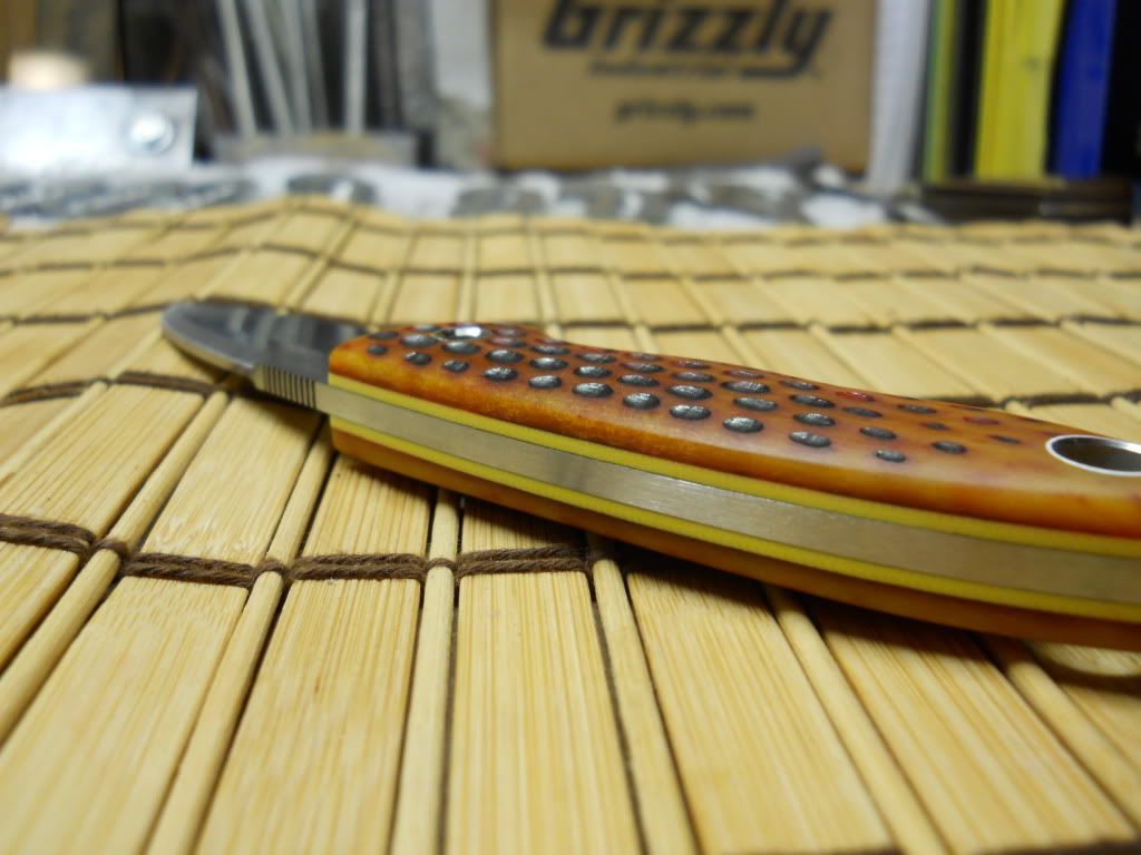

Here is a new model, my Mini Spear Point, coming in at just about 7 inches overall length. .145" thick CPM 154 with mahogany corncob jigged bone scales with thick yellow G-10 liners.
I definitely want to start using more bone. It's a bit pricier than synthetics, but has a real classic look to it.
This one still needs a sheath so the final edge hasn't been put on yet. I think I also need to do a bit of contour sanding on the finger guard, it looks a bit too flat and maybe the corners seem too sharp. What do you guys think?
Thanks for lookin'!
