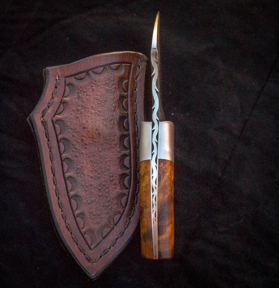

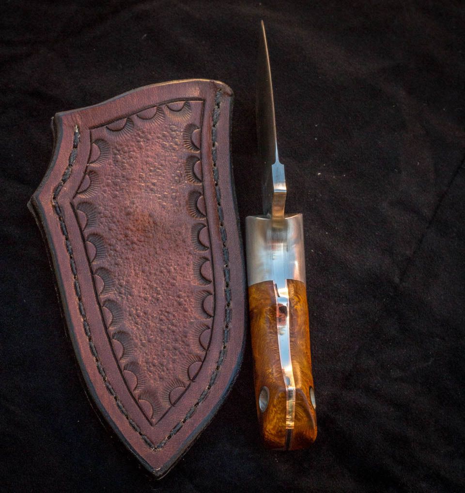

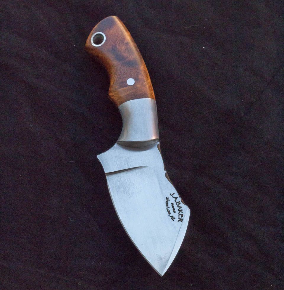

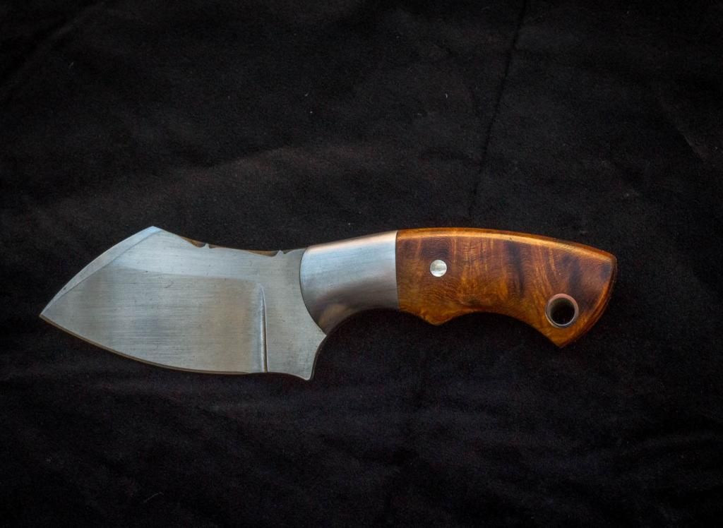

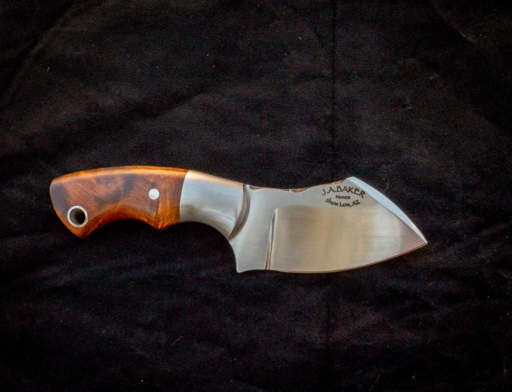

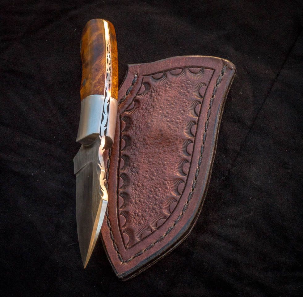

Here is a new model I have been working on. At only 4 3/8" long, it is intended for a small, fixed blade pocket/neck knife. This one was ordered with a tooled pocket sheath. Thanks for looking, Jeff
2" ATS34 blade, cryo hardened and triple tempered to 62RC
4 3/8" overall length
Stainless bolsters and pins
Figured ironwood scales and copper spacers
Vine patterned filework

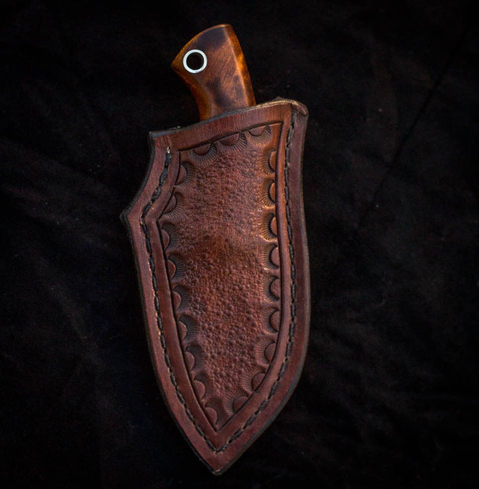

Tooled leather sheath
I really like that! May I ask how you get the texture in the middle of your sheath?
Thank you. This texture was made with a Tandy Leather stamp. I don't know the number off the top of my head, but can tell you tomorrow when I get in the shop. Jeff
