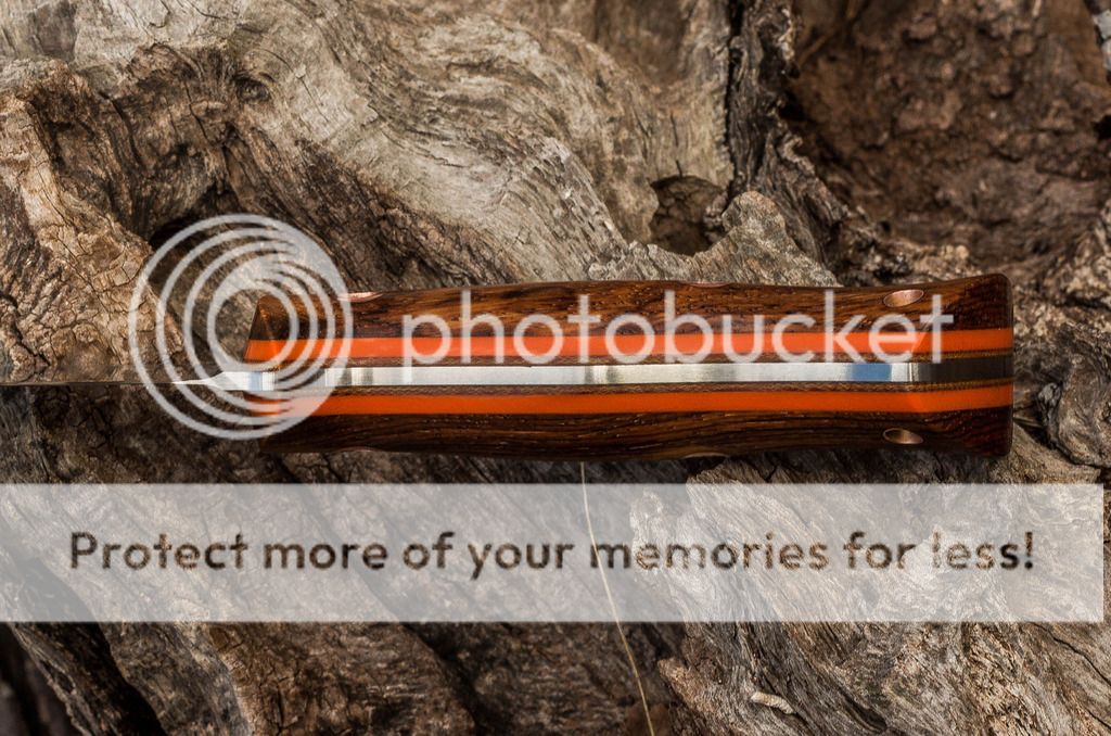

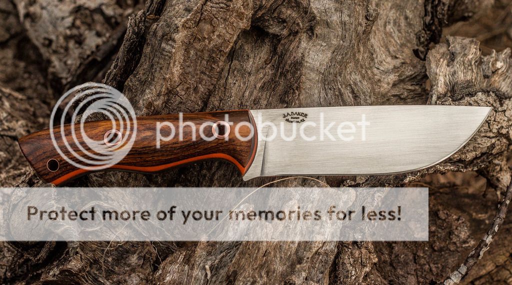

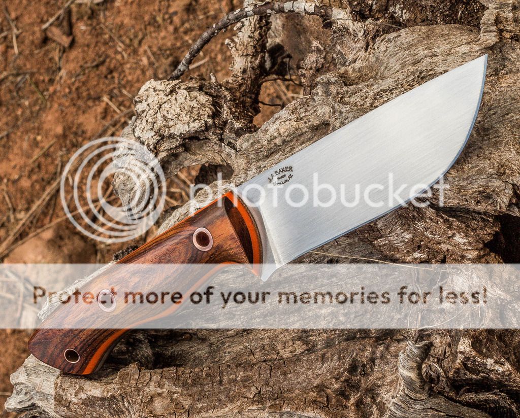

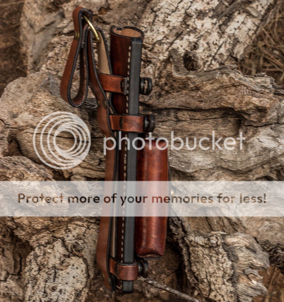

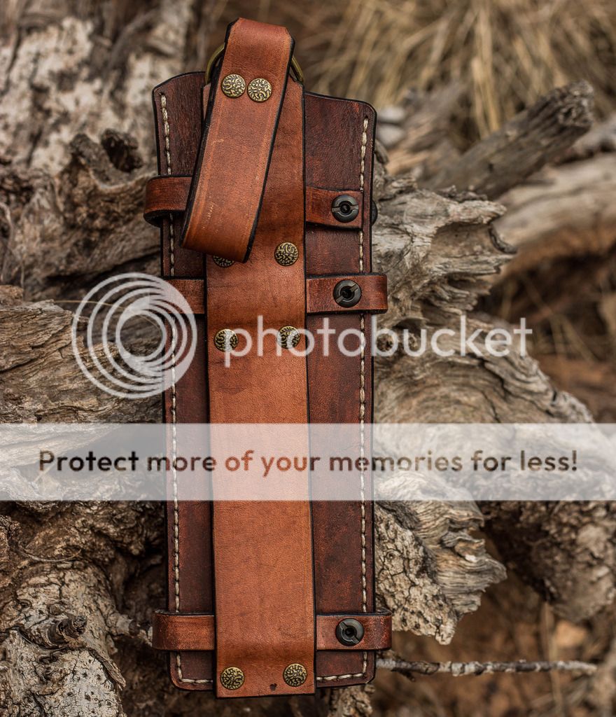

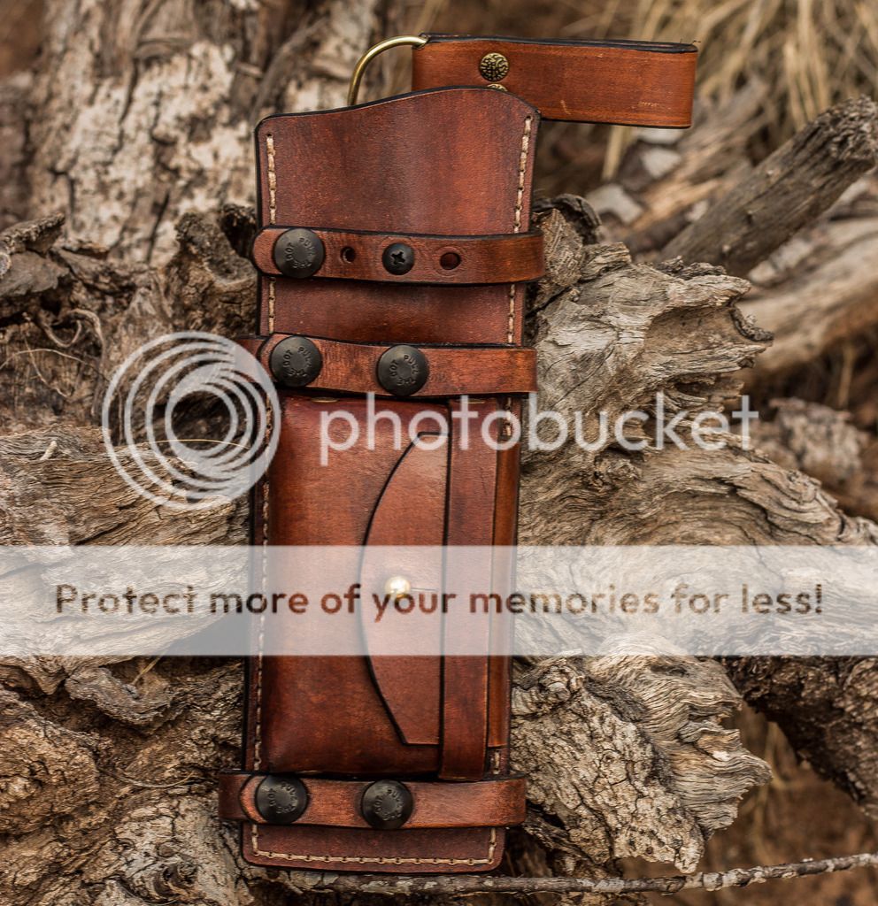

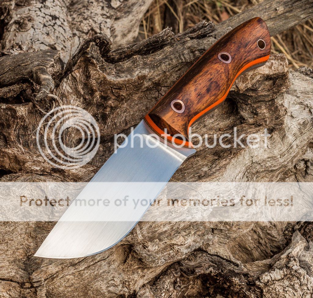

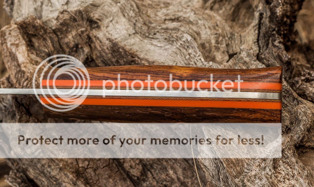

Here is a new model I have been working on. This one is a guard less version of it. The blade is AEB-L stainless, with a satin finish 5" blade and full flat grind. 5" cocobolo scales cover 1/8" orange G-10 and 1/16" brown canvas Micarta spacers. The tube pins are thick copper. At the palm swell it is a full 1 1/8" thick and has a heavy contour. I made a leather Scout style sheath with an integral lock pin system installed. For scale, the pocket fits a full size mint tin inside. The sheath is modular and can be completely disassembled (except stitched main body of course).
Totally Awesome work, Jeff! Thanks so much for these great models you're creating!
I like it a lot, nice finish on the blade. AEB-L is a much over looked steel, I have used it a lot and when heat treated proper it takes and holds a wicked edge.
