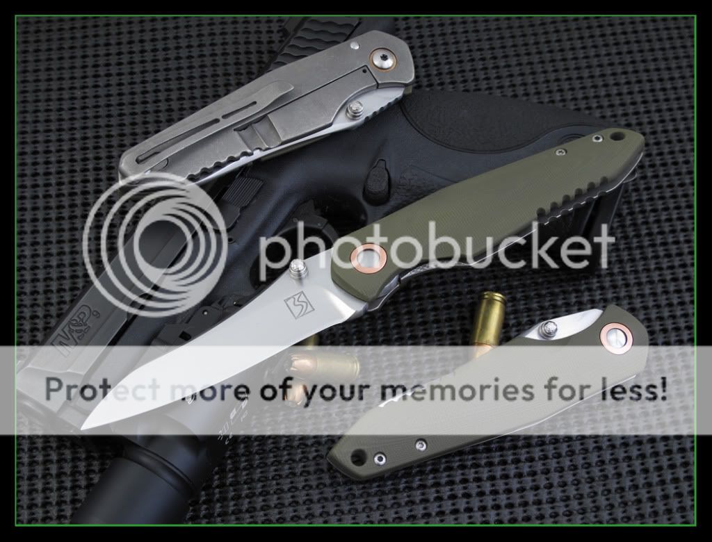

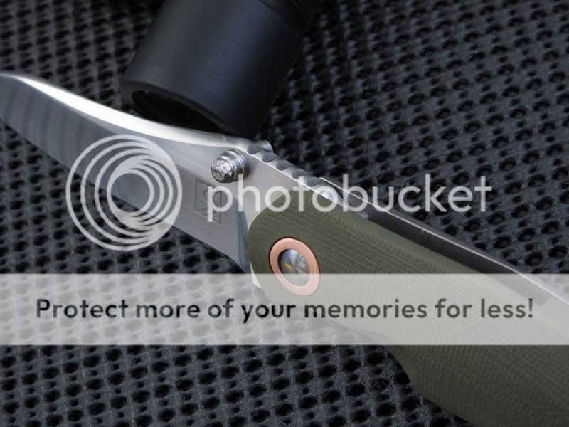

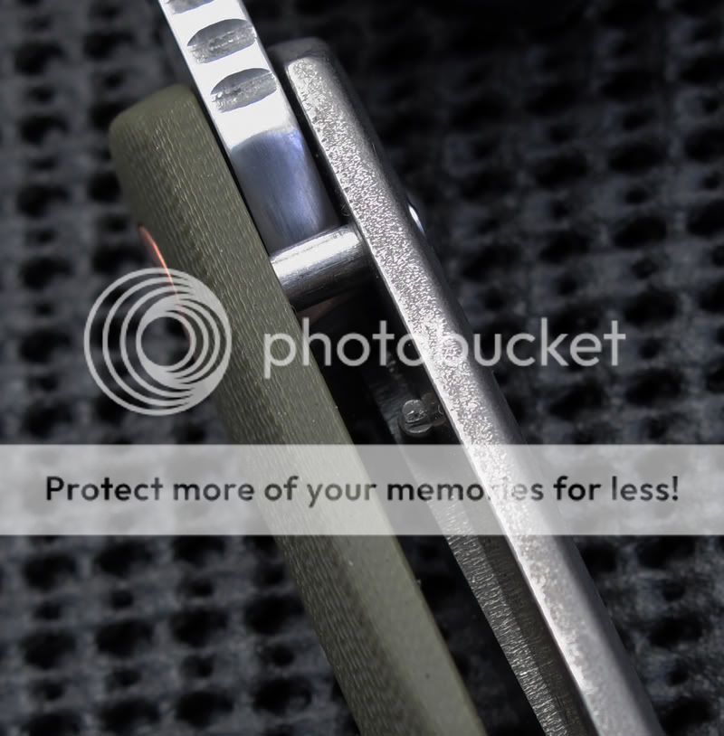

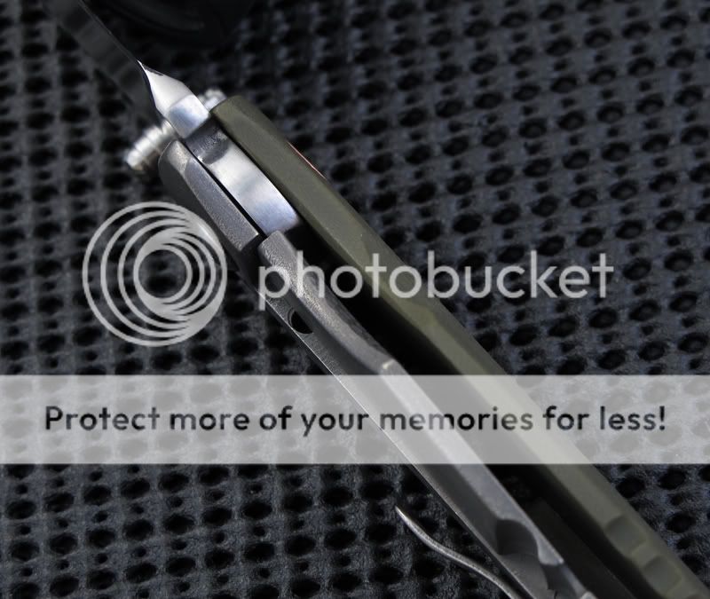

Hey folks, finally finished up this new prototype ive been working on for a while. Dont have a name for it yet. Its based off a knife I made for a buildoff contest on another forum, as well as a one off I made for another forumite. http://i260.photobucket.com/albums/ii20/Tricod/mikeh.jpg
I had such a good response to it, I knew I had to do something with it. But first two were special, that I couldnt use the basic design without leaveing them special. So... after a large redesign here we have it!
Dont have a name for it yet, but its got some awesome features!
Features
-Thrust ball bearing pivot
-inset pin lock stop
-ultra light construction
-low rider pocket clip
-titanium frame lock
-carbidized lock face
-Cryotreated CPM-154 blade at RC 59
-OD green G-10, and copper accents
Specs
Blade Length- 3.4"
Over all Length- 7.75"
Closed- 4.4"
Hope you like it!
