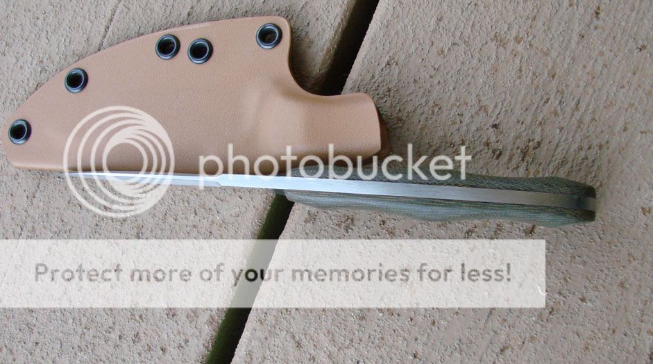

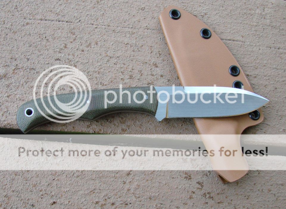

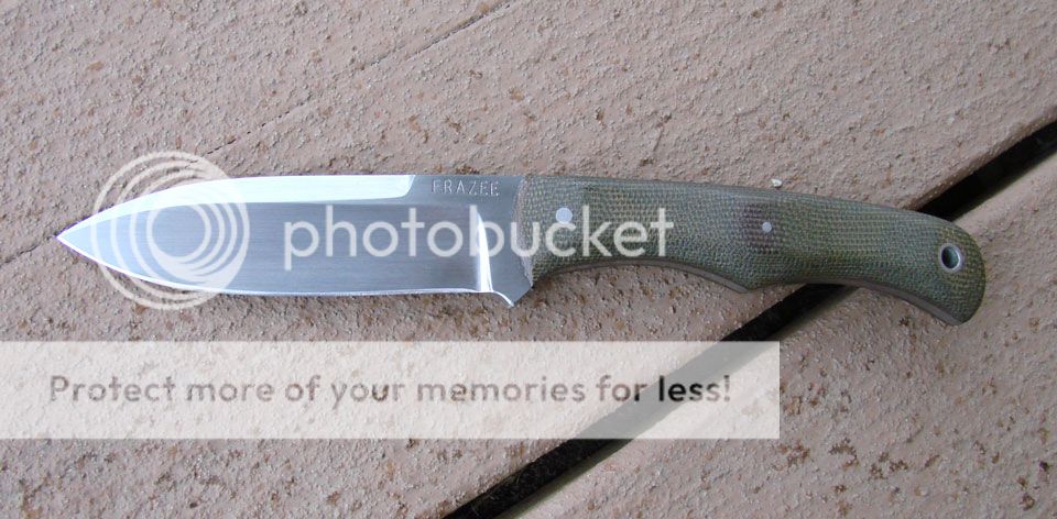

This one is a design collaboration between my son and I. He has a knife with a similar handle, I have a wiseman and a Krein with similar handles as well. Wanted to go with a 3" or so blade to keep things reasonable. I got mine done first- he is still working on his and it has to be heat treated and finished.
Steel- N690 at 60 Rc
Thickness- .147
Blade- 3.25"
Overall- 7.5"
Handle- Sculpted green micarta, blasted and stonewashed SS pins and tubing.
Kydex sheath set up for angled small tec loc or horizontal large tec loc.
ZDF stands for Zachariah Daniel Frazee
It has been a fun project for my boy and I. Dan
