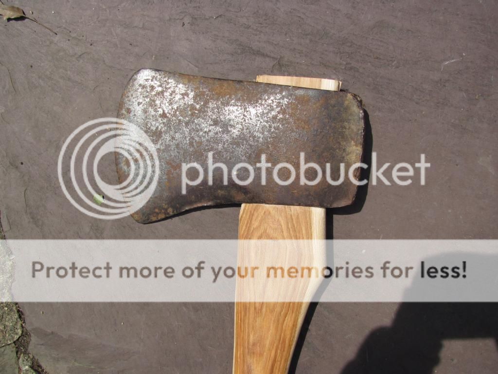

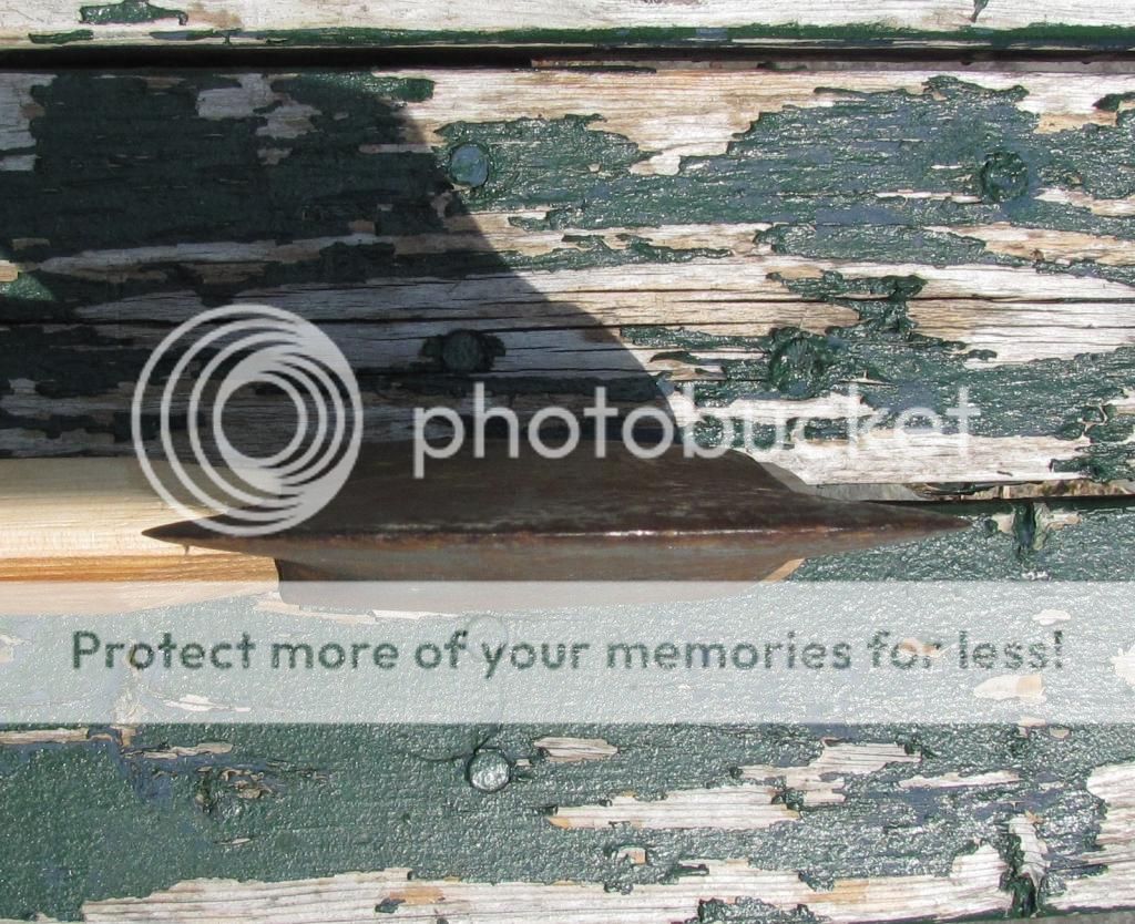

Well I bought a new 36 inch handle at Menards because I didn't want to wait for shipping or pay for shipping.
I spent about an hour with calipers and a file, I got the first 1/4 inch of the handle end to fit the eye of the ax perfectly, then I used the calipers to help me shape the entire end to match. The sides of the newly-shaped part were parallel and long enough to let the head slide onto the ax completely. The eye is not perfectly symmetric - you can see that in the top down picture.
I've heard two theories - add metal wedges perpendicular to the wood wedge or don't add them. What do you all think?
Keep the maple and you can turn it into axe handles in the future! That's a whole different level of fun!
You did a fine job of re-hafting. Don't bother with the diagonal or perpendicular metal wedges; some sort of gimmick on commercial installs to make you believe the primary wedge won't work it's way loose.
