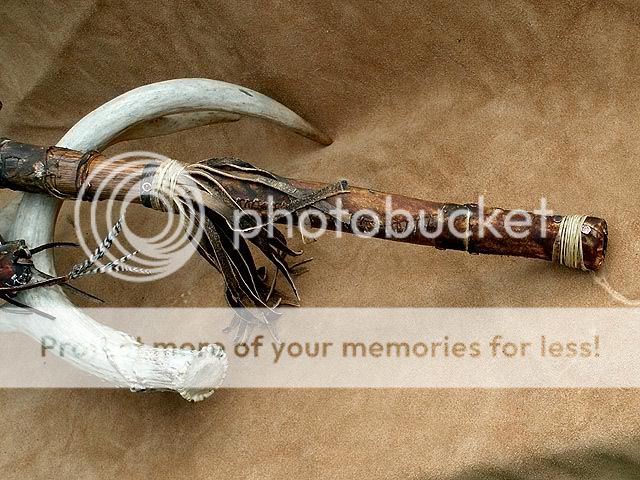

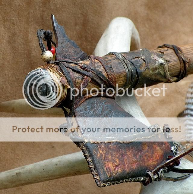

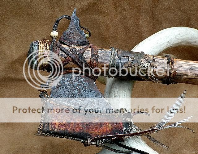

One of mine that stayed around too long, so I started throwing it and I’m not very good but I love to do it. The haft was scratched and banged up pretty bad so a remodel was in order. Rawhide scrapes, some braintan fringe and some of the antique snuff lids . Scrapping, homebrew dye, dirt, grease and shellac for the finish. I refiled the edge somewhat with a more pleasing profile and shortened and refined the spike. Iron is from 100 yr. old plow and the haft is oak.
I don't say this enough, thanks to John Cohea for resurrecting this form of Celt tomahawk for my thievery.....Randy

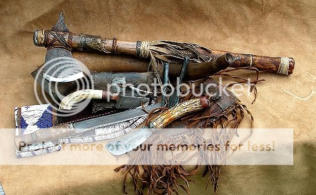

And a shot with some friends.....
