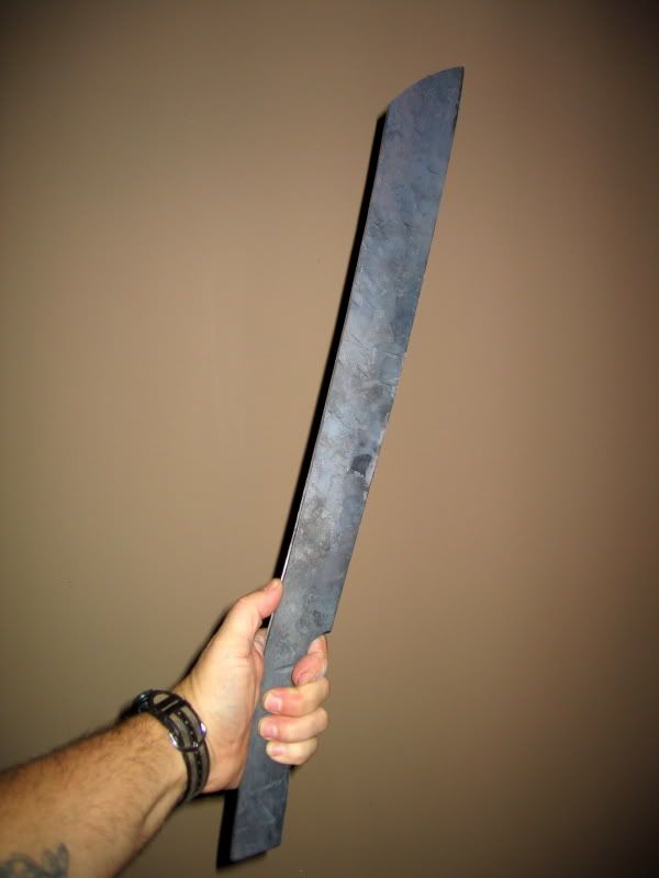

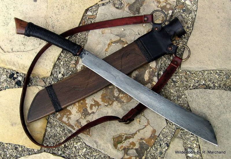

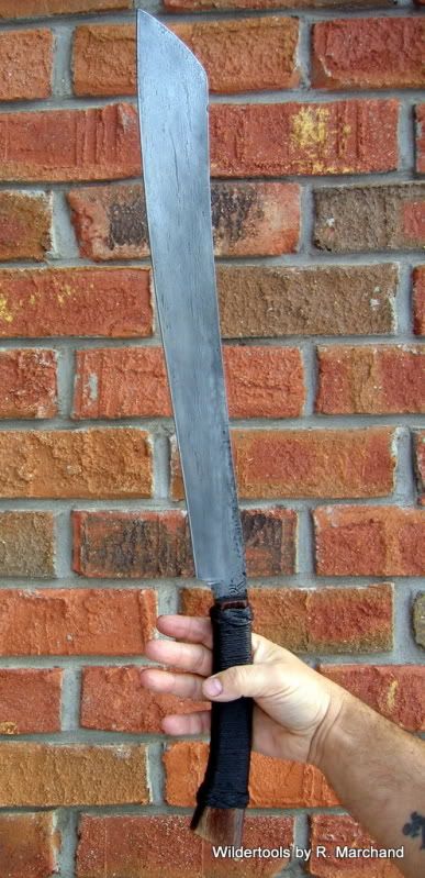

I made this Blade months ago as a side project and hadn't got around to sheathing it until recently. I guess I was waiting for inspiration. Anyway, the "Marchete".... thanks for looking.:thumbup:
Rick
Marchete
5160 forged
distal tapered, 3/16" at thickest.
17" cutting edge
2 1/8" at widest
26 3/4" O.A. Length
3/4 length tang
Hickory handle, hemp wrapped, epoxy soaked

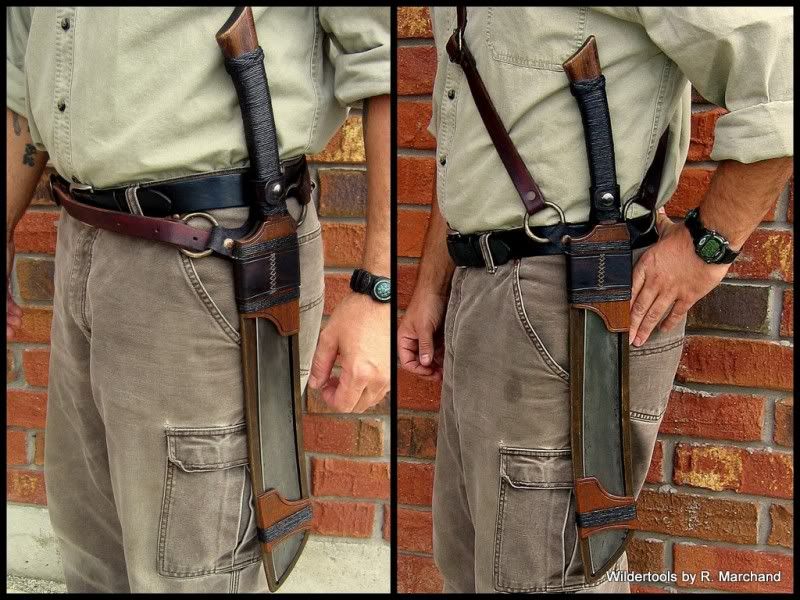

Sheath is poplar/yew, hemp wrapped, leather mounted with belt/baldric carry option.
