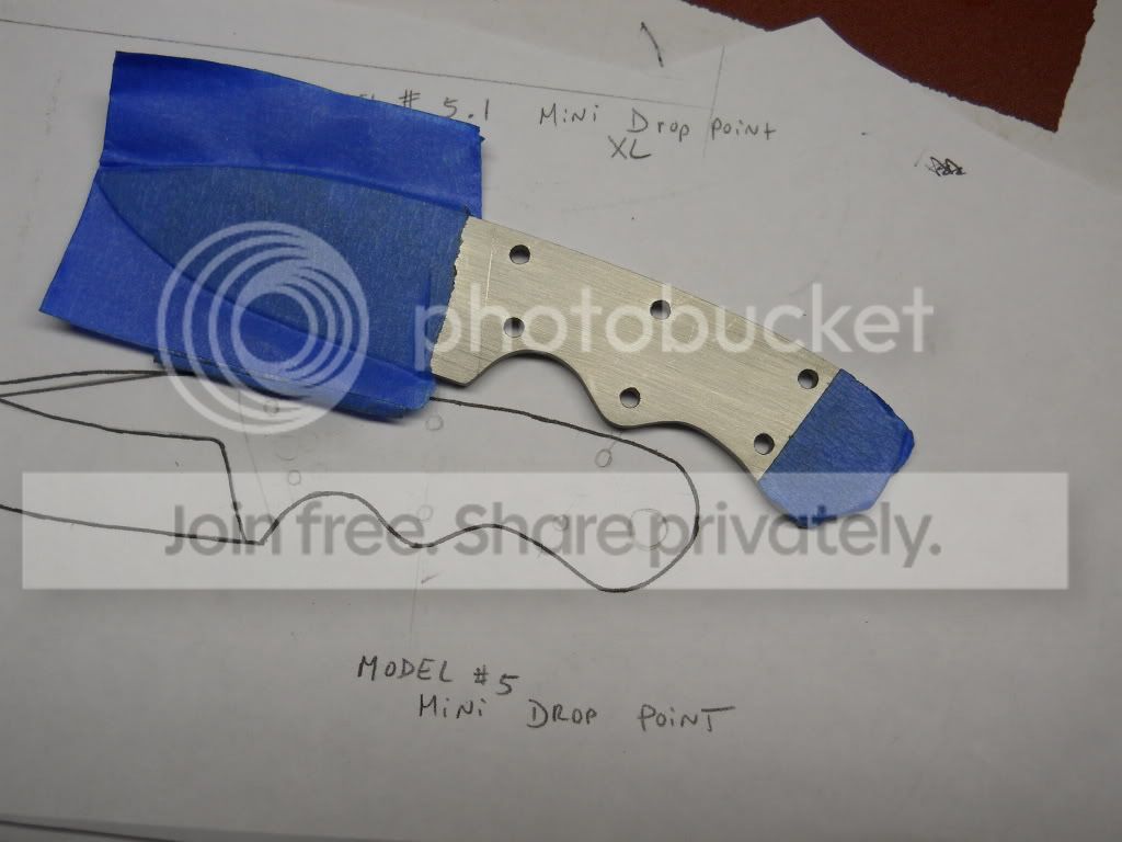

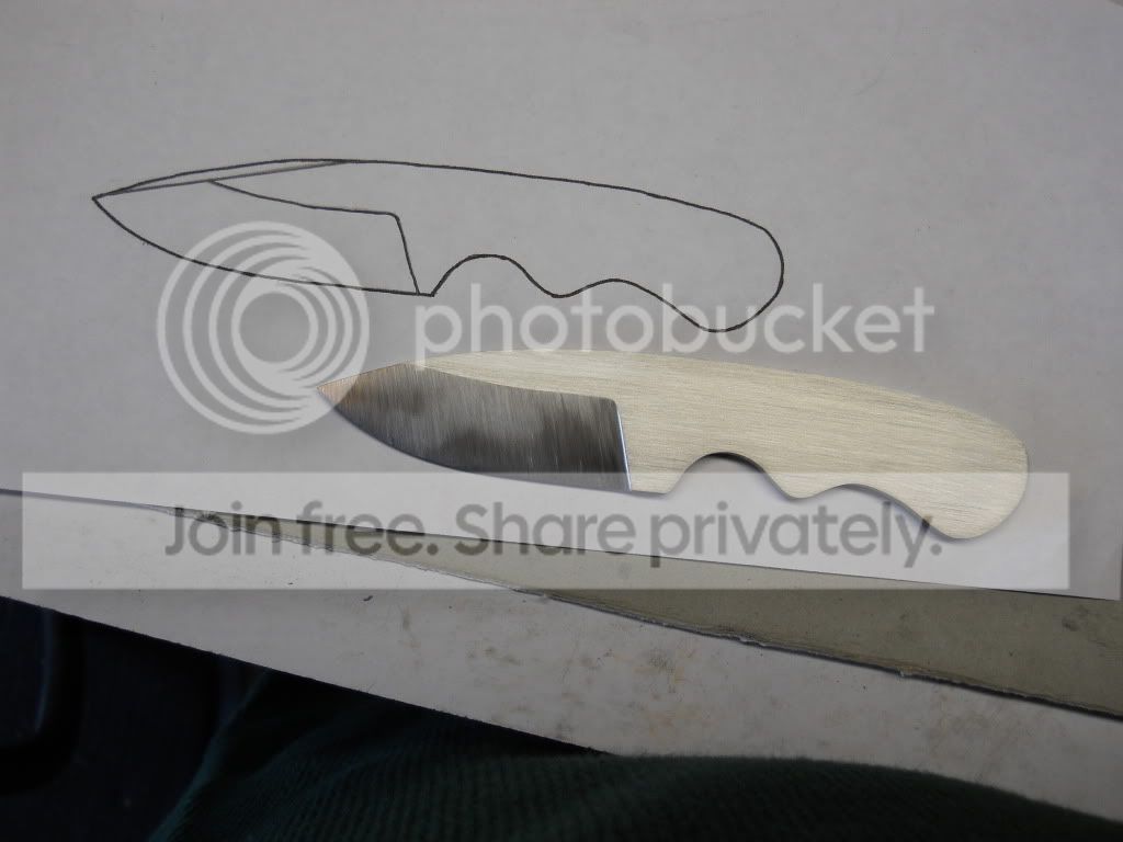

Well I'm just about finished grinding a new one I drew up a little while back. It's about 6" overall and I'm calling it simply my mini drop point for now. It's .178 thick D2 tool steel from Bohler. In the drawing you can see the line where I planned on putting a swedge, but now I'm not sure if I should. I'm thinking it looks pretty good as is, but I'm still tempted grind that top edge a bit. What do you guys think?
Thanks!
Looking good as is but I do agree that a swedge would really make it nice. The only thing I'd be worried about is messing up that beautiful grind. However if you're feeling brave or just don't have two left hands like me I'd say go for it. If not you can always play it safe and file it in. Either way, it looks great so far!
we have similar tastes jonny. the fixed version of the folder im making looks a lot like that, right down to the swedge. mine is just missing the index finger bump. ill post a picture when i get home from work.
With the grind it has, I wouldn't swedge it now, not sure it would look right or for that matter serve a lot of purpose as the grind at least looks like it thins it out out to the tip anyway.

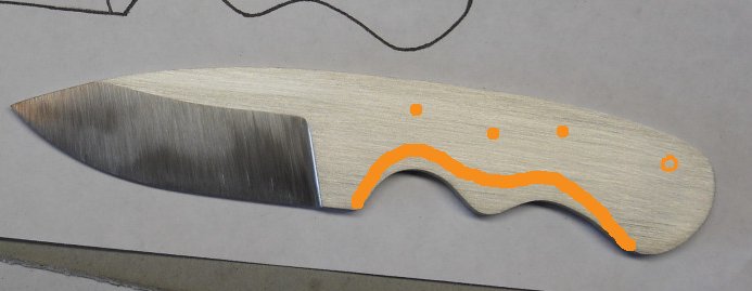

Just to my eye, I would bring the tang up more, thinner from the first finger groove through the second, leaving a bit of a dropped knob to the back, about as deep as it is now.
Horrible work I know, but roughly something like this.
The only reason I suggest this is with a smaller, stout blade, at least what I like, is a very solid first finger groove to really lock on. Also it balances out the width/stubbiness of the blade.
I have no real clue, just taking shots, curious what others would think. I've only seen a couple guys do the deeper finger grooves on the short stubbies and always liked it.
I can see what you're saying:thumbup: I only have two slight problems......A, with a sub 6" knife I wanted the handle to do a decent job of filling the hand, and B.......I just finished drilling the pin holes for this one!:o, so a bit late to change it now. I'm going to try doing six 1/8" copper tubes for pins and will have a 1/4" copper tube for a lanyard at the butt. I will work with some deeper finger grooves on one of the next ones for sure, Kingsqueak. I already have three more blanks same size and thickness ready to go to do more of this model.

looking really good, Jonny. Make a pair, one with the swedge, one without!
I'm gonna make a bunch!:D
First I'm going to grind out one of the larger ones, though. I want to see which is more comfy in the hand.

Jonny, first off, let me say I like what you have so far. Very clean and nice grind line. When you're talking about making a user, I think simple is best.
Now as to the swedge, what do you intend for the knife to be used for? If it's going to be used as a sort of everyday carry type knife, then I'd like the swedge there to aid in penetration. If you intend more of a skinning knife, then I'd shy away from the swedge.
For aesthetics alone, I like the swedge! :D
Tobin
Tobin
Thanks for the input, Tobin.
This is geared more toward everyday carry with utility in mind. Not intended so much as a hunter. Maybe I'll go ahead and swedge it. I can always make another one without, right?
