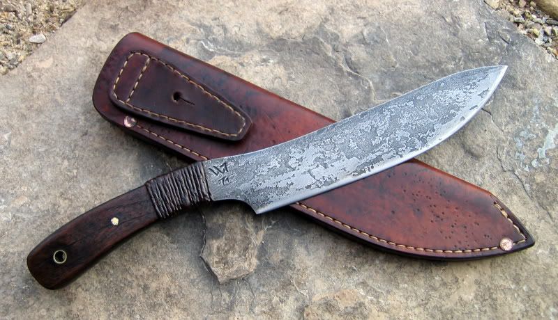

Hey Folks,
I really happy with this one. It is the same model that was entered in the W&SS Camp Knife Challenge last month. The sheath was fun.
Rick
SCurve
Material – 1080, handforged.
Thickness – 3/16" thickest at spine, distal tapered.
Blade length – 7” cutting edge.
Blade width - 1 1/2" at widest.
Geometry - Flat w/ convex secondary bevel.
OA length - 12".
Handle slabs - Walnut (supplied by customer), 4 1/2" long, brass pins/lanyard tube, hemp wrap/epoxy sealed, sealed with tung oil and buffed with beeswax.
Finish - Rough forge finish with vinegar/bleach etch.

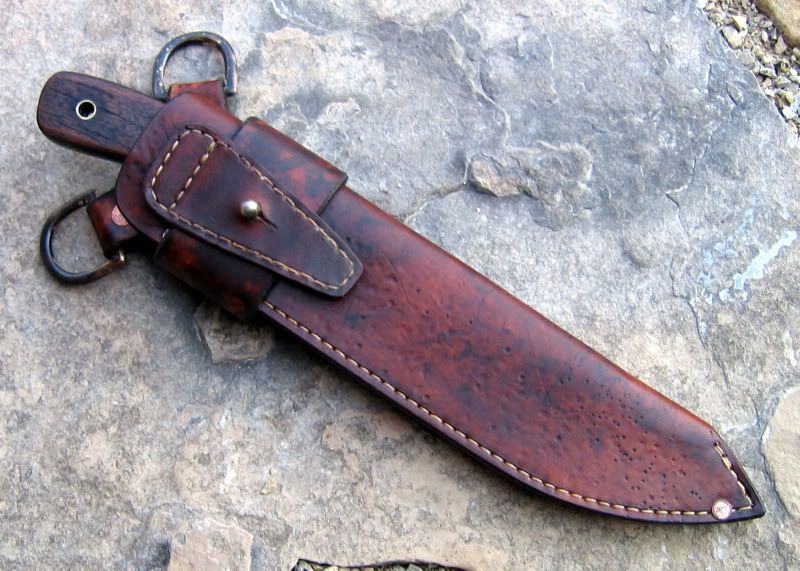

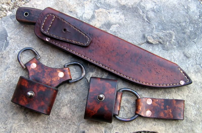

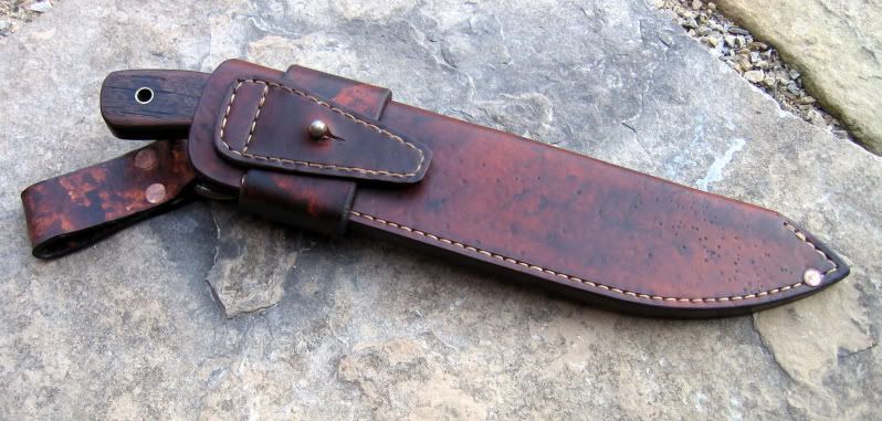

Sheath - 10oz vegetable tan, hand stitched, tooled and riveted. Interchangeable carry system.
Another nice one..........I really appreciate the edge below the knuckles. :)

It is extremely comfortable in the hand. The radiusing of the drop edge and tapering out of the handle near wrap make for a secure grip that is comfortable and provides power right at the back edge of the blade for forced cutting.
Like all of Rick's knives, this one comes extremely sharp and the convex edge is perfectly even across the length. The balance is 0.5" past the hilt on the back part of the blade making it slightly tip forward. Even though not neutral in balance, the knife is surprisingly lively in the hand because of its overall lightness.
The sheath is just stunning. Both functional and beautiful. The ability to switch out modes of carry is just so unique. Wearing it with the dangler places the knife at a perfect position on the hip and the knife does not seem to move or slap the leg while walking. I'm currently rigging a baldric strap for it, but a quick test shows that his buckles are placed to hang the knife in a good position without contributing to any swing.

sweet. Really nice sheath too. Great design with the frog. You can just slip it through the belt, or put the hangers on.
