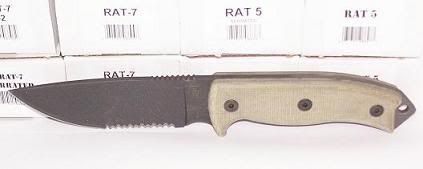

Ontario put the RAT5 Serrated Blade knife into production this year. The traditional 1095 Carbon Steel, flat ground 5" serrated blade, Canvas Micarta Handles, and a skull crushing Pommel. Blade thickness 3/16". Over all length 10-3/4"
Enjoy the picture,

What's the handle material, really? Why the coated blade with such a bright handle color?
Hello,
The Rockwell Hardness is 56-58 Rc for the 1095 RAT knives. Ontario’s 1095 blades seem to range from 50 to 58 Rc depending on the knife style / line.
Handle material: Canvas Micarta, the color is the natural color of this synthetic material. Canvas Micarta has superior griping ability in extreme conditions.
“Coated blade” creates added protection from corrosion when introduced to wet / damp conditions. If you intend to use the knife in a marine environment I suggest that you upgrade to the D2 steel.
This is a flat ground blade.
The “Tradition” is; Ontario is well known for using 1095 steel in their blades. Many of their RAT knives are also made in D2 steel.
