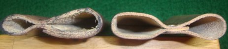

Here's something you may do to cut down on some of the thickness...just a real quick run through with scraps but I think you can get the idea.

Thanks Rayban ... I really need to find a supply for veg tan leathers! I'm getting the hang of handstitching and the list of projects is getting longer. :D A lot of practice has been with chrome tanned scraps :thumbdn: (from Hobby Lobby) but it does not work as well as veg tanned :thumbup:
I've got a grooving tool but I'm not sure how deep to make the groove - I would suppose that it needs to be at least as deep as the diameter of the thread being used. Is there an unwritten "rule" about grooving that I haven't heard of yet?

As far as the groove for the thread. I would not make it real deep as you start to get too deep and the leather will close up over the thread as you pull it tight. I make a accurate first pass and then if needed I make another light pass to deepen it a bit. I'd say just about half the thickness of the thread is deep enough. you will pull it tight and it will cinch down. A tiny bit above the channel will be fine and it is doubtfull that the any abrasion on the thread and cutting it will happen.
