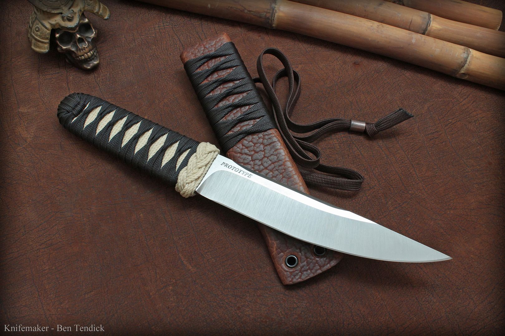

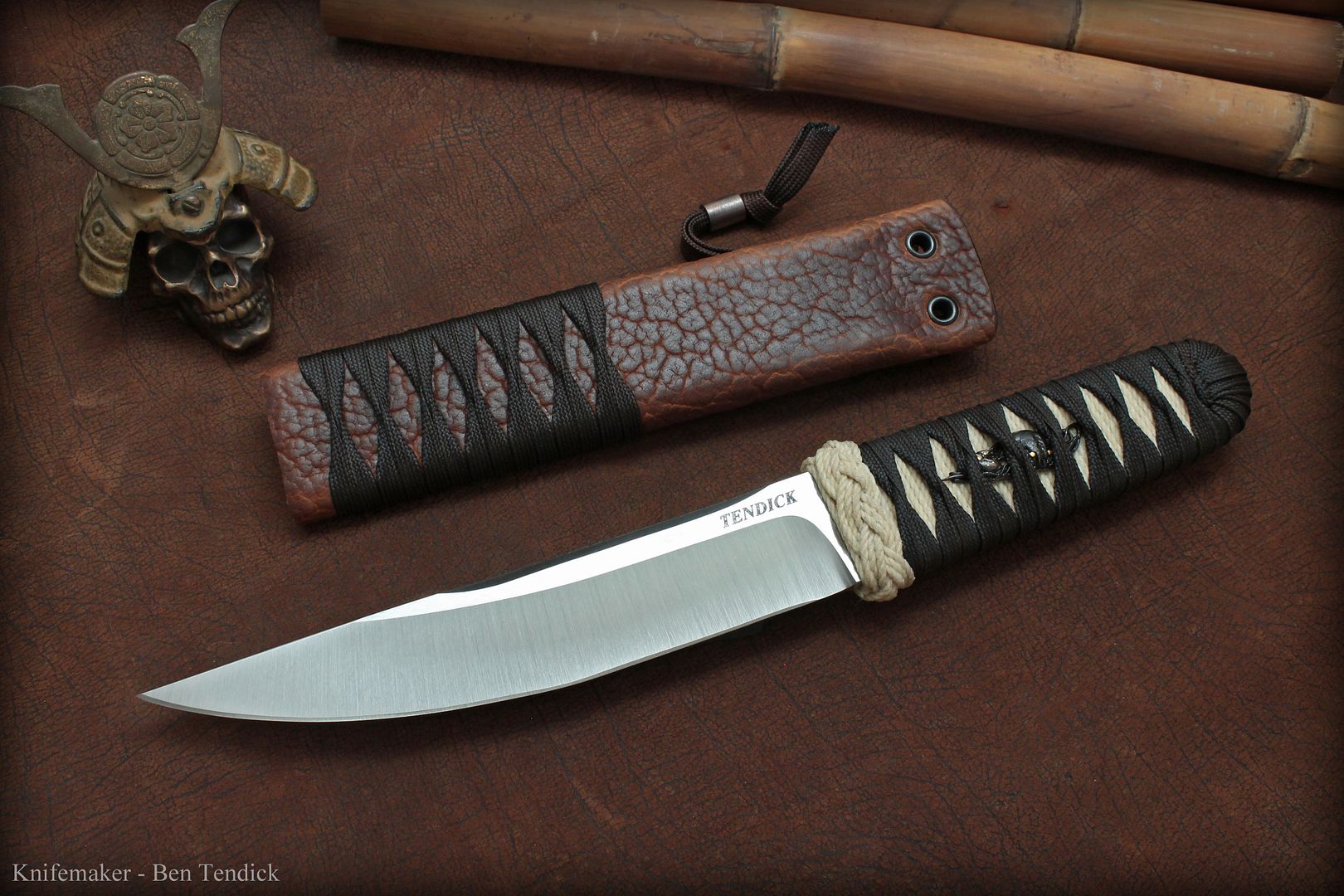

I have been playing with some different geometry on my kwaiken/tanto models. This one was playing with the "Okissaki" style or long tip. Which is about 50% of the blade length. (Although it does not have a defined yokote.) I have named this model "Dokusei". Which translates to toxic.

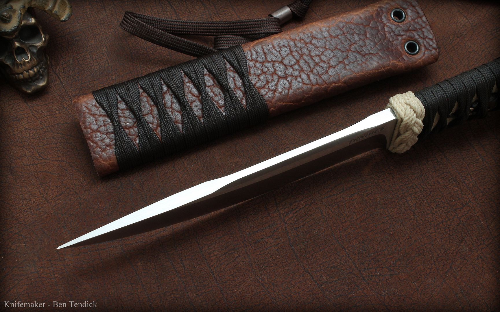

I hesitate to call this one a kwaiken, with the full .285" thick 3V 7" blade and a nice full handle. It feels more like a small tanto. The distal taper comes to a VERY sharp point.

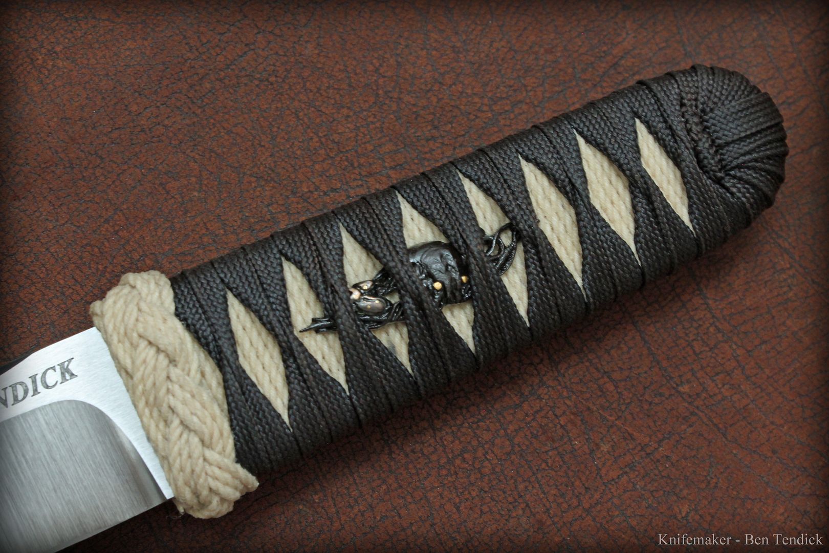

The menuki is an Antique Edo period piece. It is a shrimp with small shells. Metals appear to be Iron, bronze and gold. I was saving it for a special knife and it felt right on this one. The cotton cord behind helps you see all of the cool details it has.
Of course it is finished up with a matching bison wrapped, kevlar lined, Hartsfield style sheath.
Any comments or critiques are welcome.
Thanks for looking!
I like this one very much Ben. The long tip gives it a very graceful line. Superb workmanship as always.

Loving that cotton cord
Of course I like this knife. I'd like this one better without the swedge, Ben.

the two curves on the spine look really cool in the second photo. are there any defined parameters for the size of a kwaiken ?

That looks like a lefty? because the menuki is set to work as a palm swell for the left hand?
That is correct in most cases. This is double ground and I put the menuki on the Presentation side.

At first, after focusing on pic 1, I thought "without swedge would look really clean and traditional".
Then I focused on pic 2 and thought "man, that swedge really helps define modern traditional in Ben's work".
Where I netted out...love this knife with the swedge and the idea of the same without swedge.
