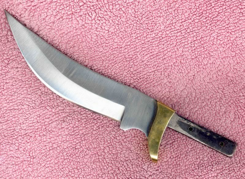

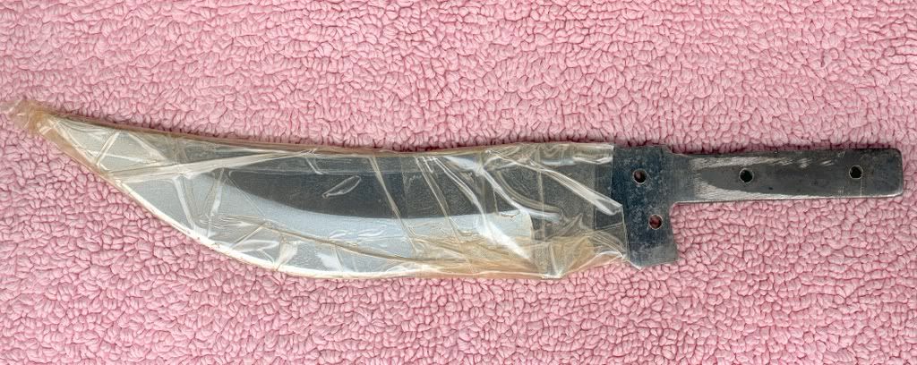

I got a new blade that looks like a Buck Kalinga blade:
Only in the direct comparison the differences are visible. The Blade is a few smaller than a Kalinga blade but clear larger than the Akonua blade. It irritates, that the angel is that short. Now I want to give the knife a new life. But what handle looks best with this blade?

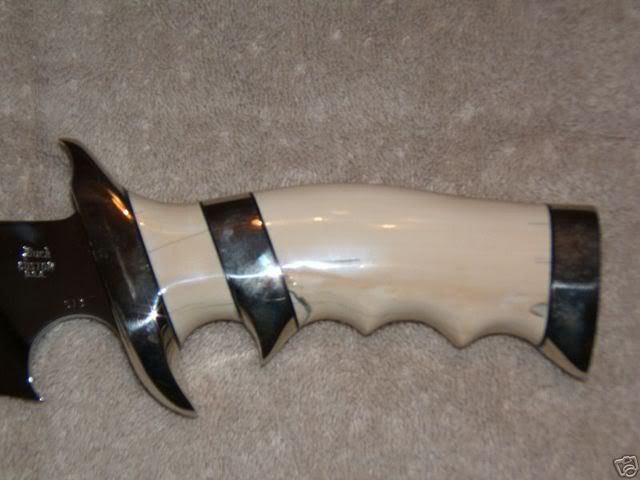

What's your opinion: Shall I use the mounted brass guard or not? What kind of wood looks better: dark or pale wood? with ot without a ferrule? Shall I imitate a full tang or do I leave the tang inside? Or makes it sense to copy the handle of the "Haebbie DM 119" (without its mistakes)?
Lookin' forward to a lively discussion,
Haebbie

Well then, the project continues
Here's the first draft:
And the blade without brass guard
Material from left to right: Bison bone, nickle silver, red paper fibre, nickle silver, amber,
silver, fibre, bone, thin black fibre, black locust, fibre, bone.
What do you think?

Steve, Dave,
thank you for your answer. I like to build the "Kalingonua" similar to the bowie I made earlier.
Have a look at the essentials
and to the finished knife.
