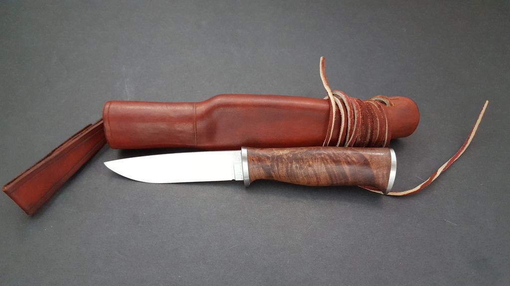

Hey guys, wanted to post a project I'm working on. I'm not totally done yet, but wanted to post a few phone pics and get some feedback as I'm waiting for the finish on the handle to dry.
As the thread title suggests, this is not what would be considered a puukko in the "purest" sense, but it is my take on the style, and makes the changes I like in a knife, while hopefully retaining enough of the original inspiration to still be called a puukko. The blade is made out of O1 tool steel, hardened at 60 for good edgeholding. Instead of the typical scandi or partial height grinds, I went with a full flat grind. It may not be real clear in the intial pics, as they are from my phone. I will take better quality photos once it's done this weekend.
I know the partial height grinds are popular on these knives and give a little added strength if you're beating on it, but I much prefer the added cutting performance of a full height flat grind combined with a thin edge. I left the tip fairly stout anyway, so short of abuse there shouldn't be any problems. Blade is 1/8" stock, 4.25" long.
Obviously it is a through tang, and the guard and buttplate are both stainless. Handle is curly maple. I will have better shots of the silver soldering and such later on. Sheath is in the traditional style, with wooden liner. I used 10 oz. leather on this one, so it is a very durable sheath. The friction fit locks it in very well, you could wear it as a neck knife if inclined with no issues. It is locked in there and won't come out unless you want it to.
So anyway, here are some pics, please feel free to ask questions or give comments. I'm happy to hear it all.

Now that is ... SCHWEEEETTT!! Nice on there Sam!!!!:thumbup::thumbup: John
...but I much prefer the added cutting performance of a full height flat grind combined with a thin edge.
So do I. I have a bunch of puukkos made in Finland, even some custom puukkos but I simply find the full flat grind with an edge that is thin, close to zero is plenty strong and more acute and more versatile than a scandi grind. I really like the looks of your creation there.
Thank you very much, John! :thumbup:
Thank you, SwiftDream. Scandi grinds have never really done it for me for general use knives, and I am a big fan of the thin edges on flat ground knives. I haven't had any problems yet, as long as it's used as a knife :cool:.
Pretty awesome!!!! :thumbup::thumbup:
Thank you, SAK Guy!
Looks more like a Russian inspired knife than a Finnish puukko.
Thank you Jhansenak47, much appreciated!
Another work of art, Sam.
Flattery totally works on me, bowie. :D
Thin is in for knife usage in less than 5 iches IMOP
Great looking user, I love my Helle Harding but it would be better for my uses in flat grind.
Thank you, Brad. I agree with you, for that size and use (primarily cutting/slicing) THIN is the way to go. Scandi doesn't do a whole lot for me, outside of dedicated woodworking tools.
Sam :thumbup:
Sam,
Not sure what I'm more impressed with - the knife or the sheath. Wow! :thumbup:
Tom
