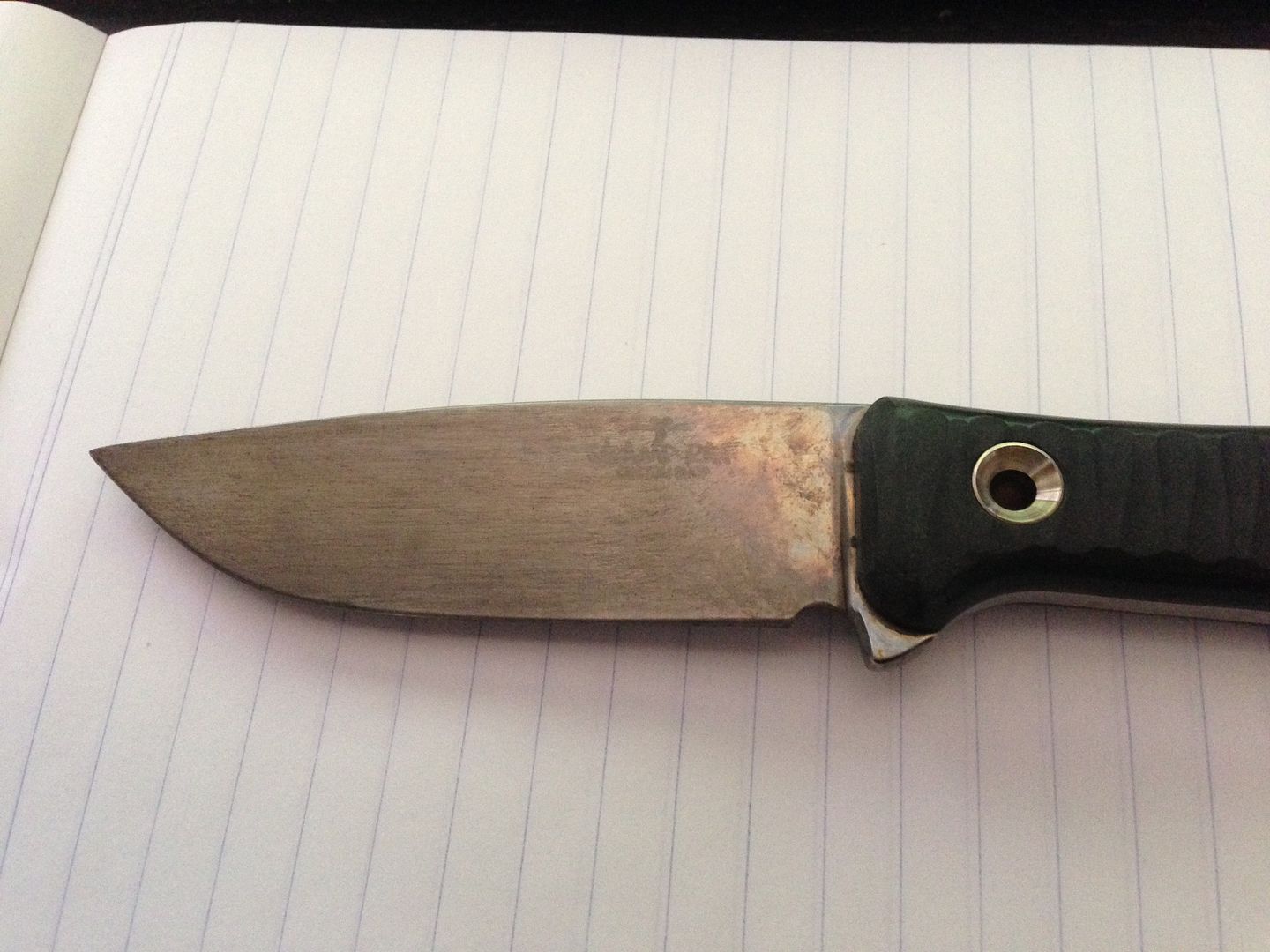

My shiny once upon a time Rodent Solution:
