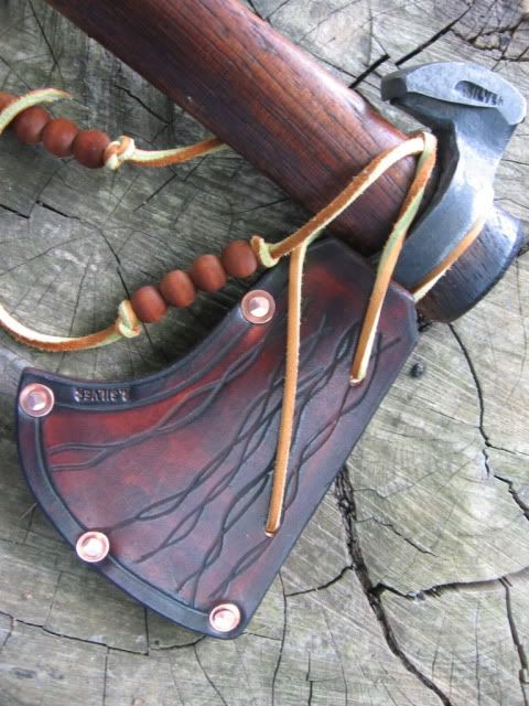

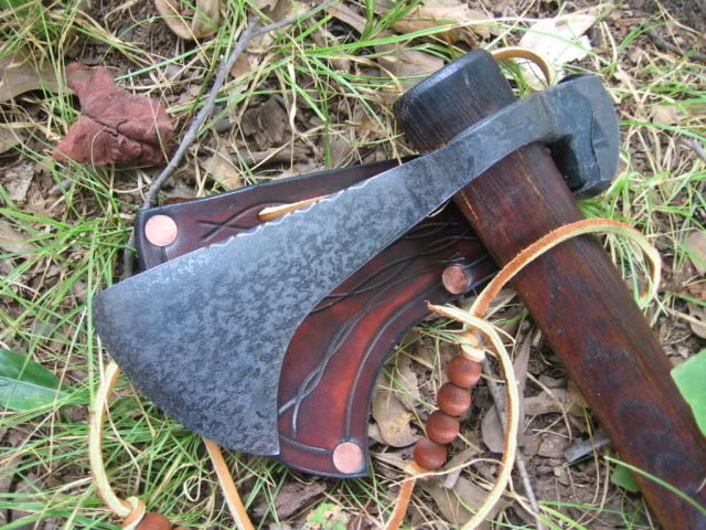

Here's another rr spike hawk I finished today-Thanks for looking:)Regards Butch
Man, NICE job of forging......great looking package with your excellent sheath work. :cool:

awesome hawk.
standard spike or HC?
also - do you round punch the eye hole or cut with hot chisel then widen?
awesome hawk.
I think this one was hc,but I can't tell a lot of difference in the edge when hardened--The eye was hot slit,very tricky with these only 5/8" square- then drifted with a reg. hawk drift-Thanks again for all your comments--Regards Butch
