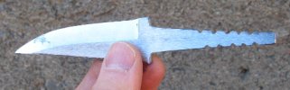

Yes, I fill the opening with epoxy or hot glue. If something goes wrong, hot glue can be remounted, epoxy is permanent. The melting temperature of hot glue is generally 55 or 80 degree of Celcius. The later is better for knives, if the summer is very hot. I think the epoxy is stronger. I have tested that other fastening is not mandatory with epoxy. If you make notches on the tang, and glue it into the handle with epoxy, it does not come away without breaking the handle.
Here is an example of a notched tang which can be mounted with epoxy.

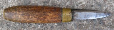

I also introduce how the tangs of Finnish puukkos were mounted into handles before invention of epoxy. Many puukkos had bare wooden handle, but better ones had ferrules. When I was a child I got this puukko from my grandfather and he told that it is 200 years old. Now it is 250 years old and still in good working condition. Inferior quality old puukkos usually have loose handle, but this one has still a solid fit. The reason is strong ferrule. Fitting work was minimal, the tang was nailed into a tight hole, wood deformed, and the ferrule prevented the handle splitting into two.
The ferrule is an ugly ring, which is typical for ancient puukkos. It is stronger than a bolster. Modern puukosmiths prefer better looking bolster. The ring ferrule is not any more necessary, because invention of epoxy.
The tang is peened over the brass plate.

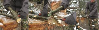

I got more test results from the field (3 puukkos). Otherwise than earlier, the sharp point withstood severe hitting, like that in the picture. The point bent but did not brake. So, I stick with the original sharp pointed whittling blades. According to the latest test results they are very suitable for bushcraft.
