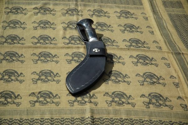

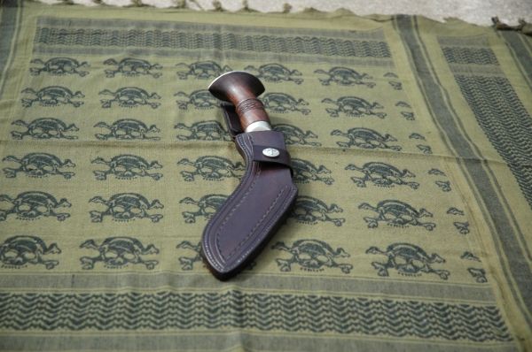

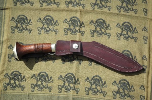

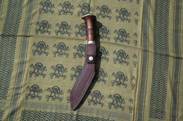

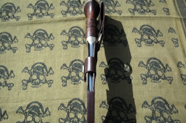

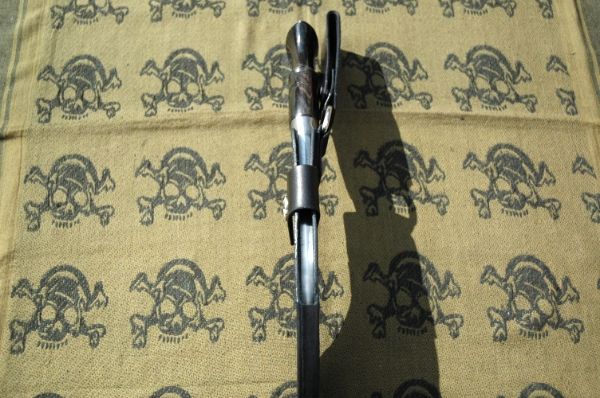

Hey Guys and Gals,
I took the leap into the craftsman/maker so now I can offer my services to you. I just finished up two more for a 18" Chitlangi and a 15" Ganga Ram. I added some pictures of the entry of the sheaths. With the khuks you have to try to incorporate an open spine type sheath or you will never get it out without cutting the leather. This is how I do it and it works great. On these two I did some border stamping and line work. The leather is 8/9oz double shoulder, stitched with artificial sinew and I used some cool snaps I had. I also used the D-ring belt carry. I like the D-ring on the bigger blades so it can move with you and not bind. On these I did not do any baldric type attachments just belt or pack carry. As always I hope you like the pics.
