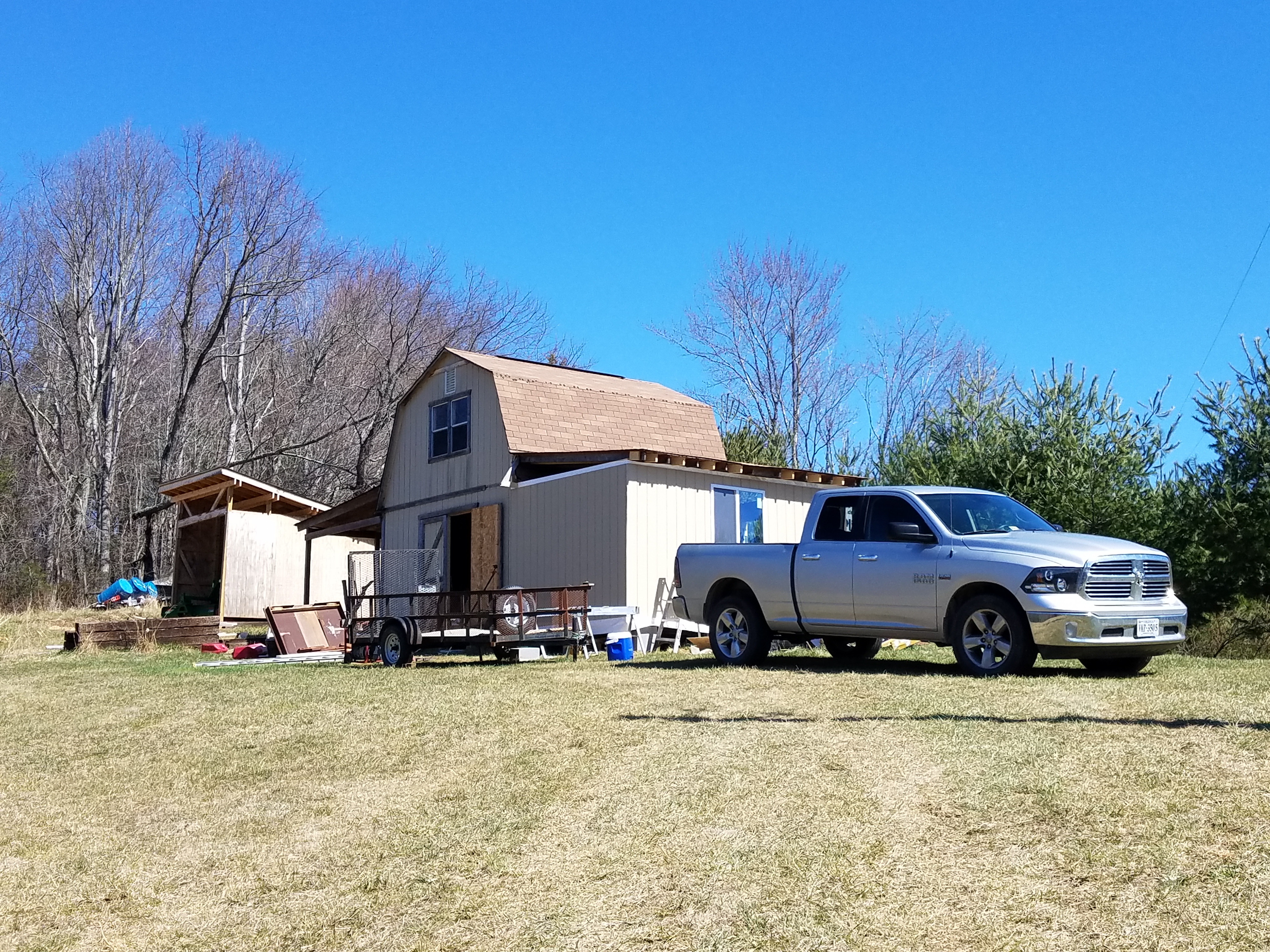

For those of you that remember, I had 2 options for the shop space. A 10x10 portion of a 10x20 shed, or a 16x16 2 story barn. I didn't go with either. My stepdad and I decided to enclose a 10x16 awning/lean-to on one side of the 16x16. I used 2x6 studs for good insulation and bought a decent door and window. We will be cutting out a large doorway into the 16x16 area in the near future. That will allow us to expand as needed. Eventually, the upstairs of the 16x16 will be a finish room. We may even add similar additions to the other side and the back. This image should give you an idea.
I pondered things over and over. My girlfriend and parents would literally try to distract me just to give my mind a rest. I filed for LLC status and started making purchases well before the shop was ready. I somewhat regret that... only because I had boxes, insulation, and other shit stacked to the ceiling in the 16x16 side and getting to something I needed was impossible due to all of the woodworking machinery already in there. It all worked out though. Here is what the inside looks like now, minus a metal cutting bandsaw I put together Friday night using the worst possible directions imaginable... just a picture and a parts list.

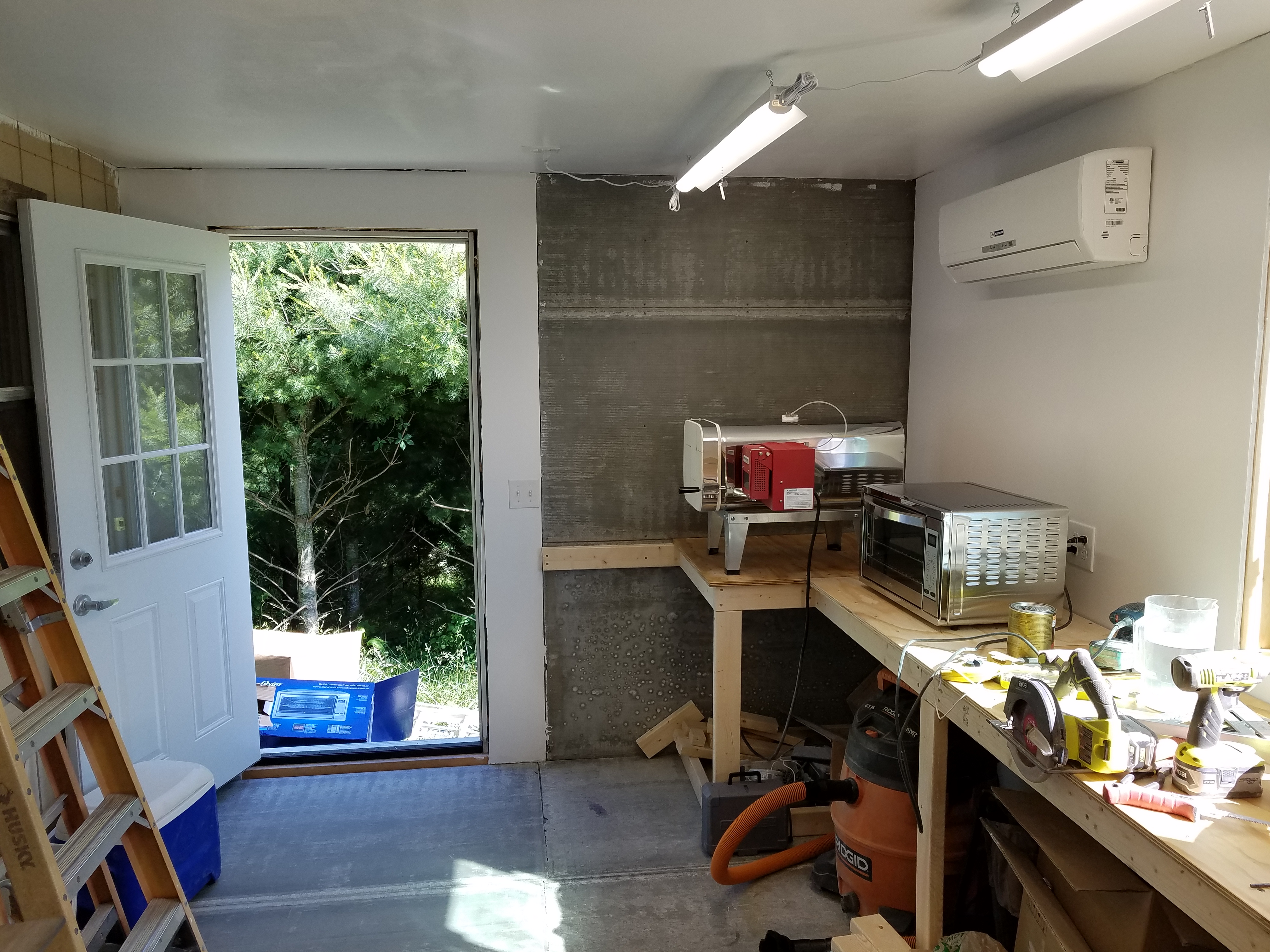

In this picture you can see a mistake. We originally wanted the EvenHeat KF22.5 to back up to the cement board wall. I realized that it greatly limited my space in that corner. My stepdad and I had planned to put a full size oven in for tempering. That limited our space even more. I settled for an extra large toaster oven for now. We plan to add the full size oven to the 16x16 side when we expand. Also, I got a Blue Ridge Mini Split for heat and air. I did most of the install and a local HVAC guy did the final hookup for $125. That unit is rated for 350 sq ft.

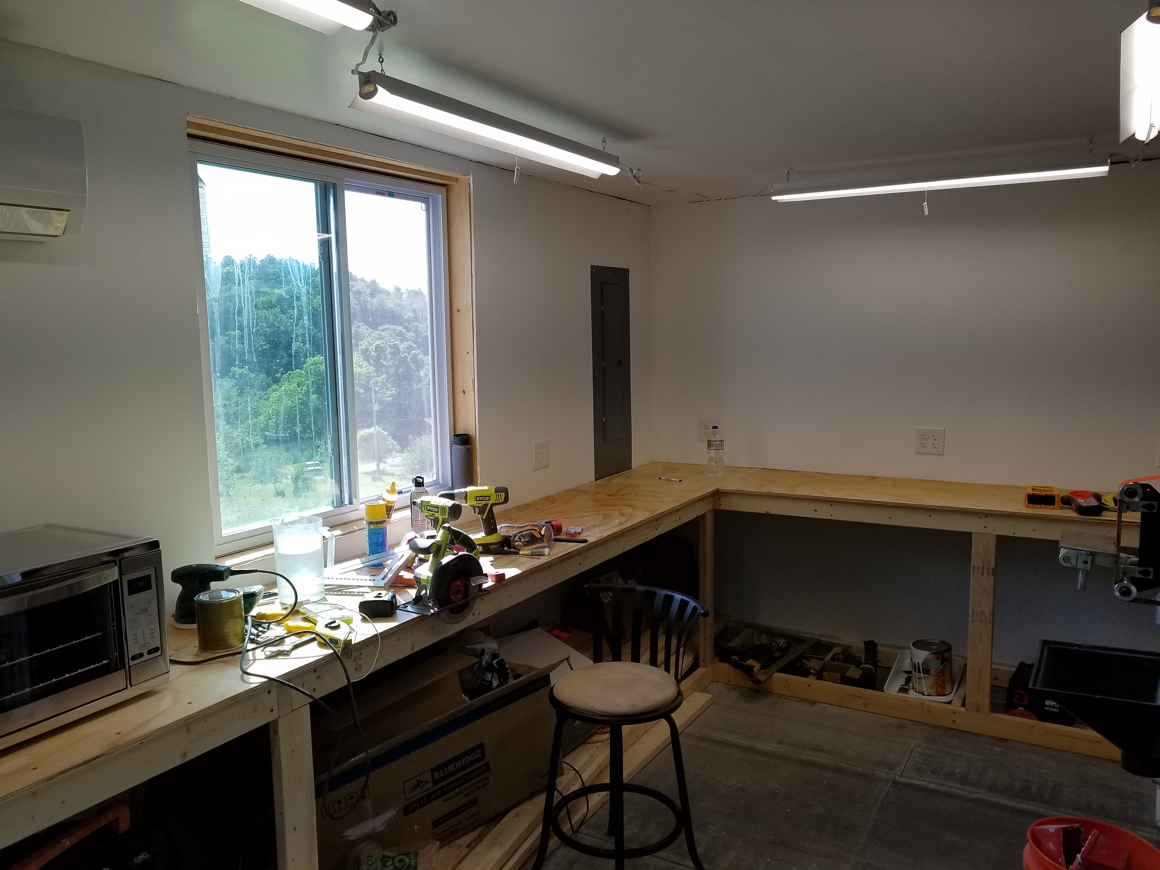

This picture shows most of my bench area. I've got 3 bench vises to play with and figure out which ones I like. I also have a Wicked Edge Pro Pack III to sit somewhere, probably in the corner near the breaker box. The bench height is functional for me both standing or sitting in a stool. I still need to figure out the organization and under bench storage aspect of things. The lighting is 4 separate 4ft LED lamps and 2 architect style swinging arm LED lights that clamp on where needed. One is visible in the next picture.

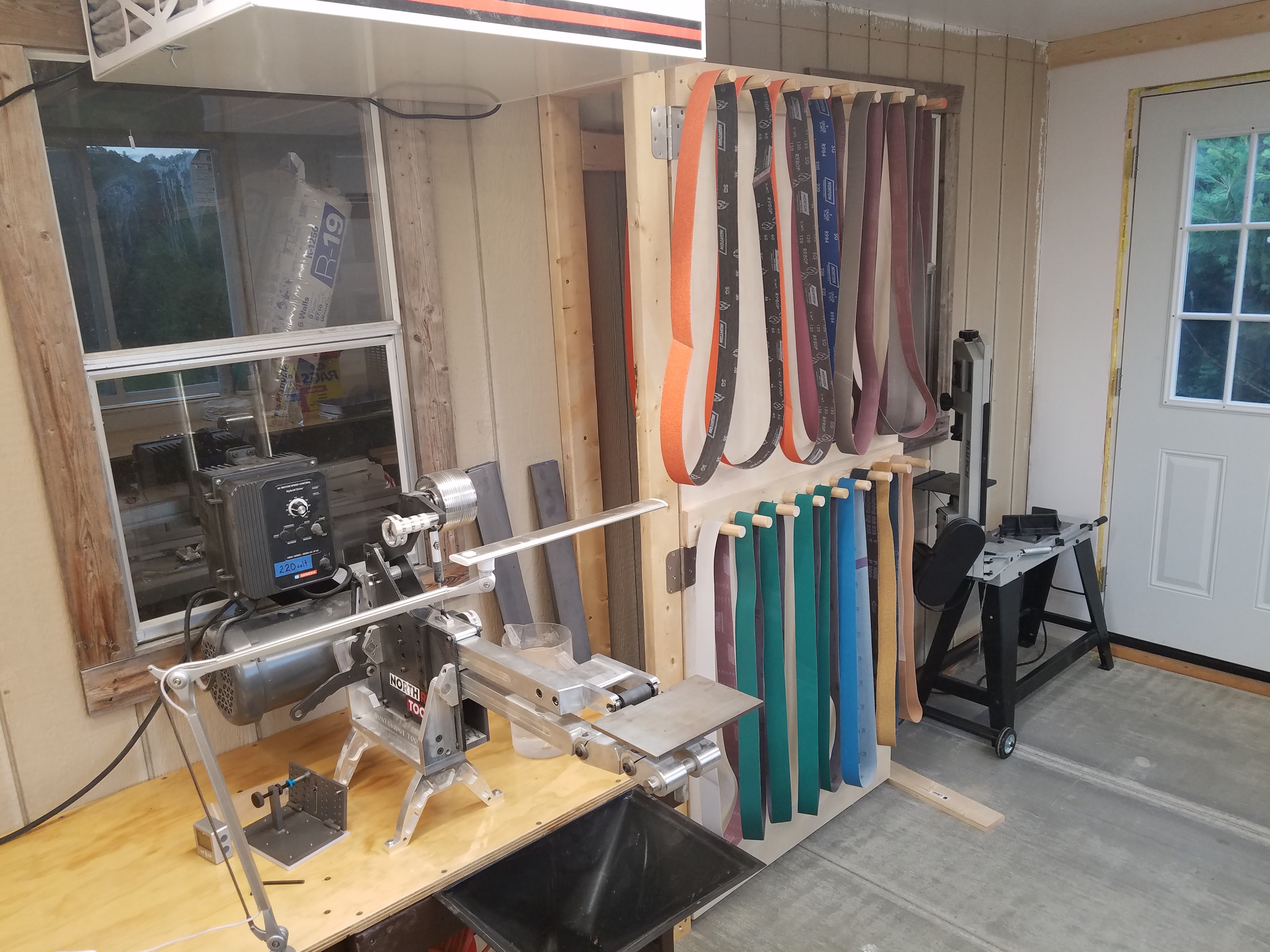

I finally decided on the NorthRidge Tool Pro Package. It came with the Baldor motor and small wheel attachment. I have a 1" wheel for now. I will probably be ordering a contact wheel from them in the near future. I called Tru-Grit and got set up with Blaze belts, AO belts, leather, and cork. I also installed a JET air filtration unit on the ceiling. It has the 5 micron and 1 micron filters... and really turns the air over. I was impressed by its power but the noise left something to be desired. I also have a 16 gallon shop vac with a HEPA filter for additional cleanup.

I would greatly appreciate any input on the bench layout, shelving, peg board, and under bench storage. I read a few threads out there with some ideas but I feel like there are more floating around. For the belts, we plan to build a hinged door/wall with pegs on both sides. It doubles the storage in a collapsable space.
I would also love to hear your thoughts on possibly venting the heat treat area. With the AC overhead, I think that area may have been overlooked in a planning sense. It would be better to adjust it now than have to do it later.

Congratulations on the new shop, it looks like it's coming together nicely!! I'm waiting on mine to show up on a tractor trailer next week. As far as layout, my personal experience says you'll move stuff around and figure out what works for you. I've moved mine around a few times now, and have a layout that works well for the available space I have maximizing usability. I'll have the same square footage in the new shop as i do this one just 8' x 40' rather than 16' x 20' of the current one. One would think that the 16' x 20' would work better, but after laying out drawings for the new one, I'll actually have more usable space and be able to work on 4 wheelers in the shop again by moving one table and a saw. I don't have a kiln for HT as of yet, I use a gas forge with thermo couple. It is currently stationary, but in the new shop (40' sea container) it will be on a small metal rolling cart I can wheel outside in the hot months and use inside in the cold months opening windows to vent in fresh air. When I finally get a kiln I'll probably do the same thing and use a rolling cart to store it on and be able to move it in or out as needed when HTing. since I'm doing all my own electrical work, I'll simply wire an exterior plug for future use. Plus it wont hurt having a 220 plug accessible from outside if i ever need to run anything 220. Anyway, good luck..
I probably reorganize my shop 2-3 times per year. Always changes with how I do things, and new additions. You'll get pretty creative on layout when it comes time to fit in the 3rd bandsaw and 4th drill press.
You're on the right track with the air filter, but I can't recommend dust collection highly enough. In my opinion 1.5-2hp is the minimum. I've got a really good setup I'm super happy with, but it cost substantially more than my grinder to set up.
Thank you for your service. It looks very good so far. I would recommend you have a way to hook your vacuum up to the black catch funnel (or better yet, get a dust collector). You definitely want to do this when sanding wood, G-10, Micarta, etc. You can also use this when grinding steel, although you would want to make a spark bong arrestor to kill the sparks before they go to the vac. Glad to see you made lighting a priority. If this were my shop, that area to the right of your toaster oven would be my go to area for close inspection of your work. you can't beat natural sunlight. Keep up the good work.
looks good ! everyone should have a window facing the bench :D i would just install a kitchen exhaust fan in the wall over the oven and make a hood. or use a pre made oven exhaust hood that vents outside.
What is your setup? I've looked at them and priced a few. I'm all for safety. Thanks.
Thanks! As far as the catch funnel, I bought a piece that attaches to the bottom. Not sure what it's called, but it has a "Y" with one tube going straight down and the other coming off the side at a downward angle. I got it after seeing some of the DIY dust collection with shop vacs, but haven't quite gotten a grasp of the idea. I think I need water in the bucket and to hook the shop vac to the tube coming off the side? The garage at my parent's home has dust collection tubing installed, but no unit. We plan to put all of that down there... eventually. As far as the window, I'm really glad I went with that size. It works out perfectly where it is, in my opinion, and offers the natural light of two smaller windows based on the location of the sun.
you can put a gate on the "y" sections and open the one to the bucket, that has water in it (and close the other) when grinding metal. do the opposite to grind non metal with a vac hooked up the "Non-Bucket" "Y". Or do a youtube search on "spark bong" and see how that works. My spark bong draws some water to the vacuum, which I don't want, but i'm not sure if that's normal. I would say it's better than running dry for metal grinding. I aim to put a "Y" on my set up and switch between the optimal set ups for steel and other materials.

Here it is. The dust chute is something I welded together. The sectioned elbow is enough to keep the sparks from hitting the hose (standard dust collector hose) and I've been running it this way for over a year without any trouble. The key is having enough airflow to keep things moving. I put the screen in the chute to keep it from sucking my belts up (which it otherwise did regularly).
The dust collector is the standard sort of 1.5hp metalworking dust collector sold by the various chinese/Taiwanese tool importers (grizzly, ect. Mine is a Canadian dealer). The motor and switch don't look right, but I swapped it over to a 120 motor (sold 240 only) due to a lack of spare circuits. It draws enough on startup to trip a 15 amp breaker unless you plug the chute with something like a board until it gets up to speed. The 6" line is 10' long, and is a massive improvement in flow over 4". I have it direct vented outside, which made a big difference too. I'd want at least a 2hp collector if I had to filter it.
I also find that pouring a couple inches of water in the catch pan will keep most of the dust in the collector, as well as making collector fires much more difficult.
I'd also recommend cutting out the screen on the inlet to the collector. Before I did that a big ball of grinding dust somehow built up, and started restricting flow to the point dust built up in the hose. That dust eventually caught fire, and the sparks off it (stainless ground on 36 grit burns like steel wool) ignited the ball in the inlet.
I'd highly recommend having a CO2 extinguisher in the shop, as they make no mess, and dumping one in the dust chute will tend to kill a collector fire pretty quick. But if your system is put together properly, and you make the modifications I suggested that will never come up.

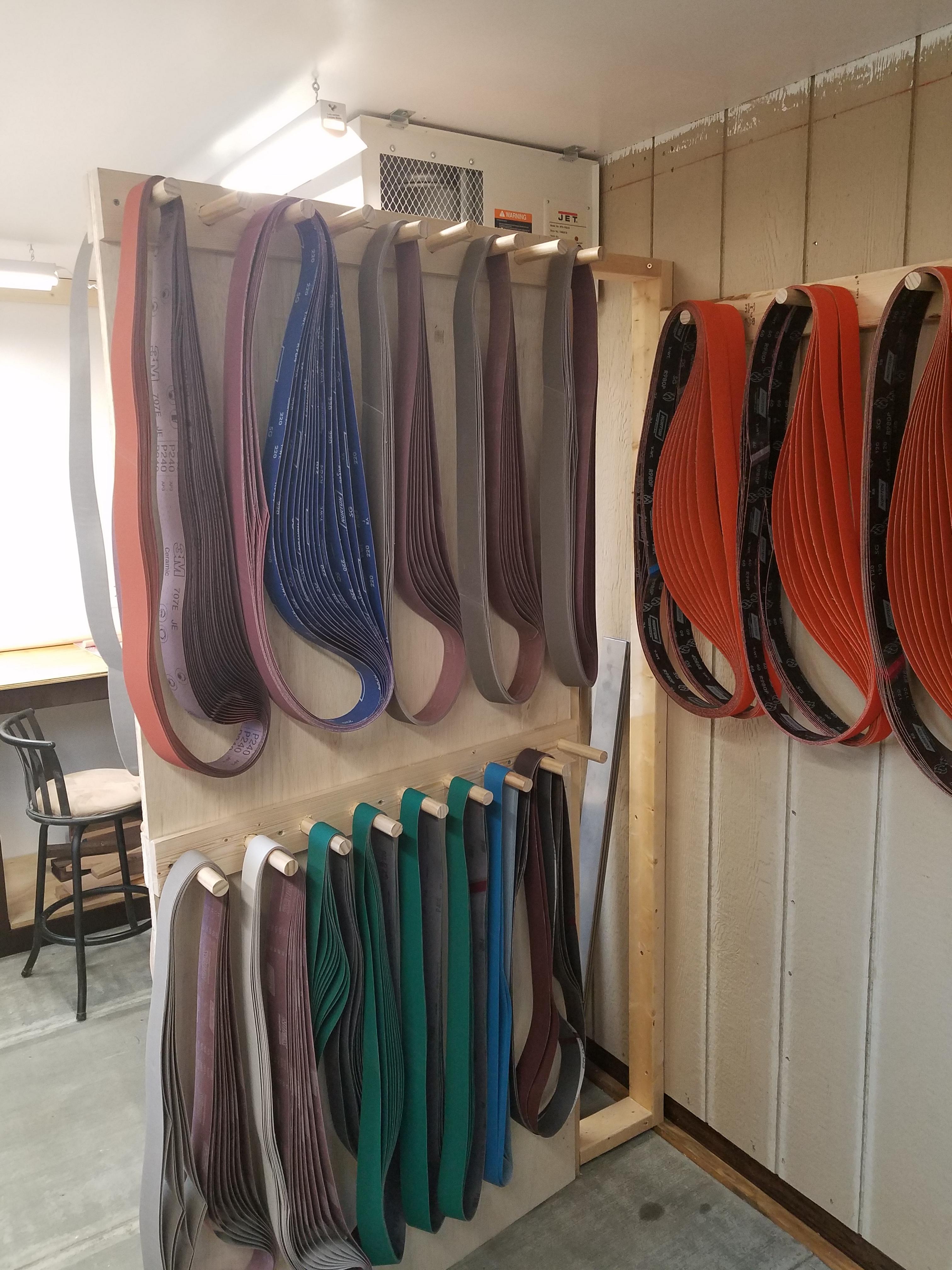

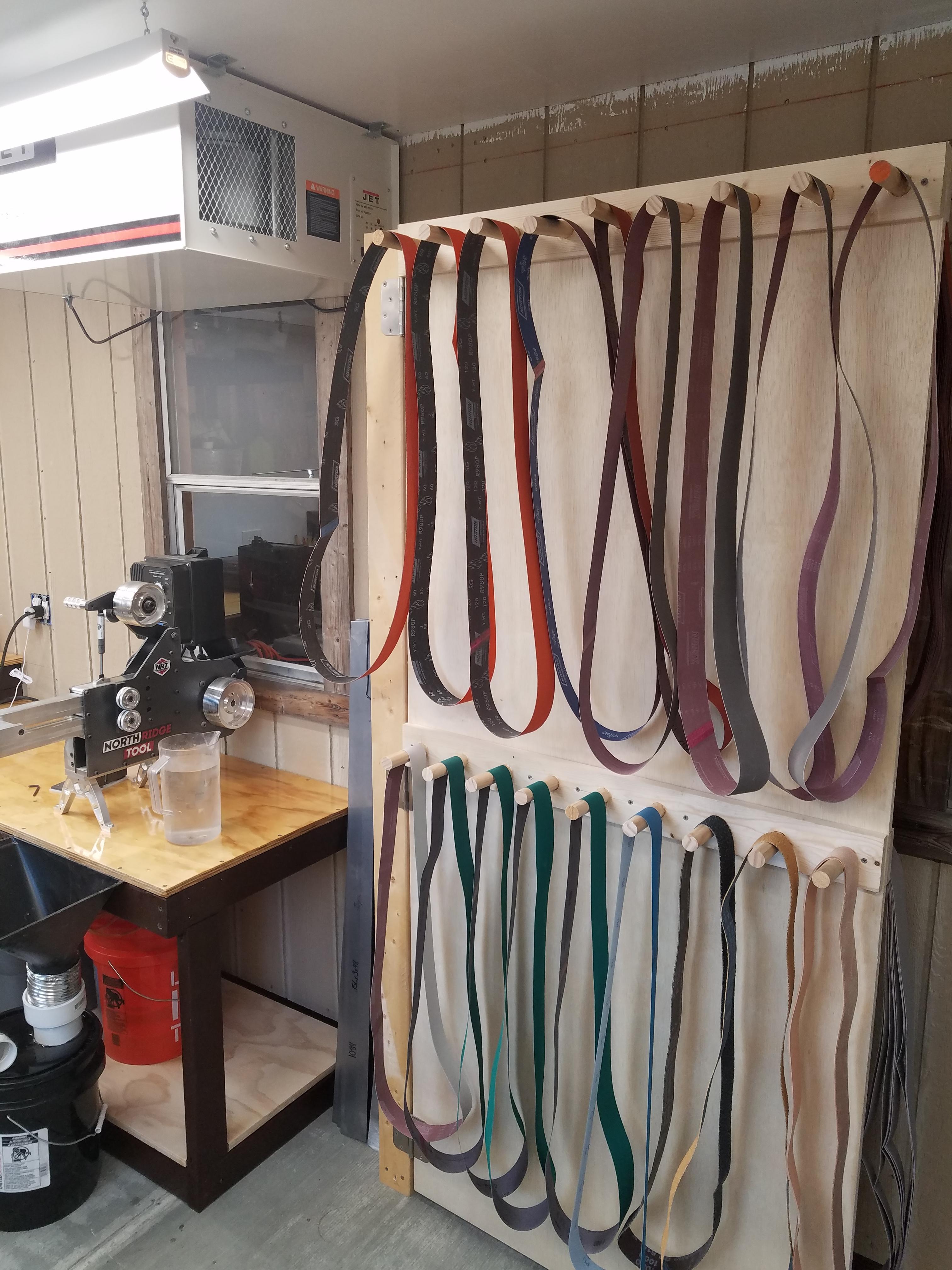

I browsed shop organization and belt storage threads on here. This is the best I could come up with considering the wall space I had... it basically tripled it. Just a piece of 3/4 BC on 3 hinges. I still have to make a contraption to keep it in the closed position when I want to. Also got the spark arrestor built. Seems to be working without any issues. It's pictured but the vac isn't hooked up.

I see a lot of folks hang all their belts on the wall.
Consider this
They are not jewelry, no need to put them all on display, just what you need that day.
You will get grit contamination of larger grit debris on the finer grit belts that will cause unwanted scratches.
If your shop has humidity issues, you're aging the glue joint to fail before it's time.
Consider putting them in a pail that seals out the dust and humidity, sorted in pails by grit.
It keeps them clean, dry and organized.

I was planning to close the backside and wall parts in like a cabinet and caulk it/use weather stripping to keep the dust at a minimum. Good idea with the bucket though.
I hang my belts on the wall, the workbench, the drill press, the welding cart, the floor, the ceiling, the deer horns.... Your system is nice.
Jason, that sounds like me. I have belts everywhere. Even though I know some are worn out, I can't seem to bring myself to throw them away.
To the O.P. you're looking good. One thing I see missing is a vise. Next to the grinder, that's probably where I spend the most time. Pay attention to location. I like having mine mounted to a 2x8 that sticks out from the bench. I've also used 6-8" channel in the past if you really want it stiff. That way I have access to both sides of the vice and it allows me to mount items in it that hang down and don't hit the bench and is perfect for the long hours of hand sanding ahead of you.
