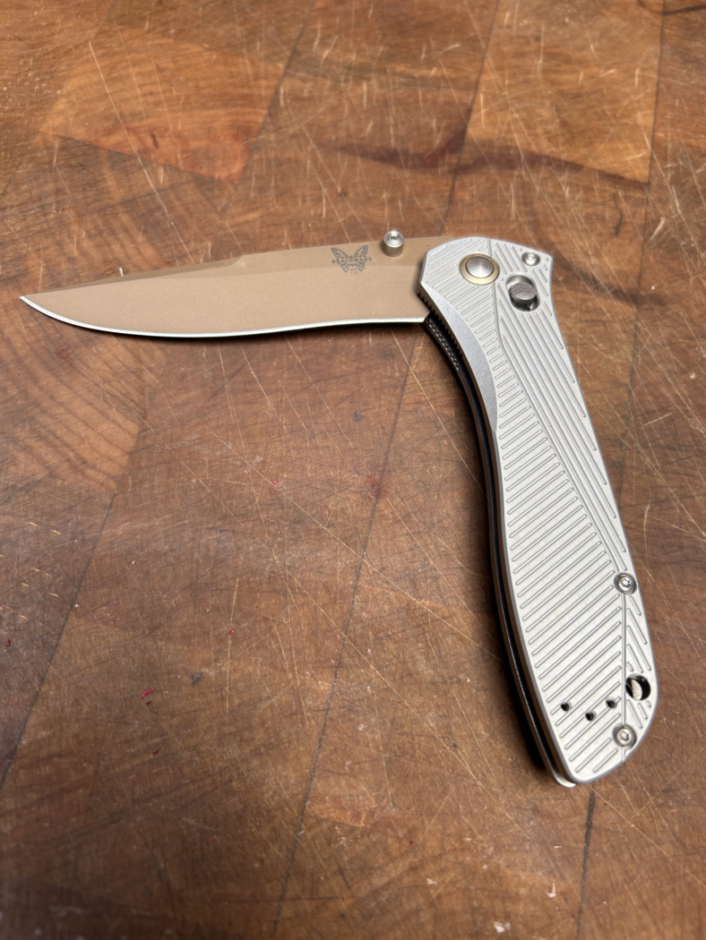

I'm loving the new Benchmade 710 in S90V steel. The edge from the factory is just over 17 thousandths (0.0175 inches), and the spine starts at 0.115 inches. It's an excellent slicer, despite the saber grind and the narrow blade.
Sabre grinds can be fine, it all depends on the overall grind geometry.
That looks great. Glad to see the 710 is back. I would have been very happy with an edge like that.
