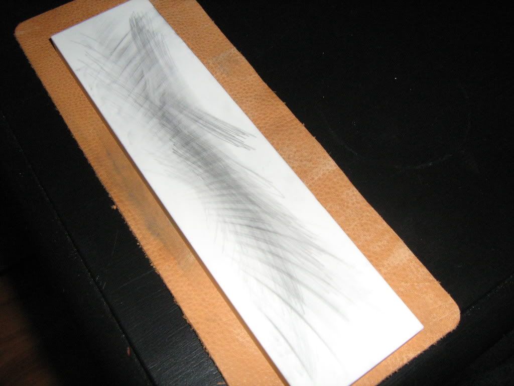

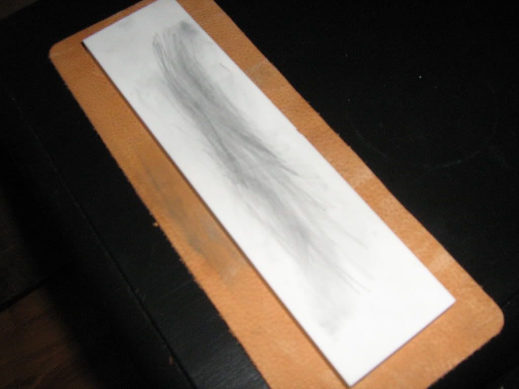

The lapping marks on the stone are normal though extremely annoying. I lapped my UF stone when I had it and it made an amazing improvement. By lapping the ceramic surface you are changing the texture of the surface allowing it to be coarser or finer depending on how it was lapped.
I left one side factory on mine and used it more like a dual sided stone. I remember the lapped side producing one of the finest finishes I have seen from a stone. Actually, here are some of those old photos.
Factory side,
Lapped side,

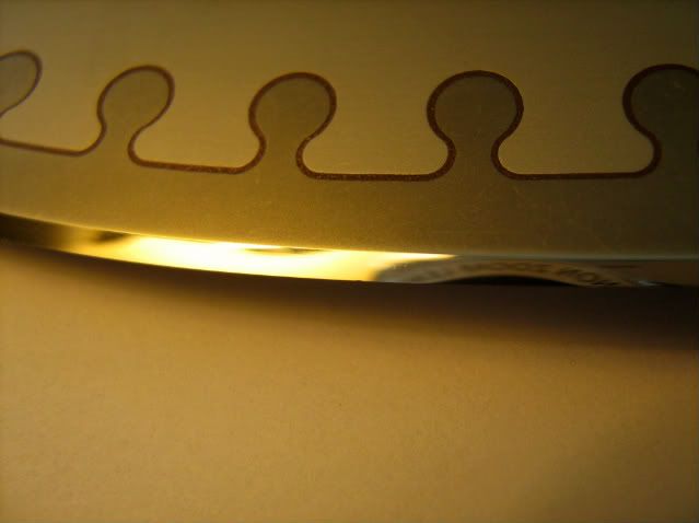

Finish from Lapped side on CPM-D2,
Here is what it really looked like,
Factory side,
Lapped side,

Jason...that pic is almost identical to mine. Of course, I don't have the large one, but the swirl pattern....that's it! I think I will do as you did....lap one side only.
