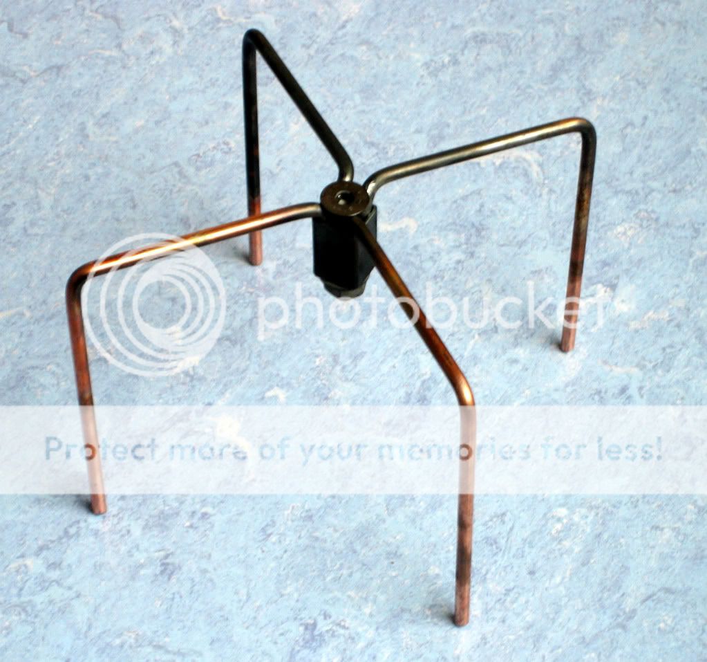

I have this in my head for few months. The idea finnaly became complete and I realize it. Here it is:
Folded. You dont know what it is?
Unfolded. You still dont know? Oh, you know!
Yes! It is foldable something for put pan on it when cooking in fire!

I am sorry if this is an ignant question - but will copper be able to stay firm under a hot wood fire? Is there any threat of bending?
TF
It is not copper, everything is steel.
Measurements: 16 mm square pipe, 5 mm legs (wire for acetylene welding), 8 mm screw. Of course, you can make it bigger (and heavyer :))
Where did you get that or how did you make it? I want one! :D:thumbup:
Very cool, Samek. This would be great for car camping. I'm saving the pics to try to copy this.
