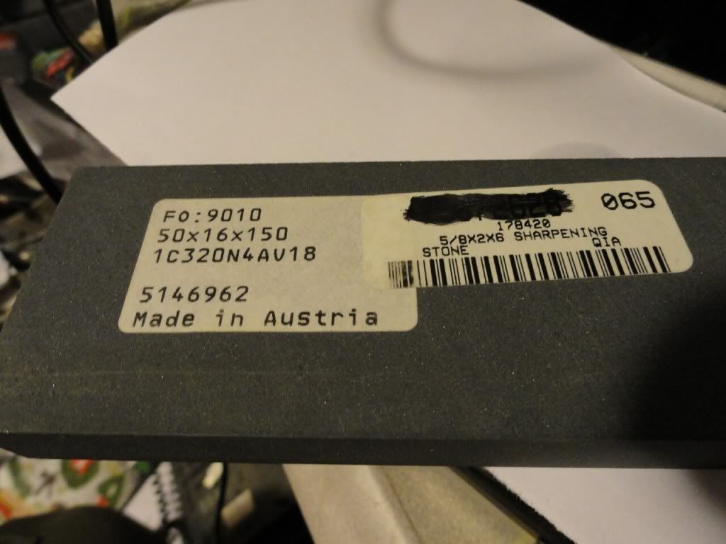

I'm new to this forum so please bear with me :-) I'm scoutmaster of my local boyscout troop 31 here in Rochester, Mass. I recently purchased a box full of, I assume, Arkansas sharpening stones for each of my scouts from Ebay. The stone all appear natural, and have a sticker on the bottom stating "made in Austria" with some numbers on the label as well. The stones are all brand new as well.

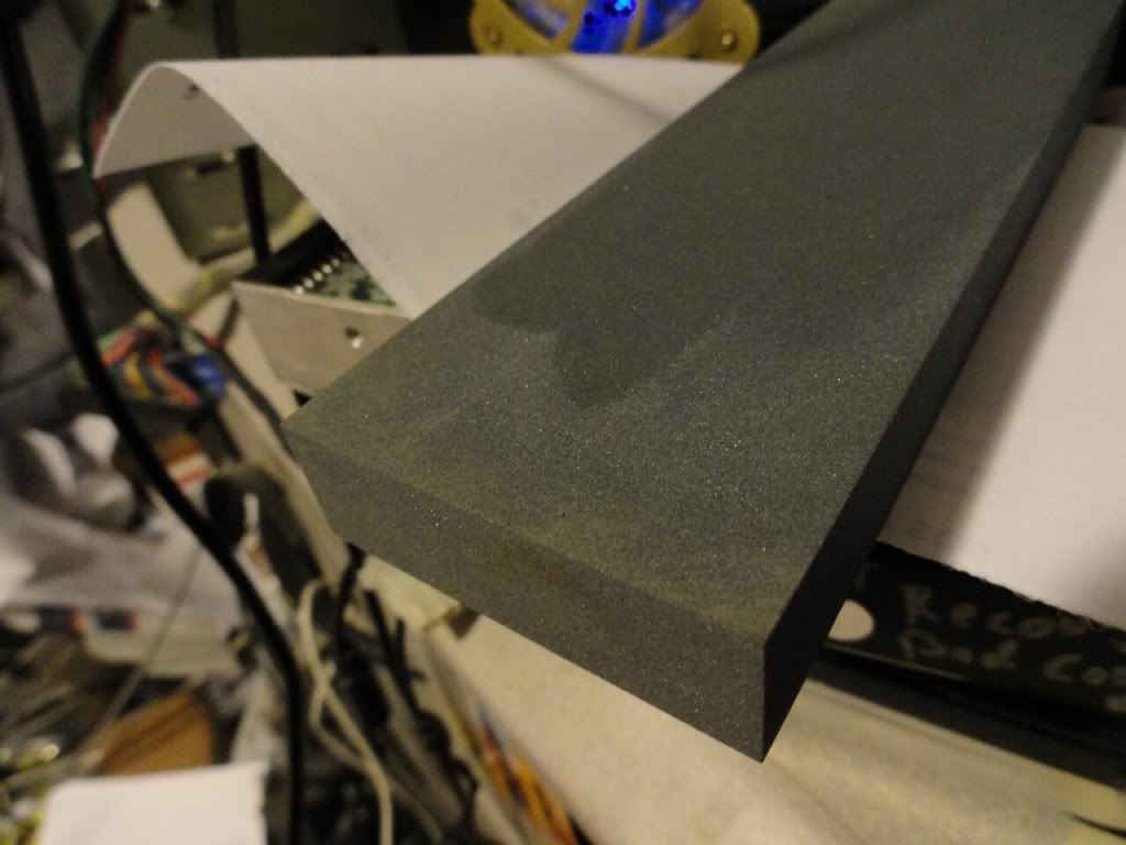

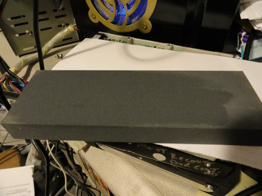

Here are some closeups of the stone. The "wet" looking part is where I put some oil and it just absorbed it right up.
LOL, my son's half convinced that if he were to throw one of these stones into the ocean that it would suck up all the water in the ocean ;-)

After looking at those pic's I'm going to stick with my original guess. To me they don't look like a natural Ark stone and much more like a aluminum oxide stone, and I'll also stick with the guess of about 300 grit.
If you want to keep one in oil to see how it works feel free but don't limit yourself to just that method. Those stones will also work dry or with water like a waterstone. For the scouts I'd probably show them how to use it dry or with water, that way if they don't have oil sharpening will not be a issue.

Using the dry may clog them over time but because of the grit and type of stone I doubt it would be that much of a worry. Using them dry may produce a dust on the surface that needs to be wiped regularly though. If used with water that dust will become a slurry that aids in the removal of metal and cloging becomes a non-issue. If used with water the stone will need to be soaked for a few minutes and constantly be splashed during use.
The stones are going to leave a rougher edge but one that can still be very sharp with practice. Good luck and let us know how it goes.
