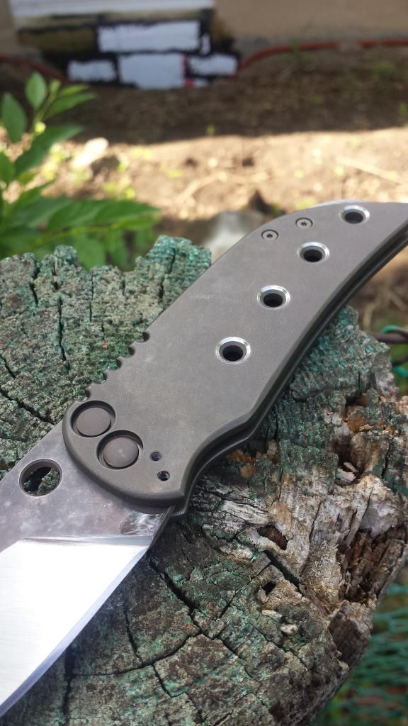

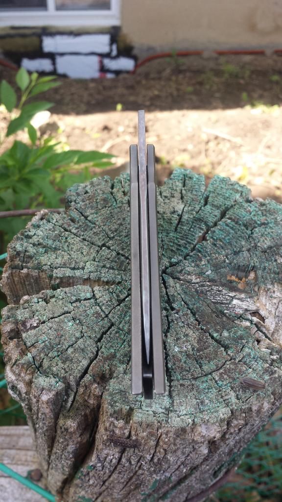

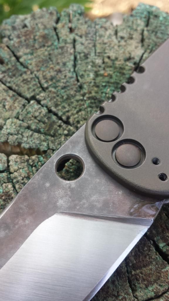

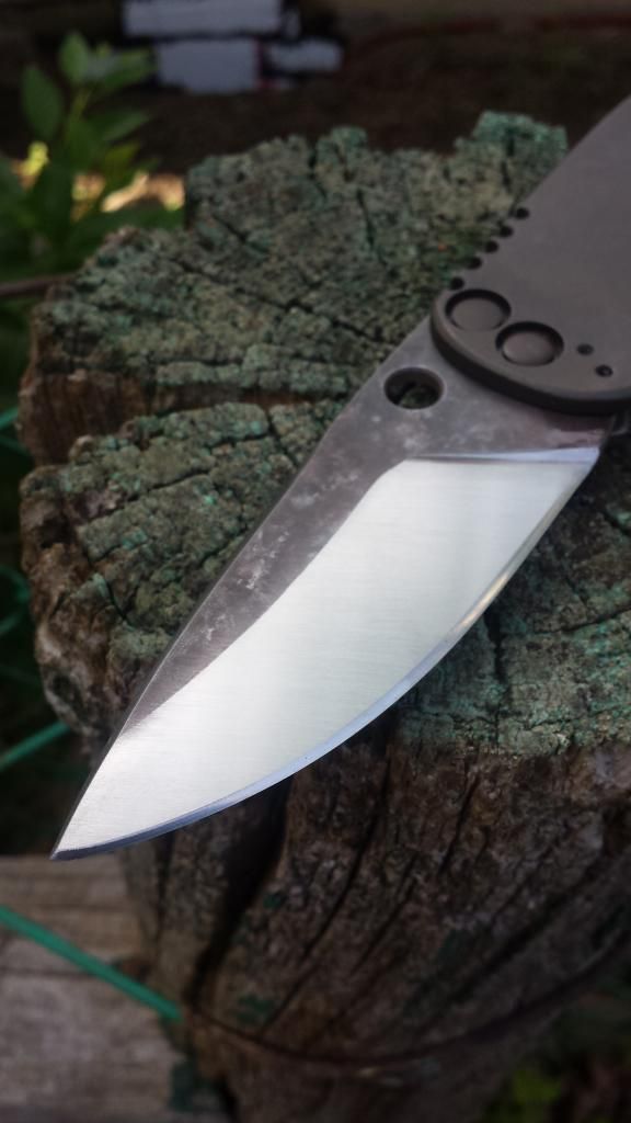

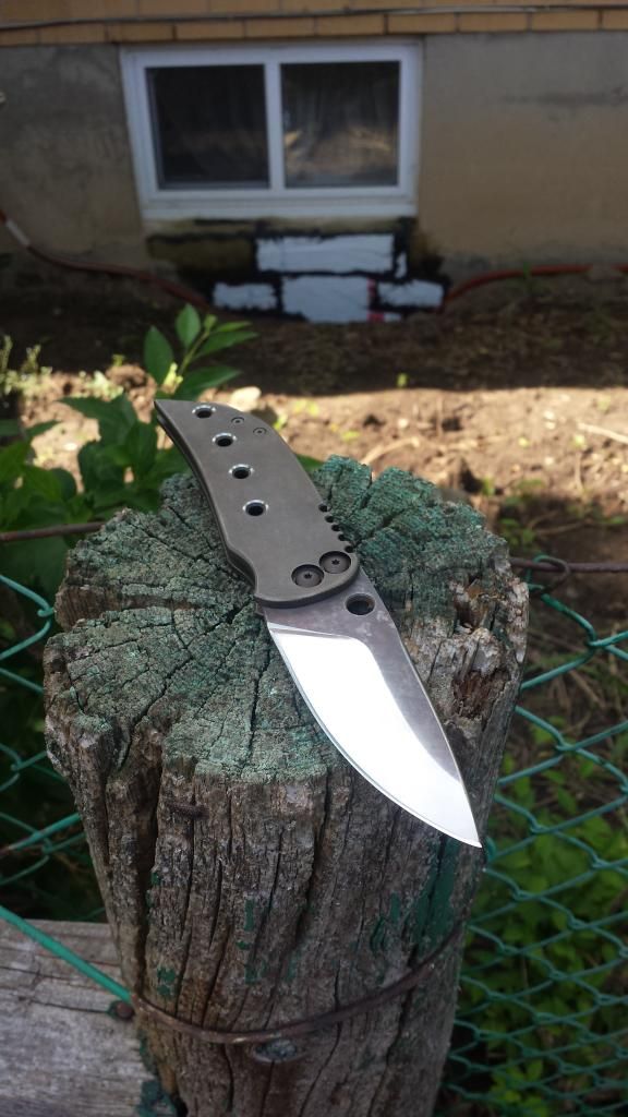

This is one of my Gen 2 friction folder. Full TI handles. It has two tone holes in the handle. Titanium has been orange peeled and sandblasted and stonewashed. Then heat anodized a dark bronze. Blade was acid washed, stonewashed, copper washed and satin grinds. Hardware was been sandblasted and bronzed Only flaw is the pocket clip screws. Tapped holes in the handle I think stripped a bit and won't hold a 2-56 screw tight enough. This knife originally had a damascus blade but because the damascus was poor quality I bought the knife back and put a new blade on it.
Blade thickness .123.
Ti handles.
Ti thickness .137.
Damascus backspacer.
Blade steel is n690.
Weight is 5.8 oz.
Blade length 3.4 inches.
Ti handles.
Ti thickness .137.
Weight is 5.8 oz.
