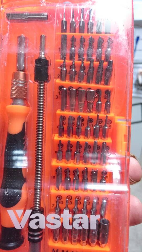

Speaking of tools, I received one of these sets yesterday. I won't need all of these for my knives, but the T6 and T10 have come in handy for my Buck, and I'm sure for my mini griptillian and others. They all have those hex screws.
