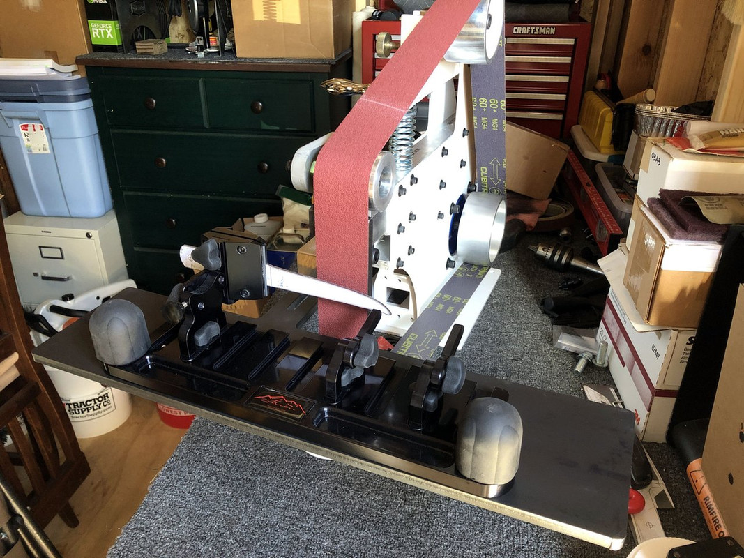

Excellent instructions Mr. Apelt. I have not yet commenced my first knife making endeavor but while I had a general concept of the procedure, your write up has answered many questions I had.
I purchased a Pheer grinder about 7-months ago and I've spent some time having it painted, and I reassembled it replacing all of the nuts and bolts with black oxide coated stainless steel socket head cap screws, washers and nuts, and I had a more substantial 3/8" thick work table made for it. It has not yet been switched on and it will be a while before I ever grind anything as it often takes me some time to get things finished. Nevertheless, my goal for my first knife making endeavor is to make (4) 6" Kitchen utility steak knives from 1/16" 1084 that I purchased from Alpha Knife Steel, that will be sent to Peter's Heat Treat once profiled and thereafter I will attempt to grind the bevels, add the Micarta handles, and finish the knives, following your instructions.
This is a photo of the 30-year old kitchen utility knife I am hoping to recreate along with the 1/8" mild steel template I created that I need to finish profiling.
And this is a photo of my grinder, work table, and Moen grinding fixture (that I purchased prior to reading your advise elsewhere to learn to grind freehand, first...), with the kitchen utility knife template clamped in for the sake of the photo.
I am not sure when I will commence the work - I move slow - but I will be referring to these instructions when I do.
