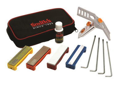

Get a manual fixed blade sharpening system that works for you first. Something like this, you can learn on. People kept telling me to learn free hand. I personally can’t tell the difference between 17deg and 20 degrees using my hand. I’ve fixed several knives that people free handed, that “knew” what they were doing. With a fixed blade system, I could see how uneven and inconsistent free hand was for me and many others. I can get any normal knife I use daily, more then sharp enough for normal tasks. Diamond stones are the most consistent when I checked them when switching stones. Sharpening snobs told me it wasn’t good enough, however it works good for me and I’ve never had a complaint from family or friends I sharpen knives for.
