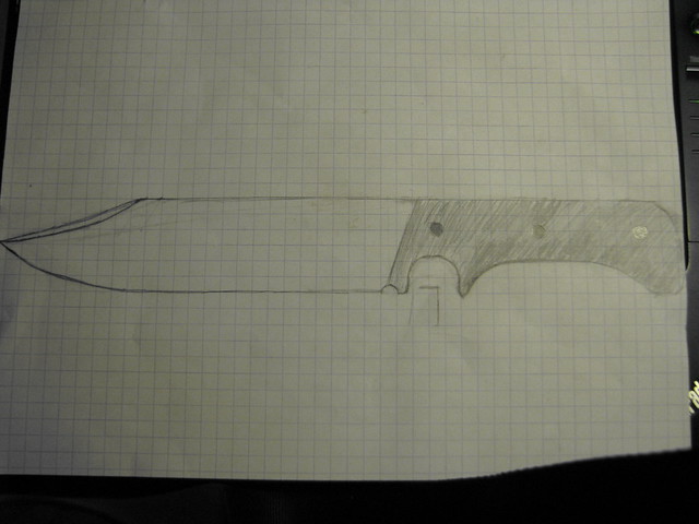

i would agree, except remove the swedge on the clip point and even out the handle. that finger in the middle will probably just get in the way unless you are holding the handle the one way that it works. besides, it will be a pain to grind the handle around it. as for the swedge, it just ads an extra hassle. if you really want to do it, go for it, but it might be a good idea to go for something simpler first. just a suggestion.
