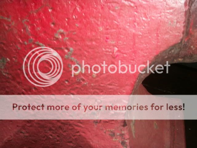

just picked up a long desired item.An anvil.Had a few questions i was hoping someone could help with.
Any ideas on what brand it is? I just figured it was cast iron or wrought iron base with a hardened steel face,am I right?
The entire thing is covered in paint,i was going to use a sanding block on it.what grit should I stop at or is there a better method.
What is the hole in the body for ? A manufacturing thing or is it for use ?
I take it that the 21 stamped in is the weight in that funny english system,what does it translate to in lbs.?
Iv'e been off and on lusting after an anvil for some time,have done some research but this was kind of a last minute buy.This anvil practically throws the hammer back at me when i tap it. I got it for $255 on Ebay. So am I a champ or a chump.
Looks like your a champ! Not sure, but I think it's a Peter Wright too. The holes in the top are the "Hardy" (the square hole) and the Pritchle (round)...used for tools and things. The hole in the body/waist is what they used to grab it with tongs when being made.

Looks like you got a GREAT BUY! As good rebound as you say, looks pretty clean no large bits missing or weld repairs(like mine hehe). I agree with Mace looks like a Peter Wright. Use a dust mask and flap disc at 80 or 120 grit to remove all the paint, and then you might find the maker's marks stamped in.

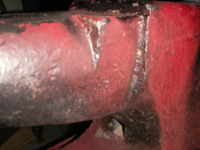

If the numbers are raised, you have a cast body anvil and the number is expressed in ten pounds. Have you got a picture of the stamping?
Second picture shows the stamping,lower right of picture.It is stamped in and not raised.I put some wire brush time in to clean off some of the layers of paint and have not yet found any other markings.
Oh, yes! Now I can see it...
Is that a dot bewteen 2 and 1, or just a spot in the paint?
I really think could be the weight in stones, then. Even if it looks a little small to me, to weigh so much. But I could be wrong. I'm used to the italian pattern anvil, so I'm not good at judging london pattern anvils.;)
