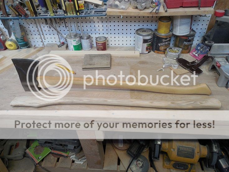

Well I found this rusty old axe at my house.. I cleaned it up and started filing on it to try and shape it up a bit. It turned out and I put a handle from the hardware store on it. It was sloppy going on, and upon further research it seems they need to be tight before the wedge is driven in? Mine had probly an 1/8" gap prior to the wedge :thumbdn:
I shoulda done my research but first on hanging an axe, but this is how I learn....Everytime.. Thankfully I didnt hurt my stupid self..
Axe says H | B on it, made in Sweden. and the other side has what appears to be a fraction.
Hopefully I can get a proper fitting handle and it will be better.. I may have missed on one swing, but is that enoug to destroy a handle??
I think they call that 'run-out' where the wood grain traverses the handle instead of running parallel. Glad you discovered the flaw the way you did and not some other way that might have been more dangerous. They don't make axe handles like they used to!
The head looks to be in excellent shape and the poll end was not used as a hammer like happens to so many of them. Nice to see you aren't sharpening with a grinder that takes material off too fast. The fraction stamped on the head should indicate that proportion of a kilogram (2.2 lbs) that is the weight of the head.
Judging from the way it looks in the pictures the haft you used was probably to blame for it breaking like that. On the bright side though an axe head with an HB stamp that says made in sweden is most likely a hults bruk which is a quality euro axe manufacturer, nice score.

It's the handle's fault- the grain was not what you need in a handle. Look for handles that have grain running from one end to the other, unbroken. Also, the best handles have grain running in parallel to the bit of the axe, not diagonal or horizontal. Sometimes, a handle just has a fault in it that will cause it to fracture.
As for wedging- no, if the handle only fits in the eye when the kerf is closed, you have not taken enough wood off the tongue of the handle. Your kerf should be slightly open. Otherwise you won't be able to fit enough wedge in the kerf. I, and a lot of guys, don't even saw our kerfs until after we've fitted the handle to the eye.
Try it again with a more ideal handle. And yes, you can split all day with an axe- if you know how.

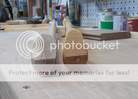

I got my Council Jersey in the mail and the grain was just about as wrong as it could be. I went to several hardware stores until I found a handle that would do. Here's a shot of the bit on the handle it came with next to the new handle I found.

They don't usually hand select handles for their standard grade stuff. I knew the risk when I ordered it. I'm not bent out of shape over it and now the axe is a little more "mine". Now if my velvicut had arrived with a similar handle there would have been some hollering.
And now I also have a perfect new handle for my shed door.
If you're happy, that's all that matters. That truly is the worst possible grain orientation though, ugh.
Pretty sure I've seen those sub par hardware store handles before. Grain aside, the wood is simply terrible quality. It also looks like there's some super funky changes in grain direction that cause the run out on that one side. These handles are plank sawn and then routed to give them curvature, rather than turned on a lathe. Check out Hickoryhandlestore.com or any of the other handle suppliers mentioned elsewhere on this forum for good quality handles.
