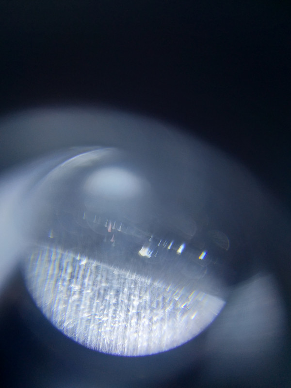

New to stropping, should it take so long?

I sharpen my knives almost exclusively on a King 1000/4000 water stone and have been deburring by simply drawing my knives through a piece of wood up until recently. Just picked up this cheap piece of leather with honing compounds for cheap on Amazon and have been using it to deburr my knives. I also picked up a 30x jewelers loupe to inpsect the wire edge as I'm stropping and it seems to be taking a considerable number of passes to get the wire edge to vanish assuming I'm looking at the right thing. I'd say I spend about as much time stropping as I do actually apexing the knife. Is this normal and if it is, why is this method of deburring so popular when much quicker methods of deburring that produce an adequate end result exist such as drawing the edge through wood?
Stropping should never take more than a minute or so, or even down to 3 - 5 passes per side, total.
Something's not right. Either there's actually no burr, or the compound used isn't working at all. What compound is it?
Most importantly, how's the edge cutting? I don't like relying solely on visual checks for the presence of burrs. If you're looking for reflected light from the apex, a tiny microbevel or a rounded apex can reflect light in the same manner. If the edge isn't cutting paper at all, for example, I'd bet the edge isn't fully apexed, or it's rounded off. If it cuts paper somewhat, but snags and/or slips while doing so, there may be a partial burr or a folded burr. But again, if stropping isn't changing (improving) that behavior, the edge likely wasn't fully apexed in the first place. Best approach is to test cutting coming straight off the stone, before stropping at all, and then see if cutting improves with stropping. If stropping isn't changing or improving it, the edge likely needs more refinement on the stone first, to a full apex.
Another possibility might be if the burr is extremely thick & heavy. If so, it should be very easy to feel with your fingertip or nail. If the burr's that heavy, it's an indication pressure is much too heavy in the finishing strokes on the stone, causing the edge to effectively 'roll' over in the same manner a burr would, but much too early with the heavy pressure. If the compound isn't very aggressive for the steel, a very heavy burr may not respond to stropping.

It cuts paper fine. I use newsprint as my test medium and it slices that up no problem. As per testing right off the stone, I've been doing that for a while and simply pulling the knife through wood when the cut is to my satisfaction. The knife isn't "treetopping sharp", but it's sharp enough for me to take my sideburns off with no irritation. Cutting did improve after stropping, but only after several passes. Then again, I wasn't testing while stropping and simply using the loupe to inspect the edge as I stropped.
As per steel, edge profile, and compound, it's M390 with a slightly convex edge (as mentioned, I exclusively use stones for sharpening and grinding) and the compound is "green compound" which I assumed was CrOx. It is possible that it's some other "green compound" that's even less aggressive than CrOx if such a thing exists.
As per what happens when I strop without compound, I haven't tried it, but I don't imagine it would deburr any quicker than with compound. I'd have to run it over my stone again to test this out at a later date.
I'd skip the green compound entirely, for that steel. Green (chromium oxide) works well with simple carbon & low-alloy stainless (420HC, etc), but won't add much refinement to more wear-resistant steels like M390 or anything else with much carbide content. Both chromium carbide and vanadium carbide are harder than CrOx compound, by a pretty significant margin. Diamond/cbn will work much better for those carbides, especially if vanadium content is ~ 3% or more (M390 has 4% vanadium, not to mention it's chromium at 20% as well).

Quality is bad because it was tough balancing the loupe and my phone at the same time to take the picture.

shadow, try a stropping motion on a x fine diamond stone and see if those glitter spots come off. DM
