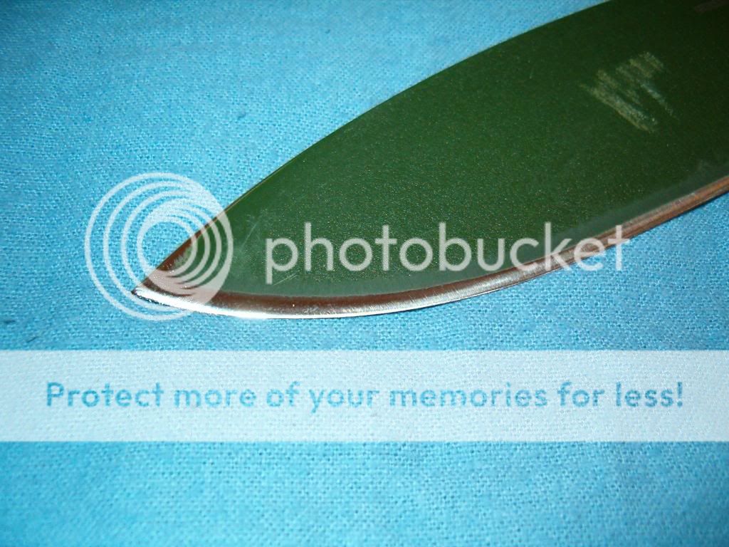

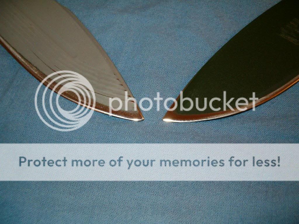

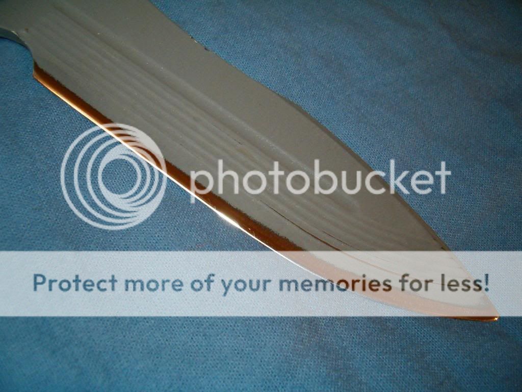

edit to add:

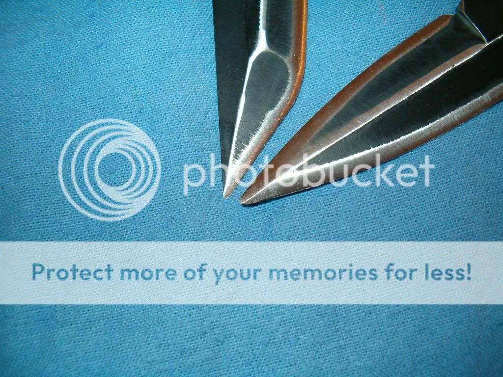

despite what i said previously, i ended up sharpening a couple of my Busses that needed it (by that i mean could have used a little touch up). didn't do too bad. they're sharper than i could ever get them previously and now and shave at a light touch. the HR tip was already rounded from a lot of throwing and sharpening, but i did both of the tips by hand to avoid rounding them out even more.
used the good lee valley belts on these. 20 micron, 9, and then took it to some 2500 grit sandpaper by hand, stopped with green stuff, then back to the sander with a leather belt.

Excellent little toys and great for convex edges. Be careful though if you haven't used one before. They take metal off surprisingly quickly and it's very easy to take the point off your knife - ask me how I know :rolleyes:

on edges, USE LIGHT PRESSURE and dip in water frequently to avoid messing up the heat treat. Also move your body not your arms (keep arms locked) when moving the blade across the sanding belt, that gives more control.

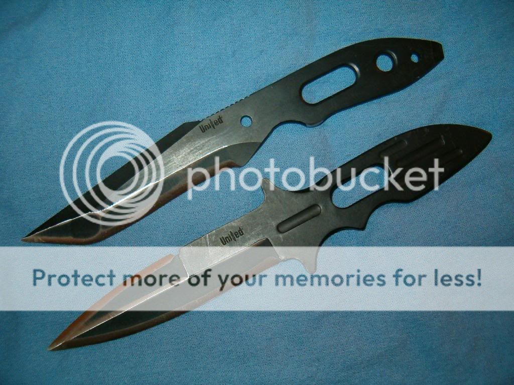

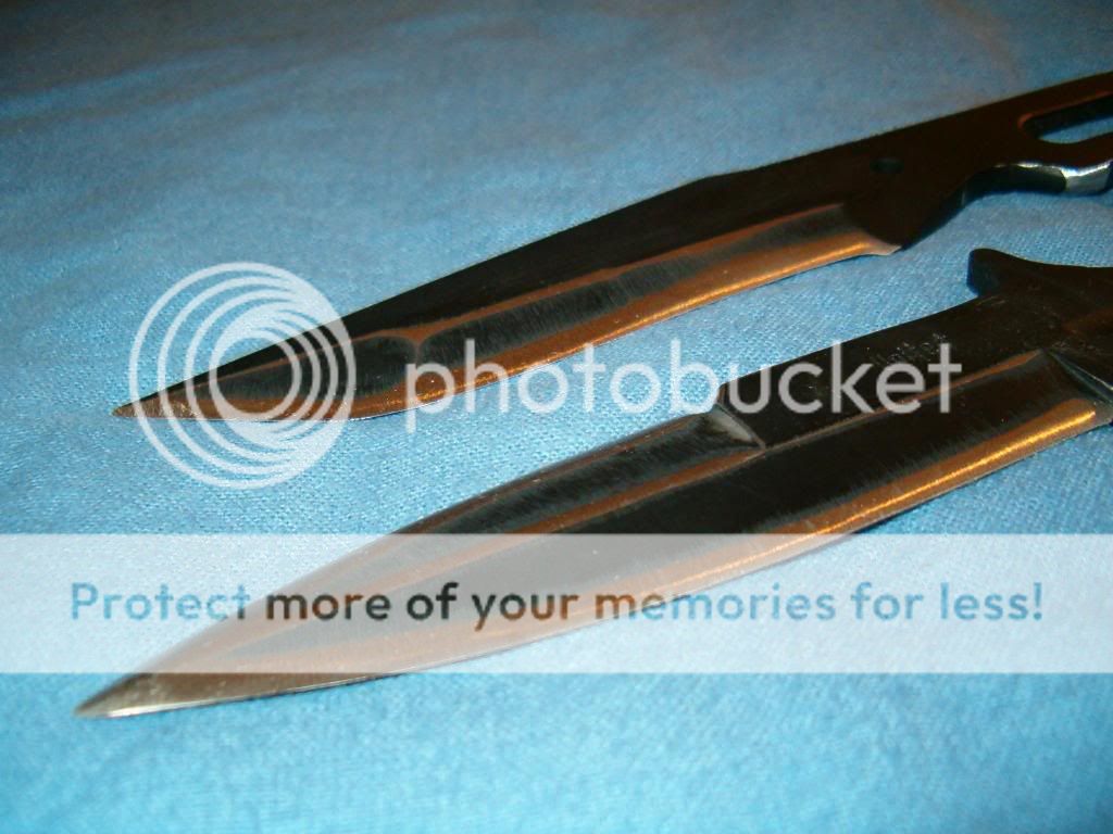

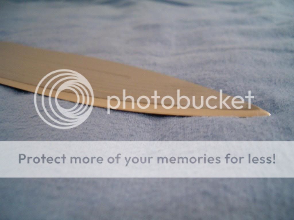

well, practiced sharpening a couple of cheapo knives, and the edges didn't turn out too bad (for a first try), but i killed the tips. 'twas inevitable though. i normally end up rounding them out a tiny bit when sharpening by hand. the problem i was having was that i wasn't getting all the way down the the edge near the tip and increasing the angle until i did was when i lost the tip. guess i should just wait to do that part until i get to higher grits. i was using a cheap 120 grit belt though (got a bunch for practicing).

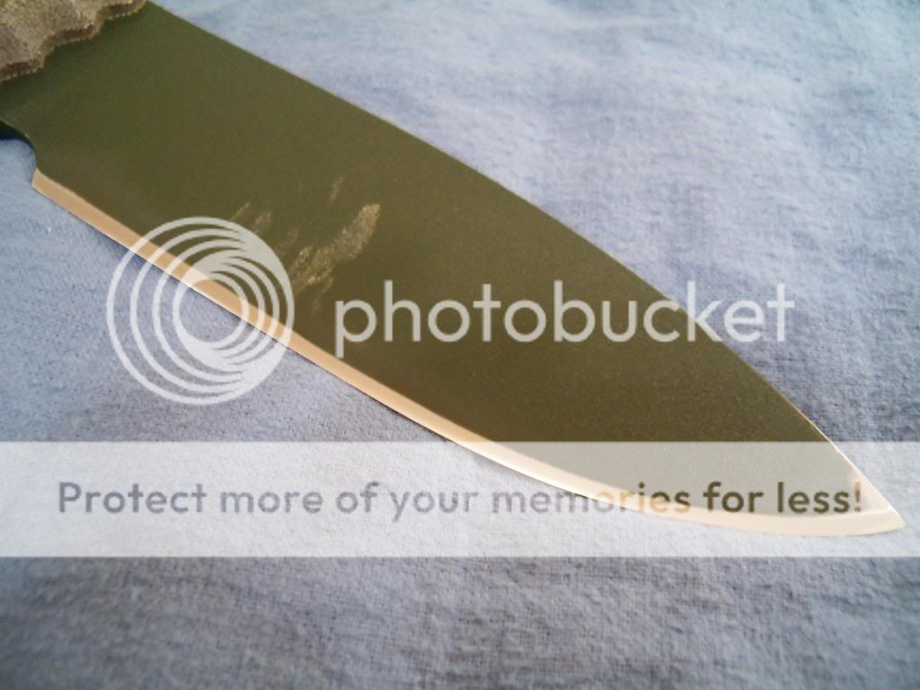

after that i went down to 80 and took the rear talon hole off some ASHs: http://www.bladeforums.com/forums/showthread.php?t=616255
i used one of the higher grit lee valley belts for polishing up that area, and noticed that the thinner belts twisted a lot and very easily. guess it wouldn't matter for the edge much though as it would keep it level.
like Rat Finkenstein, i'll be sticking to hand sharpening my Busses for now, except for the strop since i got a leather belt.
Very nice. Can you get a belt for those that will buff out scratches?
