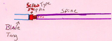

What I came up with is a sliding spine thats made out of Ti.
Instead of a sliding spine...could you have a screw type stop pin that screws into the end of the spine? You could then screw it in, or back it out to adjust....The tang of the blade would rest against the 'head' of the screw....(kinda like this...ignore the quality, I just grabbed my little girls markers and doodled this up...)
I'm sure it would have to be specially hardened, and the threads might be a problem, they might get damaged from the stress of the blade striking the stop pin...
Just showing my ignorance....

I was remembering how some of the machines that I ran,(In the furniture factory) used a similar screw set-up to make adjustments...
Some of those machines cycle thousands of times a day....so I thought...
I hope I wasn't stepping on any toes......
