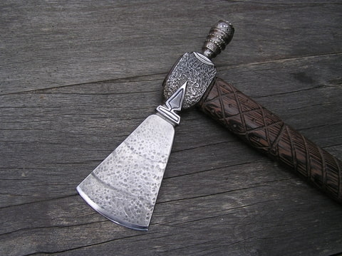

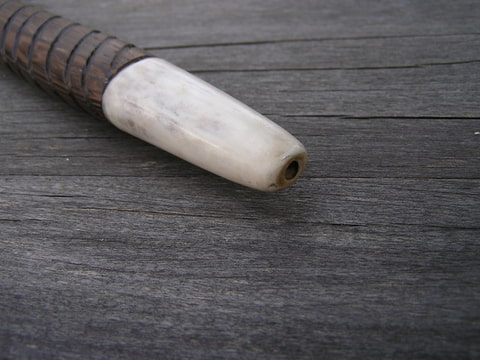

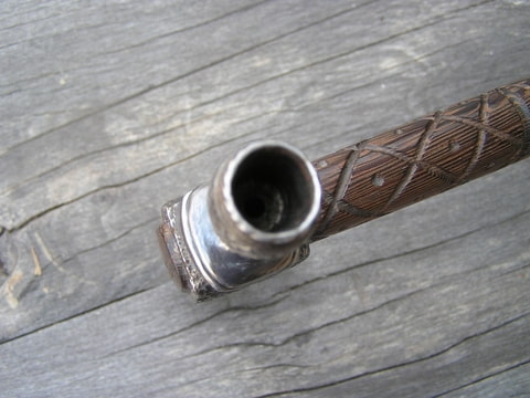

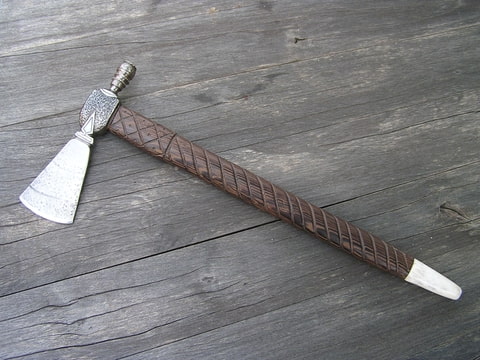

A pipe-hawk forged out of a big peen hammer with a selectively hardening. The pipe is working and I already did a good puff.....

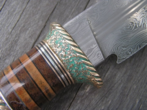

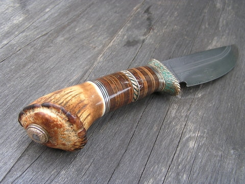

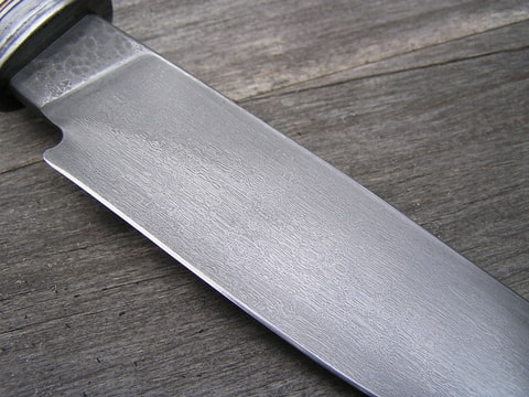

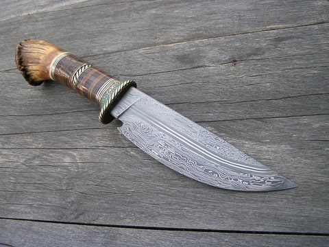

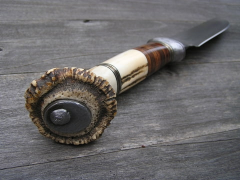

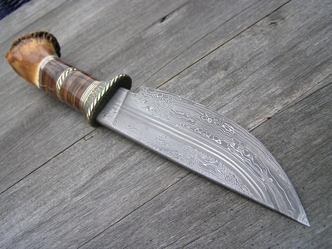

Scagel style knife with a damascus blade out of 75ni8, O2 and 1.2519. Grip is made out of leather, patinated brons, silver and sambar stag.
