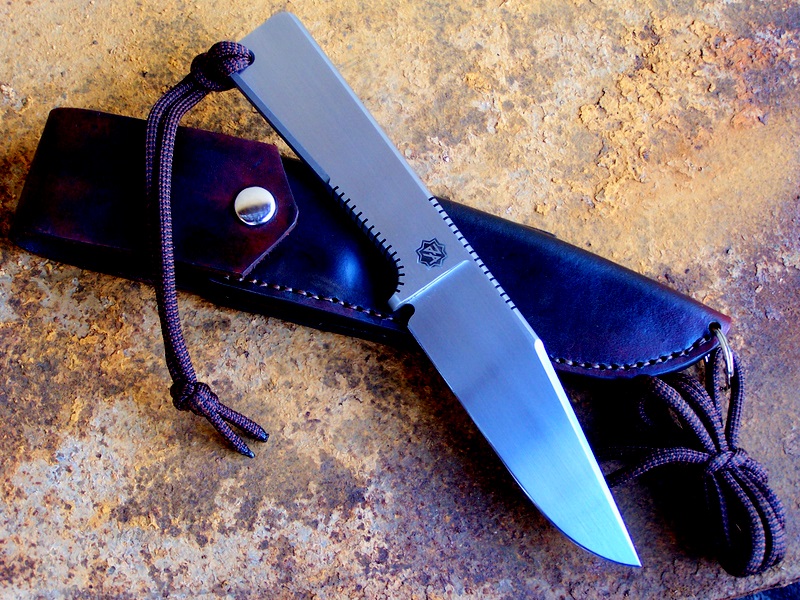

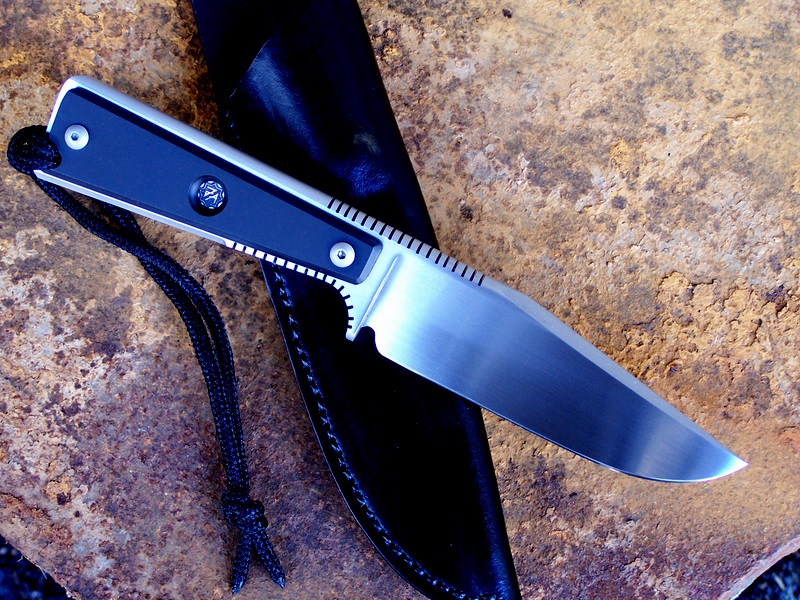

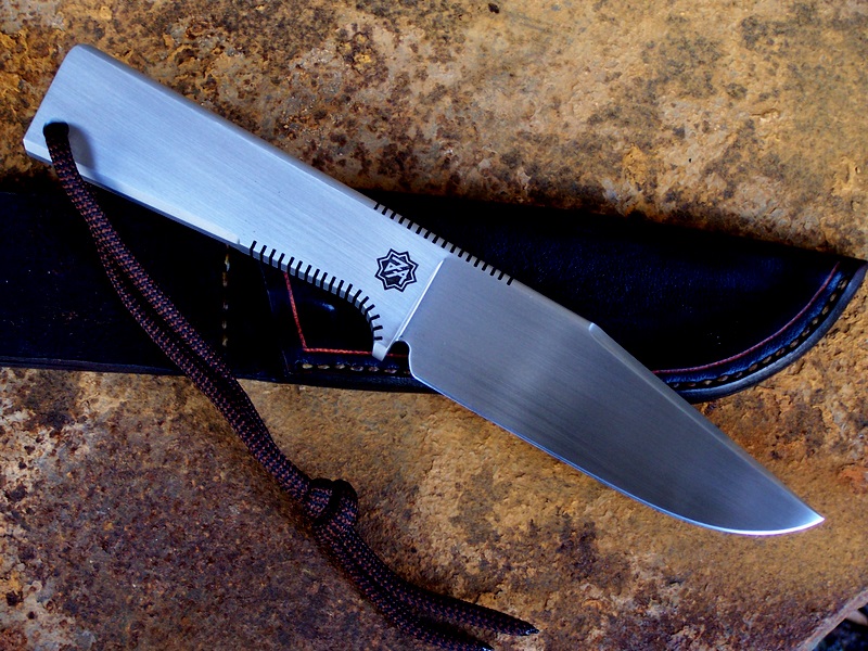

I just completed work on three new Durendal Models. Here are some photos see what you think. http://AcreMetalworks.com
Durendal Rex Light
Durendal with Infinity Sheath
Standard Durendal
The Durendal knife is a stock removal line that I make. They are made of 5160 steel. Blade is 5" with an overall length of 9&7/8 inches 3/8ths" thick. They are not a production knife, I make them by hand.

All three look great, but I love that top one. The handle is really cool. I like the way your maker's mark is visible through a hole in the handle.
Great looking knives and extremely clean work....:thumbup:

NIce work Fuad!!
They all look good ,:thumbup: ...........
........ BUT, I really like the bottom one ......
..................................as it will soon be in my hands:D

The bottom one is the classic. Those are good hands to be in I'm sure!

I just received my Durendal in the mail today.......Fuad, this is one INCREDIBLE piece of steel!!:D
Guys and Gals, this thing is amazing...THREE EIGHTHS THICK 5160 stock, and full flat ground to a razor sharp edge...Perfect symetrical grinds all around, full 3/8" nicely rounded spine from butt of handle to about 1" past the thumb rest file work ,then the swedge starts and gradually tapers down to the tip.
The thumb rest and under handle saw cuts make for a secure grip and will make a very nice all around using blade.
The basic leather sheath I selected makes a nice low profile carry on my belt and is well crafted piece also...
This is just an amazing piece of work for a no frills blade, ..
..... Fuad, If you get a chance, maybe you could post some in the hand pics or a spine shot to show :thumbup:...I have got to learn how to post pics here!
I am very proud to be the owner of this blade:D !.....
............Many Thanks Fuad!!

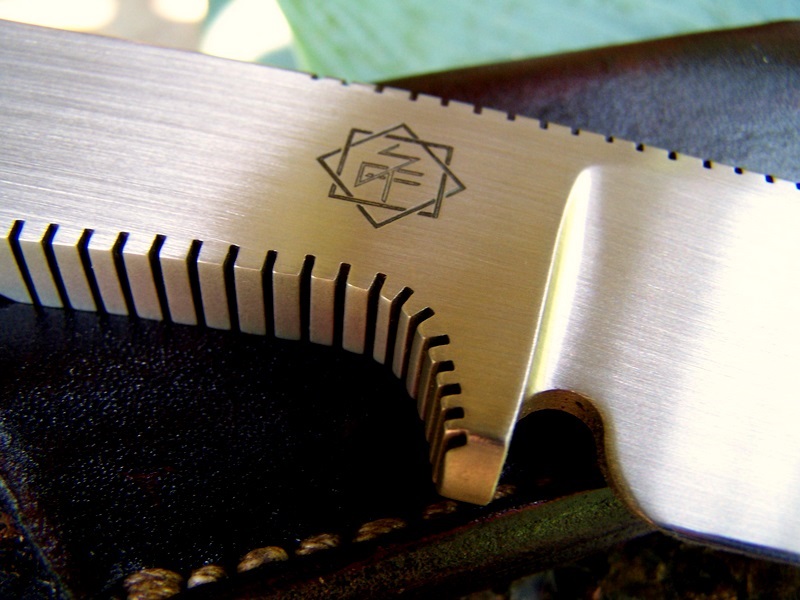

Shot of guard detail

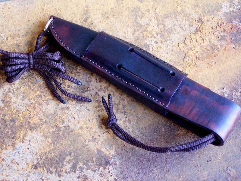

Another angle
Those all look great, but I particularly like the first one. :thumbup:

Thanks Roger,
The version with scales is going to be something that I'll do more of. The interesting thing about the scaled version is that it's actually lighter than the original. The handle has been perforated heavily and eases up the heft quite a bit. I've done all steel versions where the blade will balance at the plunge line but it is a 6" blade instead of a 5"er. I need to make the next one out of Damascus with premo scales.:)
