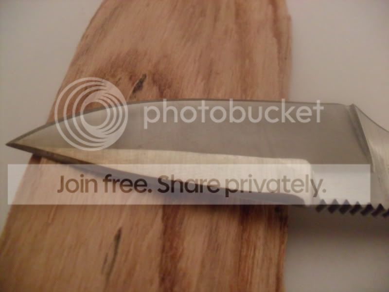

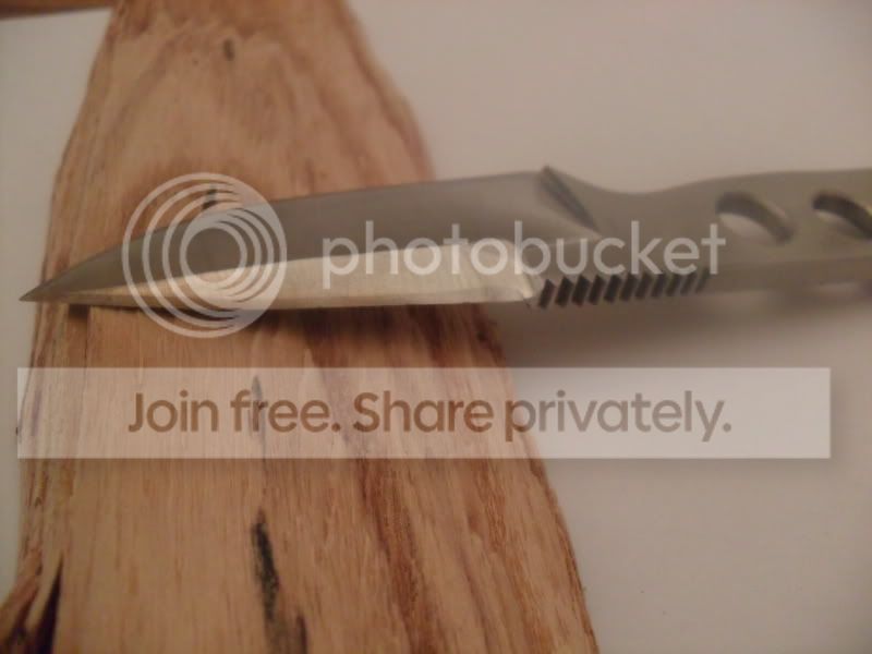

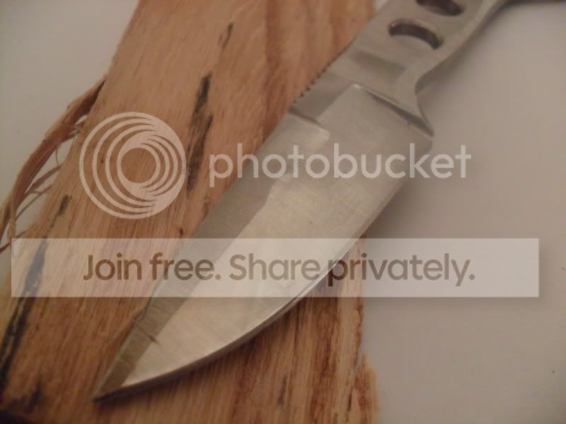

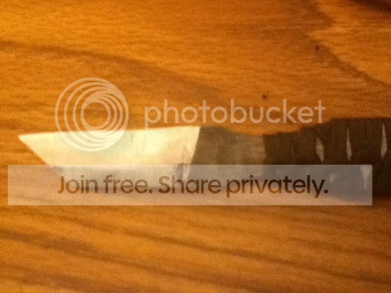

Well ... won't have room int he budget for steel until march...so it's just going to be practice on mild steel with the intent on working on my grinding technique. I did, however, have a knife that I didn't mind grinding on to get the feel for it. This is probably the 2nd or 3rd piece of steel I've taken to the grinder. I added the smaller flat grind to the other side of this skinner to make it a double edged knife.
I need to tweak the tracking on this so I can get the plunge lines uniform/clean on each side. More work on a solid flat...there are some spots I can see where I moved or something ever so slightly.
I would gladly welcome any feedback, bad or good.
ETA: Ground the bevels on an 80 grit HF brand zirconia belt, finished with the belt that came with it (120 grit I think). I also use that for forming the edge...taking it to the stones sometime tonight or tomorrow.
Seems a shame to make such a pretty knife out of mild steel.
That was a stainless skinning knife in what the package said was 440c...It was like 5 bucks, I just modified the other side of it. I was my first full build to be from good steel, so for now I'll just play the waiting game and work on my grinds. My birthday in march should allow me enough for a couple blades worth of steel I would imagine :)

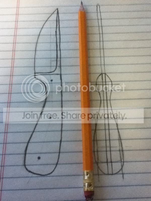

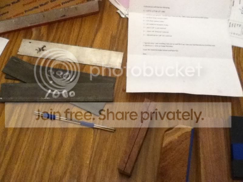

So - here we go!
Stan was super kind and sent me everything I'd need to make a couple blades!

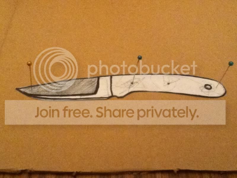

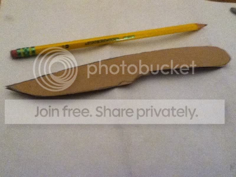

I drew up this pattern...the pattern was reverse edged, but I'll be making it normally. One of my daughters decided she needed to add her flair to the template.
All cut out. Note that I have big hands and had to make the tang a bit longer to accomodate.
I actually was too excited and worked on it for about 6 hours solid and didnt take any pics. I have it profiled, a distal taper ground in and I'm working on making the flats flatter.
