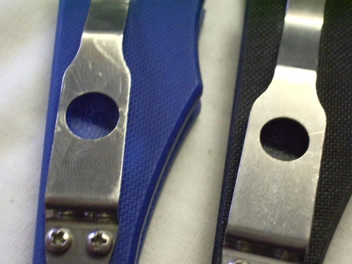

Upon receiving it, I was glad to see it had a nice firm lockup(my older one has developed vertical play. I also noted that the clip has been improved. By this, I mean that the indexing hole has been reduced in diameter and seated directly over the corresponding indexing divot. This was the only complaint I had with the knife.

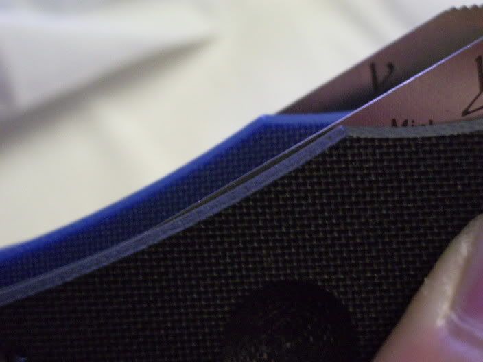

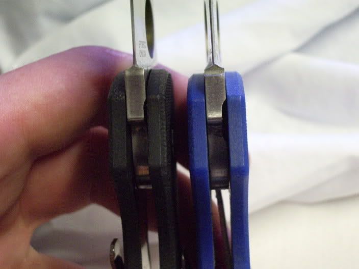

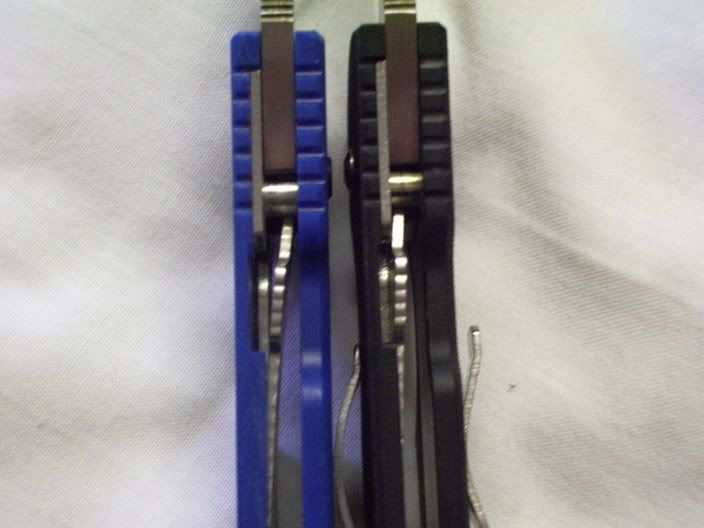

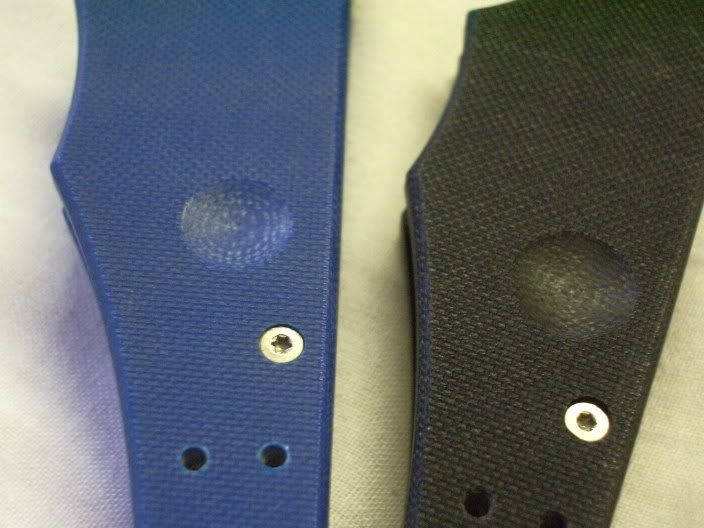

I have some pictures to compare and explain this.
This shows how on the new black one that the blade does not detent closed as much as it should:
Here, you can see the great difference in the tang "divot" that detents the blades closed:
The lockup on the new one is better (it has less wear). The old one is still reliable though despite having slight vertical blade play:
These last two show the variations that I believe are improvements in the design. They also cause me to question the seeminly newer, yet more fallible lock detent:
EOJK, great pictures.
That difference in the milling of the tang, from blue to black, is UNSAT!
Why on earth would that have happened?? I can't imagine what would justify a deliberate change such as that one; and I don't really want to stomach the idea that it's a Q.A. issue/failure... :(

I am a bit late on this one. My Yo had the same problem that it wouldn't stay fully closed. As Micheal Janich once explained the Yo is differently engineered than other compression locks and that seems to have been one of the woes.
You can fix it very easily by bending the tip of the liner out a little bit. This is how Spyderco fixed mine, when I sent it in.
I will try this, sounds like it may help. Anyone know why Spyderco would regress in the design though? I still cannot understand why the detent is shallower on the newer knife.:confused:
