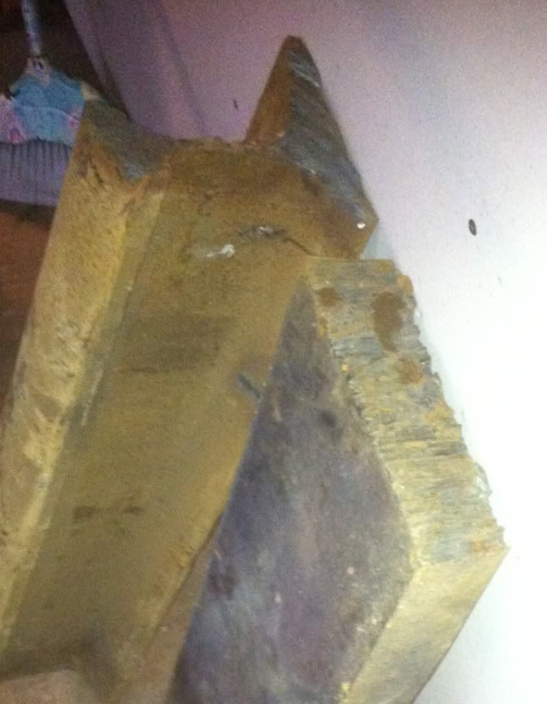

Im totally new to all this, so if this stuff won't work let me know. I have access to more steel than I could ever transport to my shop.
I forgot I have a customer who owns a HUGE scrap steel business, so today I went and grabbed a few things to hopefully make a decent starter anvil. I also found some 5" wide 5/16 thick band saw type blades, grabbed one of those as well, maybe it can be made into a sword or something..

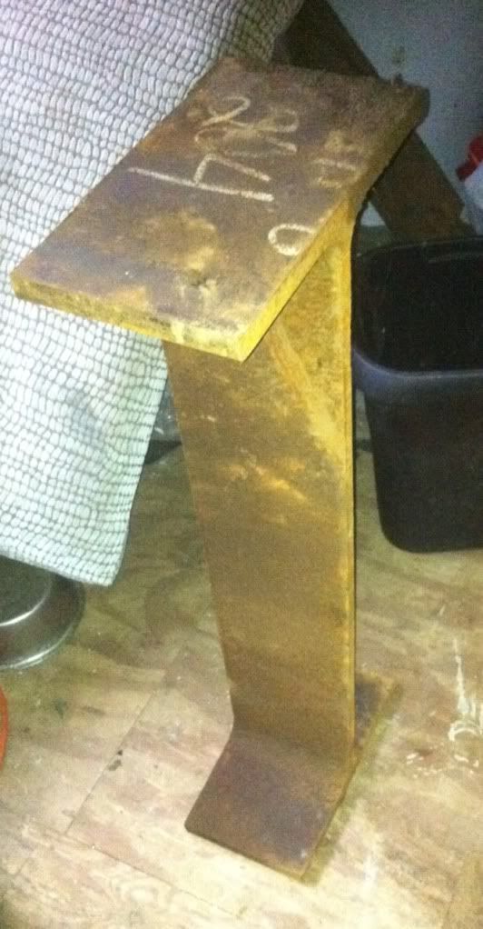

I found this tall piece of I beam, thinking I could make the stand from it, the steel is about 1" thick and its 36" tall roughly with 12" top and bottom
I grabbed a section of railroad track and a big slab of steel 3" thick and 8" wide. VERY heavy and flat. Im thinking thats what i want to use as the hammering surface.
Anything else I can grab that may be better? Suggestions? cautions? I can go back and get basically anything i can carry for free
Thanks in advance..
Brent
Looks like a good score! IMHO the rr track will make the best anvil (I have used one for years) if it isn't work hardened from use,you may find someone who will heat treat it for you.
Stand up that slab on end. Use the 3"x8" surface as your anvil face such that the majority of the mass is below it. Cut, grind, file the face flat. Sink it in a bucket or barrel of reinfored concrete so that the face is at a comfortable work height for you. Google Tim Lively to see what can be done on a mild steel "junk" post type anvil. My 2 ¢ anywho.
Thats one of the options I was looking at. I don't know if this is a indicator of hardness or anything, but that 3 foot 3x8 slab rings like a bell and is VERY high pitched even when you barely clink something on it. The railroad track has a much lower pitch when struck and nowhere near as loud..

Use the 36" piece of I beam to make a post vise stand. It might be a little tall. But workable.

The fact that your 3x8 slab of steel rings loudly may or may not be a good sign. What matters is will it rebound a hammer. Set that thing on end and see if it'll bounce a hammer back at you when struck a fairly light flat blow.

I will try that tomorrow, thank you. Should I place the slab on a concrete floor for this test?

Salem, the slab doesn't bounce near as much as the railroad track does.

That's what I'd expect. But, you could make an anvil out of both and try both, see what you prefer over time. Rebound really helps not wear your arm out. And, your hammer blows will have more effect.

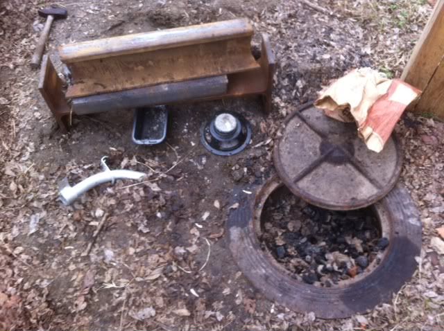

Heres how I set it up temporarily next to my fire pit. Im usually on my knees anyway when heating something up. I will make a more permanent fixture at normal height once I get a proper forge. Should work to play around, its very solid feeling.

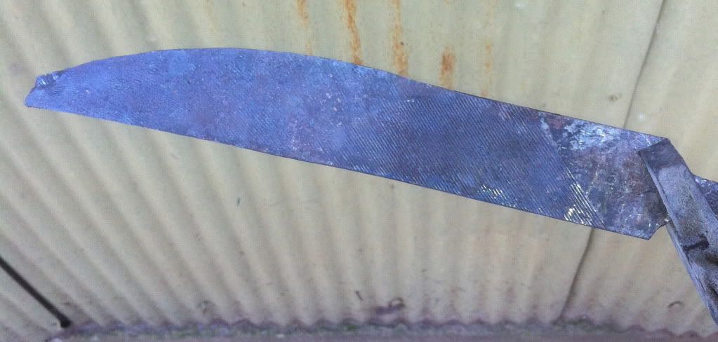

Heres my first time using a hammer, i had some old file cutoffs laying around. I ran out of coal but was getting the hang of thinning, upsetting, flattening and beveling. I have feeling the belt grinder is gonna get a little less use..
I noticed that near the tip i had a peice about to come off due to a crack that ran along the file grooves.
