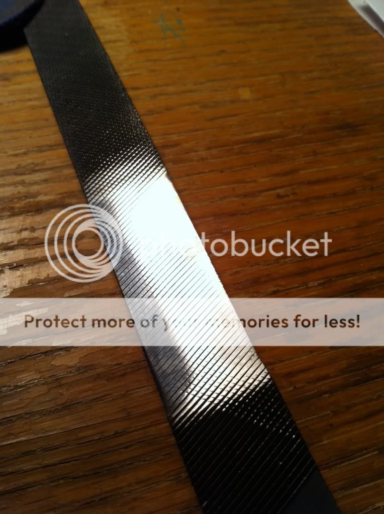

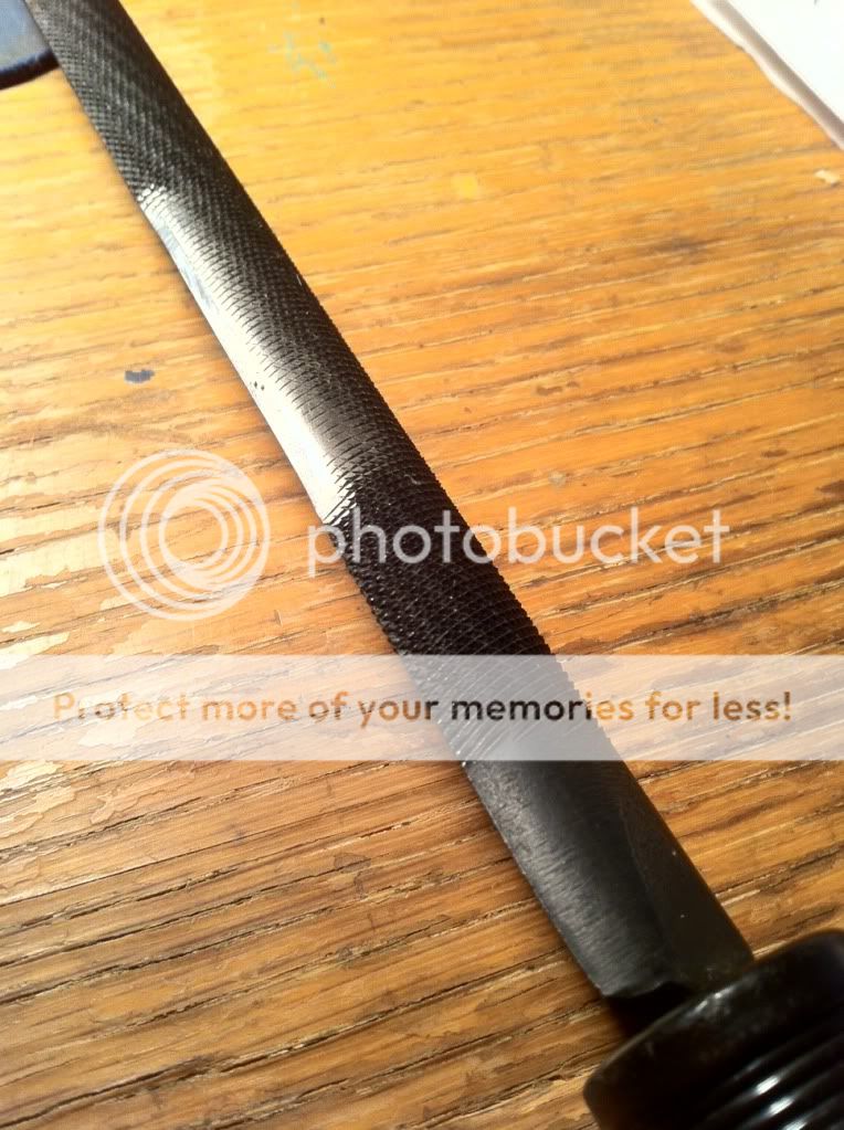

After seeing the sen mentioned a lot when reading about Japanese blades, I decided to make a sen-like blade out of a worn out half round file. Basically i ground off the file teeth on the flat area and part of the round to make a extreme angled sharp bevel. Make sure you cool it frequently or it won't hold its edge.
WOW! This thing spits hot ribbons and chips once you get the hang of it. Sometimes I see smoke coming off the edge, just crazy.
As with draw filing you have be careful of downward pressure or you will create a divot. After it "digs" in it will really start to cut. Watch out for chatter or you will end up with serrations instead of a nice flat surface. It takes a little while to get it, so grab a piece of scrap and practice. I did the mune of a W2 tanto really quick compared to filing alone. You will still need to file and sand, but this thing will remove metal FAST. I start out with short pulls to get started, then long light pressure pulls to keep it all even. Once the sen wears in a little it also seems to cut better, maybe its just I'm getting better at it.
If you have an old file and a few minutes, whip one up!

This is just a makeshift one..A real one would be hollow ground on the flat and each side would have a cutting edge for push/pull action. That way its riding on a 1 or 2 degree bevel even when pressed flat. I don't have a way to hollow grind so I just did mine like a spokeshave or drawknife. If i find the drawings ill post them..

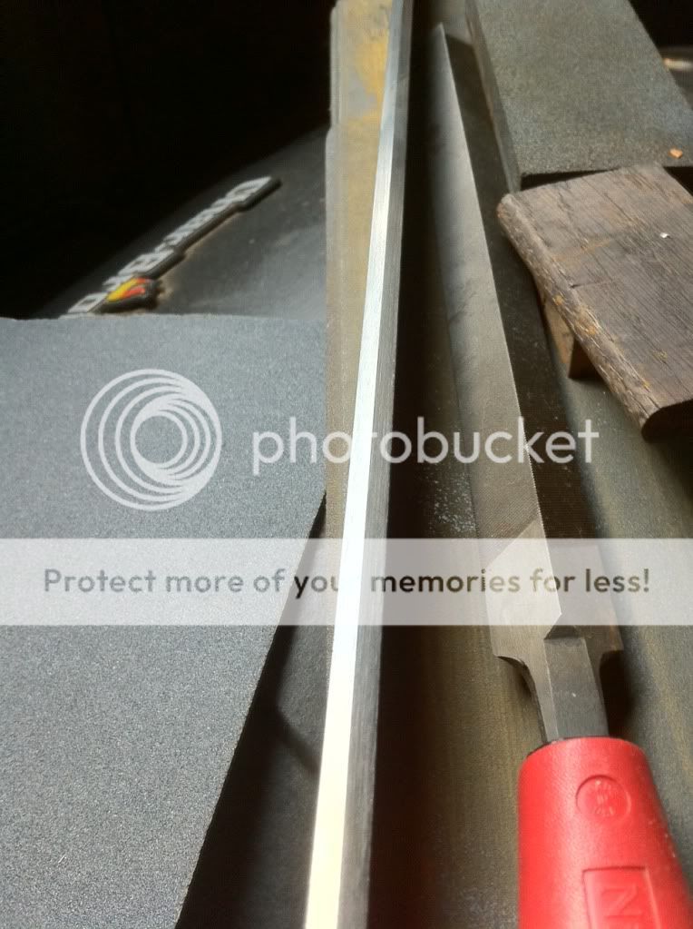

Results, with some sanding and a few pulls of the file..BTW that triangle file is my favorite for draw filing, very stiff and using the odd angled sides can move metal quick too
