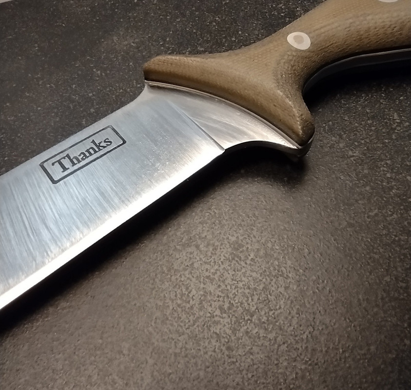

Yes, .062" thick steel is thick enough for blades.
you will need to use them with finesse, that's not prybar thickness.
Make sure your saw blades are NOT bimetal.
They have to be HSS High Speed steel. It's usually M2 at Very Hard ratings.
I use American made power hacksaw blades from Starrett.
You will Not be able to weld them together for a knife.
If you want thicker, buy a thicker blade.
Very Nice blades can be made from them, but because how Hard the steel is it's very slow to grind. I use ceramic belts
This particular knife was made with a tall,
thick (.125") fairly expensive, new hacksaw blade.
Id say about 10% of my knives are made this way.
I like them alot.
