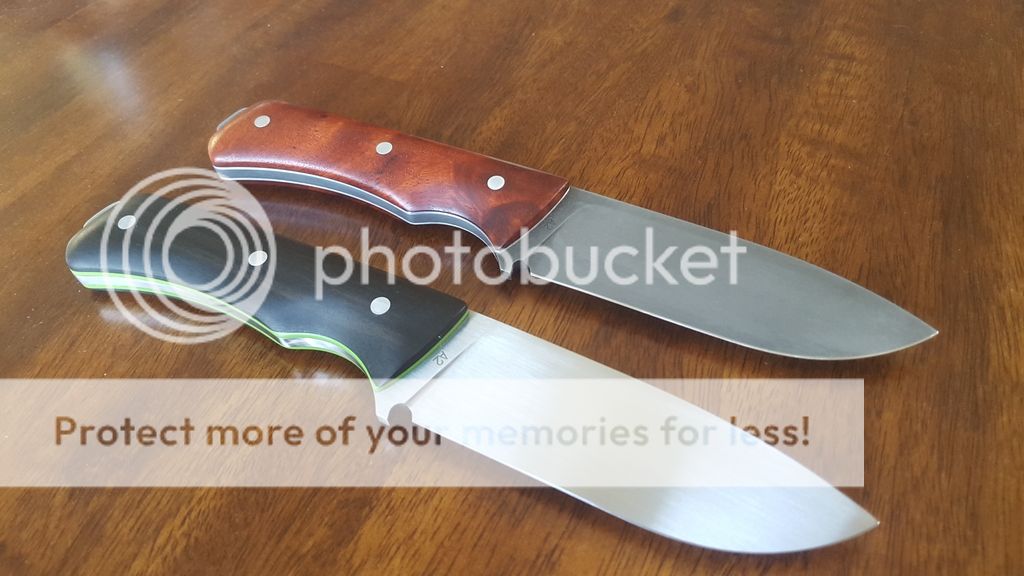

Well I'm almost done my knives but I decided to go on the recommendation of using tru oil to finish my unfinished exotics. I used this tutorial:
http://www.shotgunworld.com/bbs/viewtopic.php?f=12&t=246076
I think I screwed it up however as I did not wait till it was 100% dry per coat. I did probably 10 coats with this procedure and for the most part it looks pretty good. I let it dry over night and it was still a little tacky, and this evening it is still slightly tacky ( but not horribly by any means ). From what I have read in regards to tung oil is that it will never cure. Is this the same for tru oil as well? Once again it is not very tacky at all but definitely noticeable. I am also running a bit out of time, I fly out on Saturday and plan on giving the knives to my friends on the following Friday, so If I left them be they would have a little over a week to finish curing. I could wait till thursday before doing something, but if everyone says that there is no way it is going to cure I might as well fix them sooner rather then later. If I do need to remove the coating what is the best way to do it? laquare thinner, or acetone? I am happy with the way they look I just am curious as to whether they will cure or not. Thanks again for all the help! You guys are awesome!

Thanks for all the great information! Thank you for sharing the video Alexander, I like the Vaseline trick and will definitely use it the next time I finish a knife. The handles are still very slightly tacky but I think they are improving, and I will get some lemon oil if it remains tacky by tomorrow morning. I wish I had more time, or I would sand them lightly down and continue doing coats with the information I received here. I do however have 4 more knives to do when I get back and I look forward to being able to utilize these new techniques then. Thanks again everyone!

what kind of finish is on the upper blade?
Hey Daniel, all that is is a patina from putting the blade in apple vinegar. I just cleaned the blade well then put it in apple vinegar I heated up for about 10 minuets, I found the patina was not very even but with just automotive polish could be evened out quite well. I did it about 5 times like that, and its about as dark as I could get it to go. I would not recommend doing it for more then 10 minuets at a time so that you have a chance to even the coverage, though I have watched videos of other people who did not have the problems I was having. I also did this before putting on the handle as I did not want the aluminum liner to oxidize. I do not know how the apple vinegar would effect wood, but I would guess if the wood is properly sealed wouldn't do anything to it. This is the video that I loosely followed.

The 2 tones on Daniel's blades are from differentially heat treated blade... hardened edge responds differently to the etch than the softer spine.

Thanks Stezann, I have seem some knives around with the nice two tone look and always wondered how they managed to do it.
