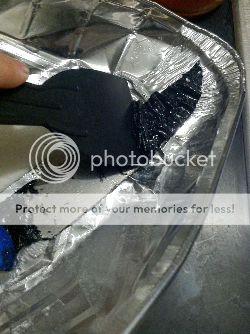

New to this forum,seeing a lot of great info,I'm getting ready to pull the trigger on a BK7 for Camping ,Hiking and what not.Question is what tool do you guys use for adding a choil to the blade ? I'm also planning on stripping the finish and adding a forced patina.Any info would be great.Thanks in advance.

I did this using a Dremel sanding drum.
Go slow and just be sure to keep the steel cool so you don't destroy the heat treat.

Would use a dremel/grinder/file for choil. Haven't modded a BK yet except for stripping. Cannot recommend "citristrip" enough. An $8 bottle will last you a lifetime more than likely if just using for knives, takes off paint with ease, fast, safe.

I use Jasco only because, at the time, I decided to try it first and it's lasted forever...
Great choice on the 7, I was going to strip and deramp mine but I realized after using it... a lot... I didn't need to change it. Only thing I did was smooth the coating with I think 320 grit pad then 0000 steel wool...
