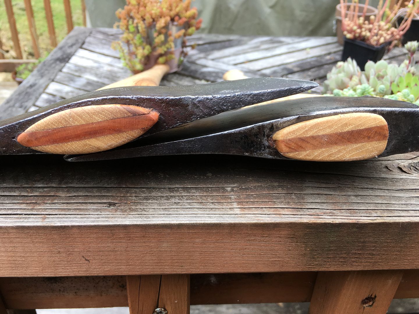

As in my recent project isn't bad... butttttt it could be a lot better. So if you picked it up and looked it over when you seen X you would say this could be better.
And no those are not lumps on the side of my handle that is my phone trying to take a better picture lol.

Are you asking if you've hung this tool well enough that we'd buy it ?
Most of us like to de-rust and hang a tool head ourselves, we're like the hunt and experience so we don't normally buy work others have done unless we just appreciate say their perfectly hand carved haft.
Can you get good resolution photos of:
1. The top of the eye,
2. The shoulders where they go in to the eye,
3. Along the length of the handle to the head?

Lol those would be the problem areas!!! :) (hense the reason for my question)
Nope i plan on using that tool there sir.
Ok, I was just asking because you asked about what we look for when buying then showed us your work.
Btw this seems to be a decent fit, the eye is just flared a bit at the top and bottom edges right ?
It really doesn't look like there are any real gaps.
I could have fit the cheeks better but yes there is a flair at the top and bottom.
If this is your first handle you're well on your way. Clean up a few of the little details mentioned above and the next one will be perfection. You just want to let the head tell you where to remove wood. Seat it, remove material, seat again.
One thing I'd add is that I personally like to leave a little more meat at the bottom just to make the flare stronger. Right now where the handle flares is pretty vulnerable.

A couple of initial things I look at are whether there is enough material in the eye to start with and if the wedge spans the whole length length of the kerf without a gap.
I’ve taken to using wedges with grain running opposite the handle’s but that is just a detail.
