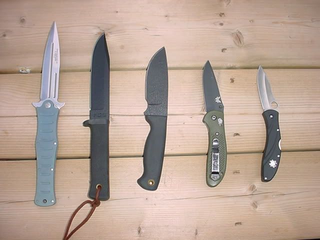

Garage Boy, you dont have too many. I am sixteen as well, and here is my collection:
