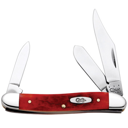

$69 seems very high for a Case stockman, unless it was some special edition or exotic handle material. A Case Medium Stockman in CV steel and jigged bone handles, like the one below, costs about $45 at a reputable online dealer.
