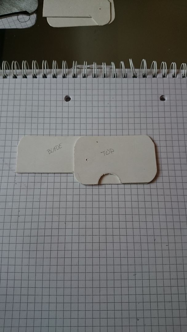

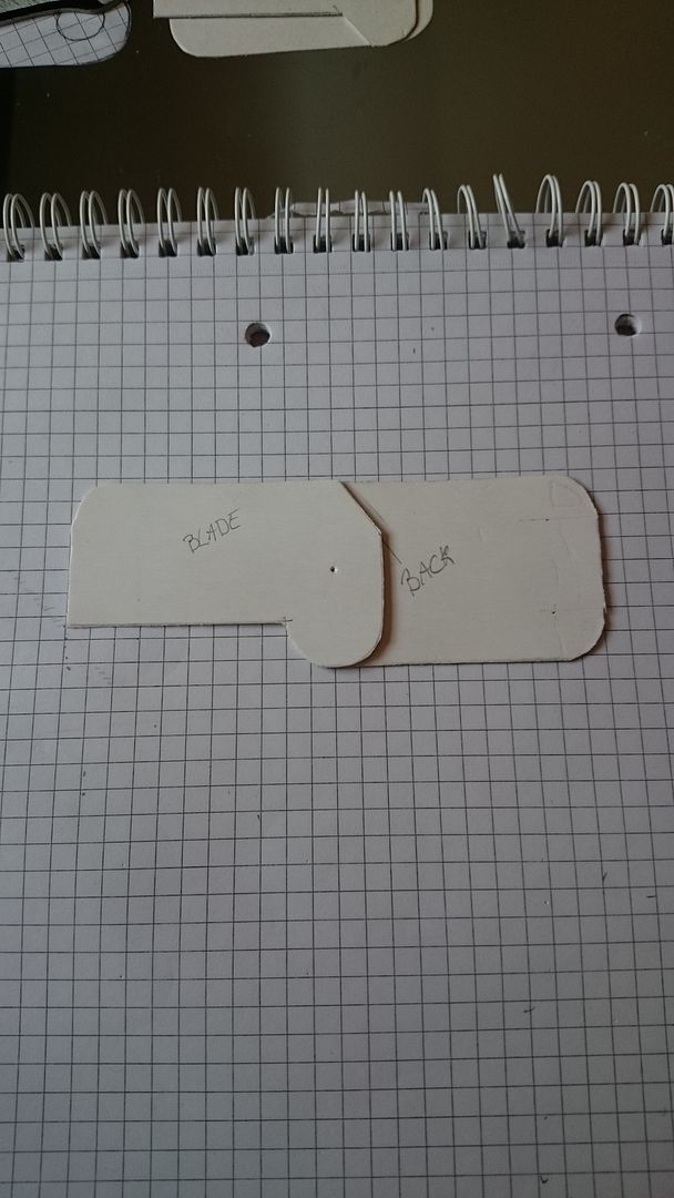

Well a steep learning curve is as good as any other right? :p
So since my computers are on the verge of crashing any moment i had to go old school and use cardboard :) But I kinda like that I can see and feel how the design is.
My design this far consists of three parts: Back plate, the blade and a top plate.
Which locking mechanism will be easiest for me as a newbie to use for this?
I've consisdered not using one at all. Just letting the blade stop against some steel where you can see the 45 degree angle.
Thoughts?
- Lasse

The first step in drawing the layout of a folder ( of any type) is to use a compass and draw a circle around the pivot on the liner (draw everything on paper or with a drawing program). The circle will represent the path of the blade end. All other parts of the knife can not enter this circle....or the blade will not rotate. No part of the end of the blade can be outside the circle while rotating. The circle determines where stop pins, locks, etc. will all sit.
As drawn, your blade will not rotate because that large round heel will be outside the circle, and would hit the back spring/spine.
Look at some drawings of how a friction folder or a slip joint folder are laid out to see what needs to change.

I will research some more and revise my design to see if I can find a good way to do this.
Thanks for your advice!
It saves me tons of headscratching and keeps motivation up :)
