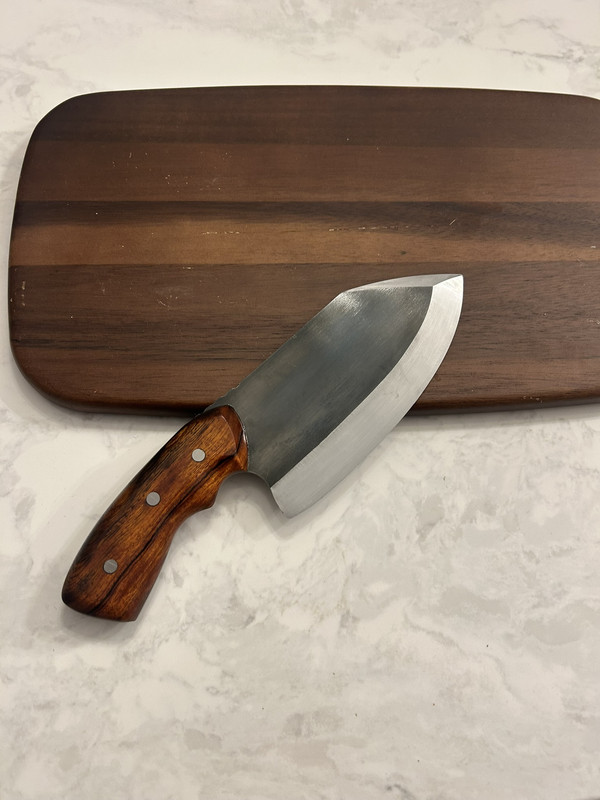

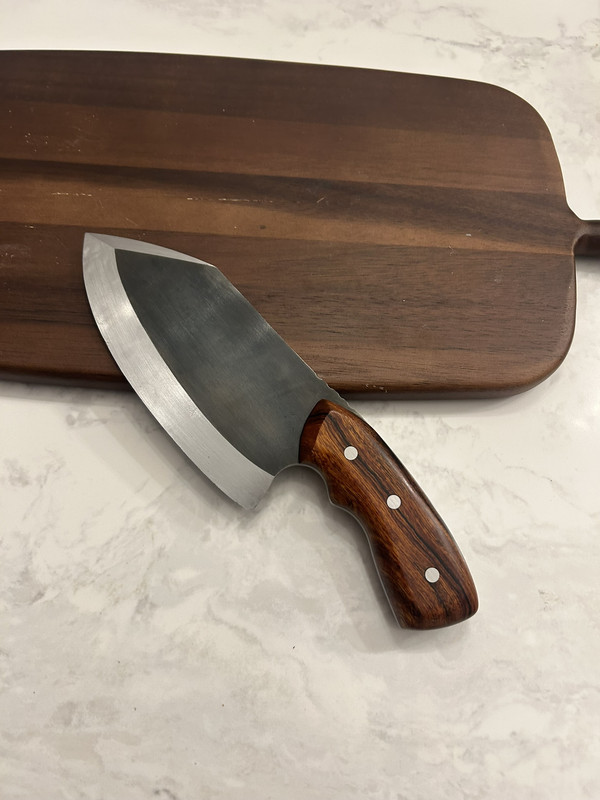

Here is the one I "finished" this weekend. I still need to put the sharpened edge on and etch my makers mark in but I was pretty happy with how it came out.
G10 pins will burn. Micarta pins will not. Get black micarta and your problem goes away. Micarta pins also sand flush and never leave a bump the way metal pins tend to.
