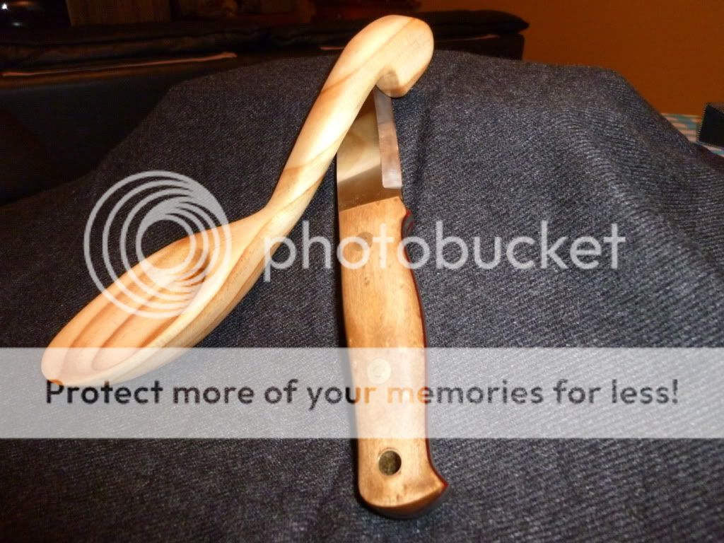

Hi All,
just finished this ladle, started with a 4 by 4" chunk of wood and worked down. In hindsight I should have started with my hatchet, a LOT of carving and sharpening went into this one!

I coal burned the bowl and then used my crook knife to carve out the chunks. I learned that if I let the burning go on too long, cracks began to appear. So I'd burn a little bit, carve it out and repeat.

I started working on it about a month ago, but cast it aside as it was such a big job! I picked it up again a week ago and have been doing a little on it every day, maybe 10hrs total? As I said before, I should have used my saw and hatchet more than my knife. I'm used to my spoons only taking an hr at most.

T.Erdelyi, after sanding, I just put a few coats of olive oil on it. It takes a few because the wood seems to suck the oil up quickly. I've been using my spoons in the kitchen for cooking with no previous treatment and they seem to be doing fine, apart from looking very well used. Almost a patina developing!

I agree nice grain in that wood. What is it btw?

The wood is pine and the knife is a SWC bushcrafter, basically the same as a Woodlore.
I've added a micro bevel to it and it copes with harder woods (harder than pine) much better. Not quite on par with my F1, but a lot easier on the eye!

......I've added a micro bevel to it and it copes with harder woods (harder than pine) much better.....
You have raised a point that doesn't seem to get the attention it deserves.
A lot of people here talk about how good scandi grinds are at working with wood, but my experience has been that they don't cope well with seasoned hardwood without a secondary V bevel or a small convex bevell right at the edge.
Not suprising really, when one considers that Scandi's originated in areas where softwoods dominate :D

Mick, I'd be using a convex all the time, but I feel that the scandis have more control, thus the compromise of a micro beveled scandi. That's just for the finer carving stuff. For everything else I think convex is the way to go.
